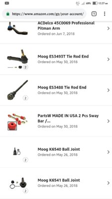

I think my control arms are steel. I put a picture of them on amazon on this post. K6540 is the moog part number that gave me all the trouble. It is the top control arm ball joint. The most unsettling thing is the dust boot slips off very very easily. Makes me reluctant to do the bottom one now. I have K6541 on yand for the bottom one.
Were those the same part numbers you have?
Have you had any issues now that they are installed?

They are the same part number as mine which is weird. I didn't have a problem with the boot either. K6540 is the upper one and k6541 is the lower one, Lower is always bigger.
I'm genuinely curious if they are having quality control problems regarding their diameters, Wouldn't be surprised. I was able to put mine in place by hand, tap it and it would hold in place. I didn't even have to use a breaker bar that was for the lowers buttery smooth. Actually the upper one was tighter to get through, and it did fight me but i got it through it wanted to go crooked but I managed to correct it and I did use an extension for it.
