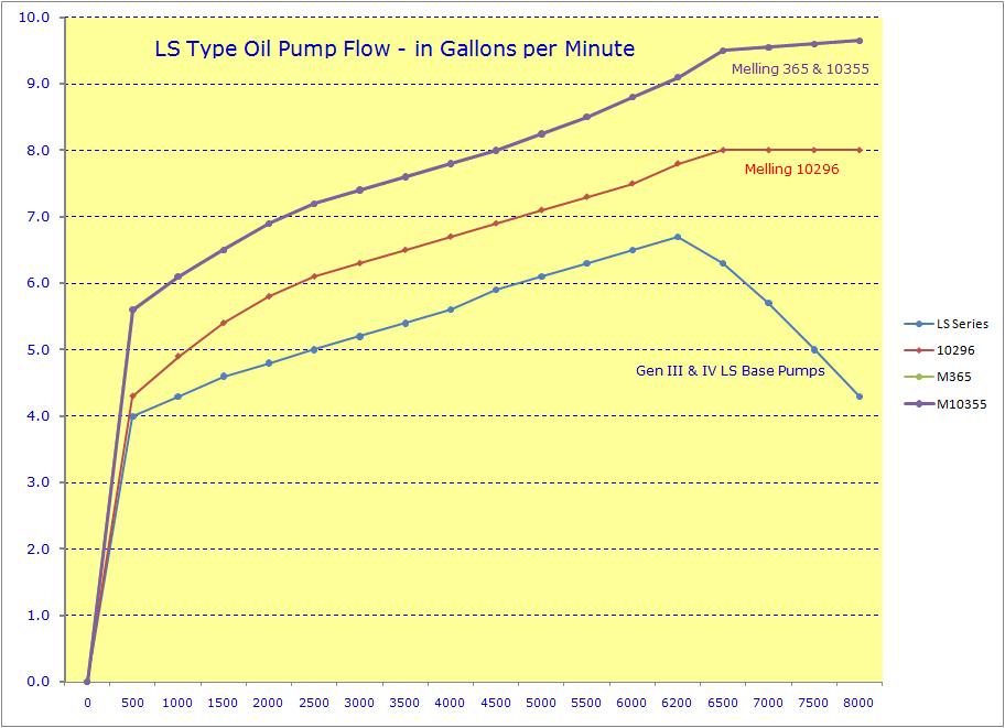

@67RS427 did you change your oil pump?
Most certainly... There are a few versions and some are better than others. I opened my new one up and cleaned up any casting flash left over from production. I know I used a high volume but not the high pressure pump. It can get a bit confusing but you don't need the high pressure spring if you get a high volume pump. I'll find the part # I used and post when I can.

Was talking to gm guy and that what he said too, most guys deleteing dod change the pump from non dod

Well its the volume vs pressure question From what I am hearing 5.3 with dod the pump has enough volume for my SC, researching different years before dod and after, will wait for your finding.

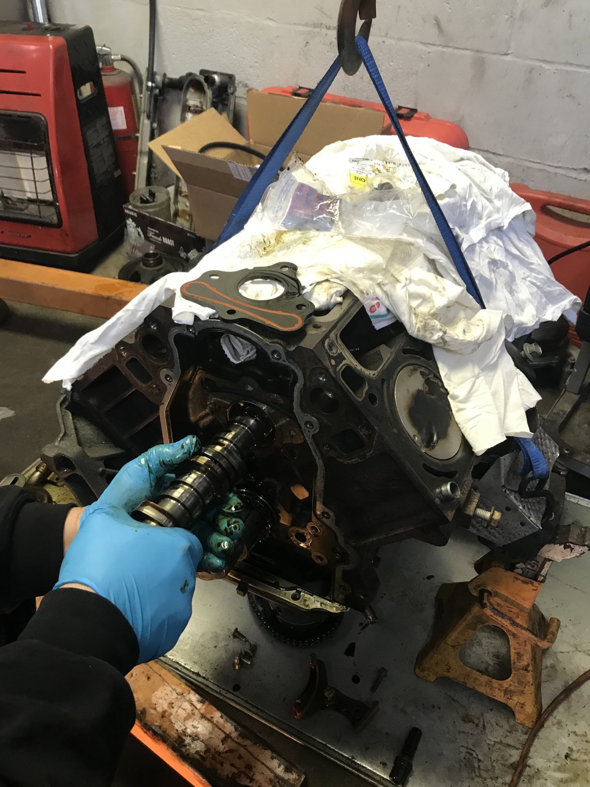

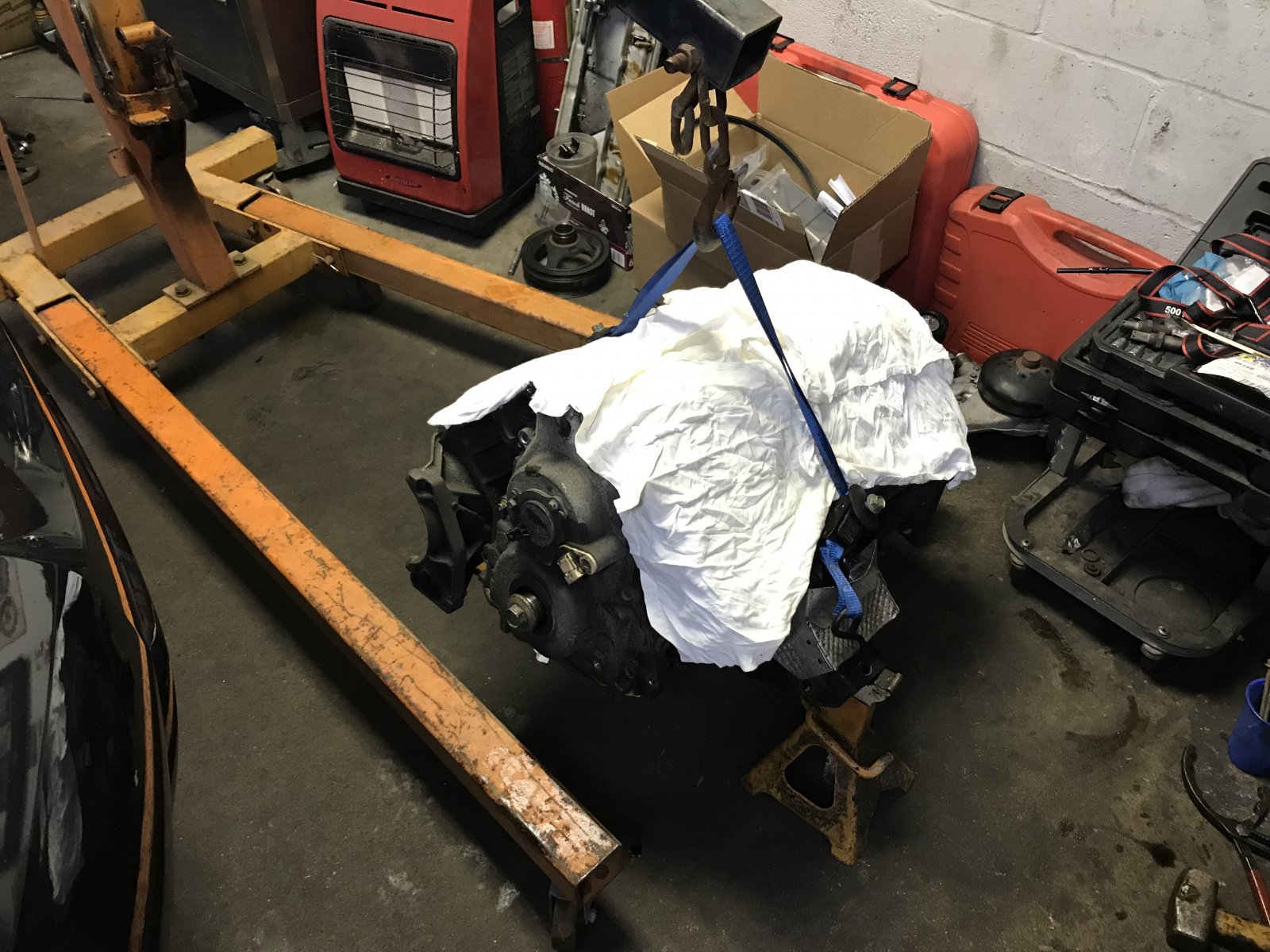

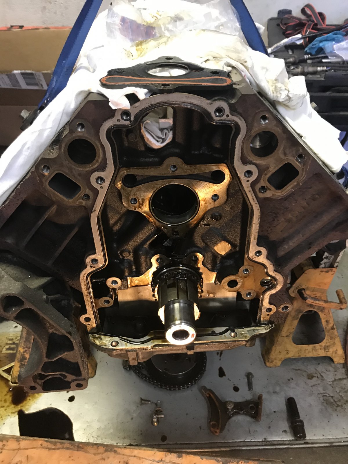

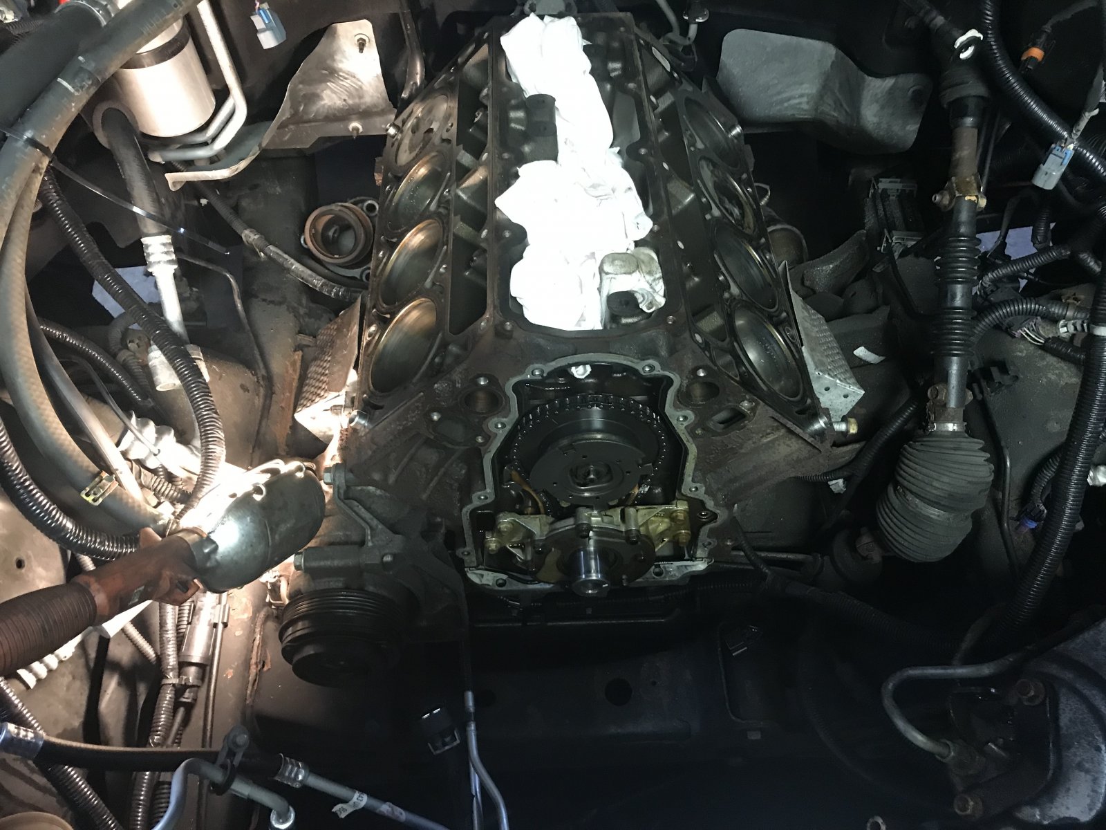

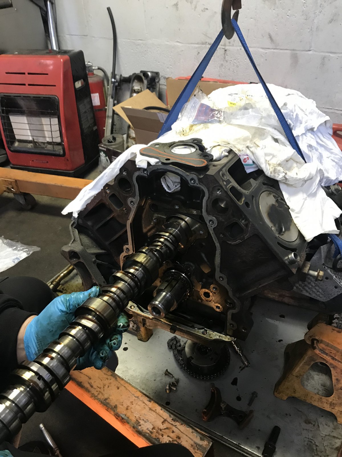

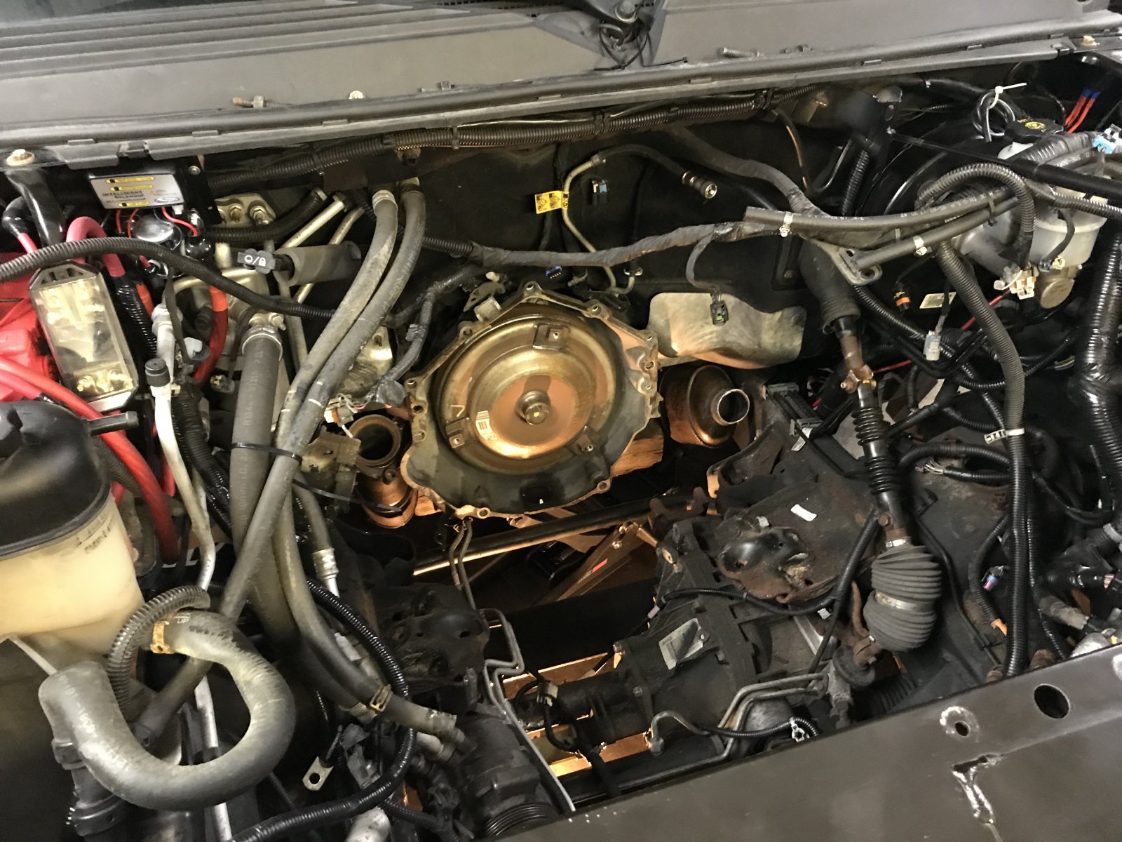

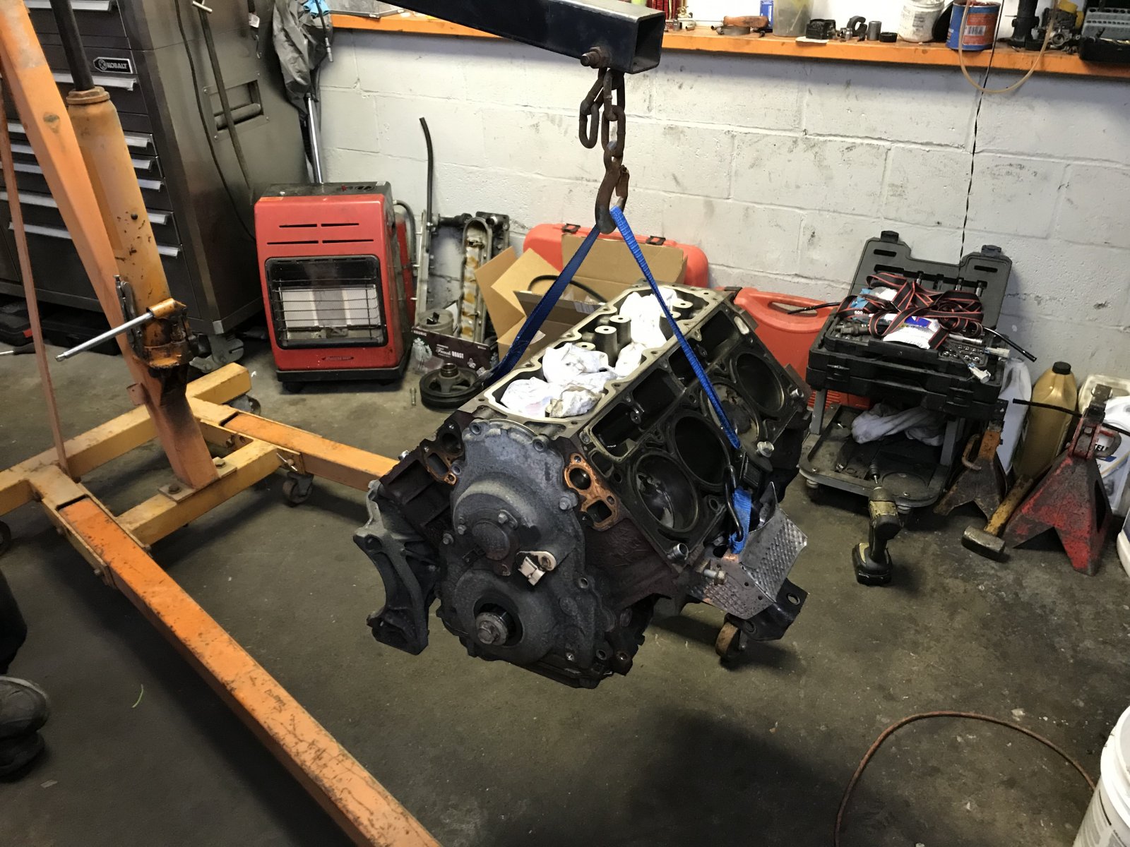

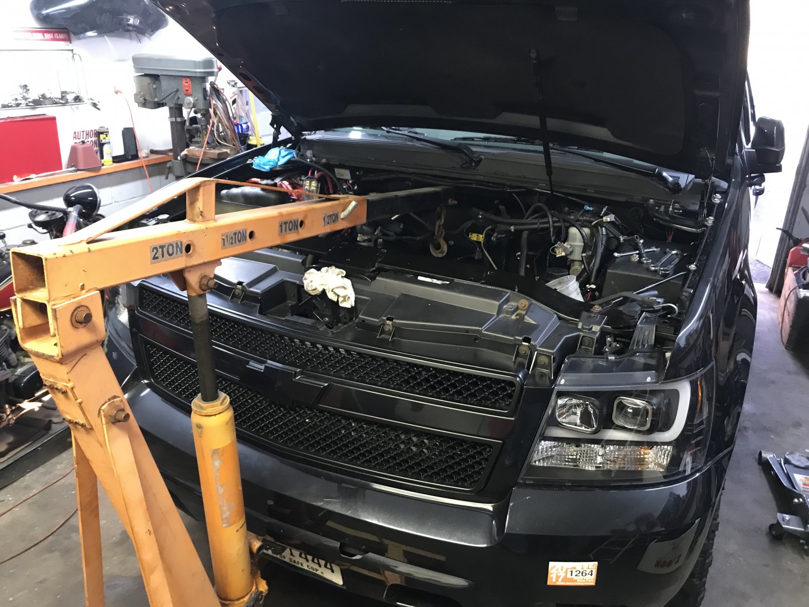

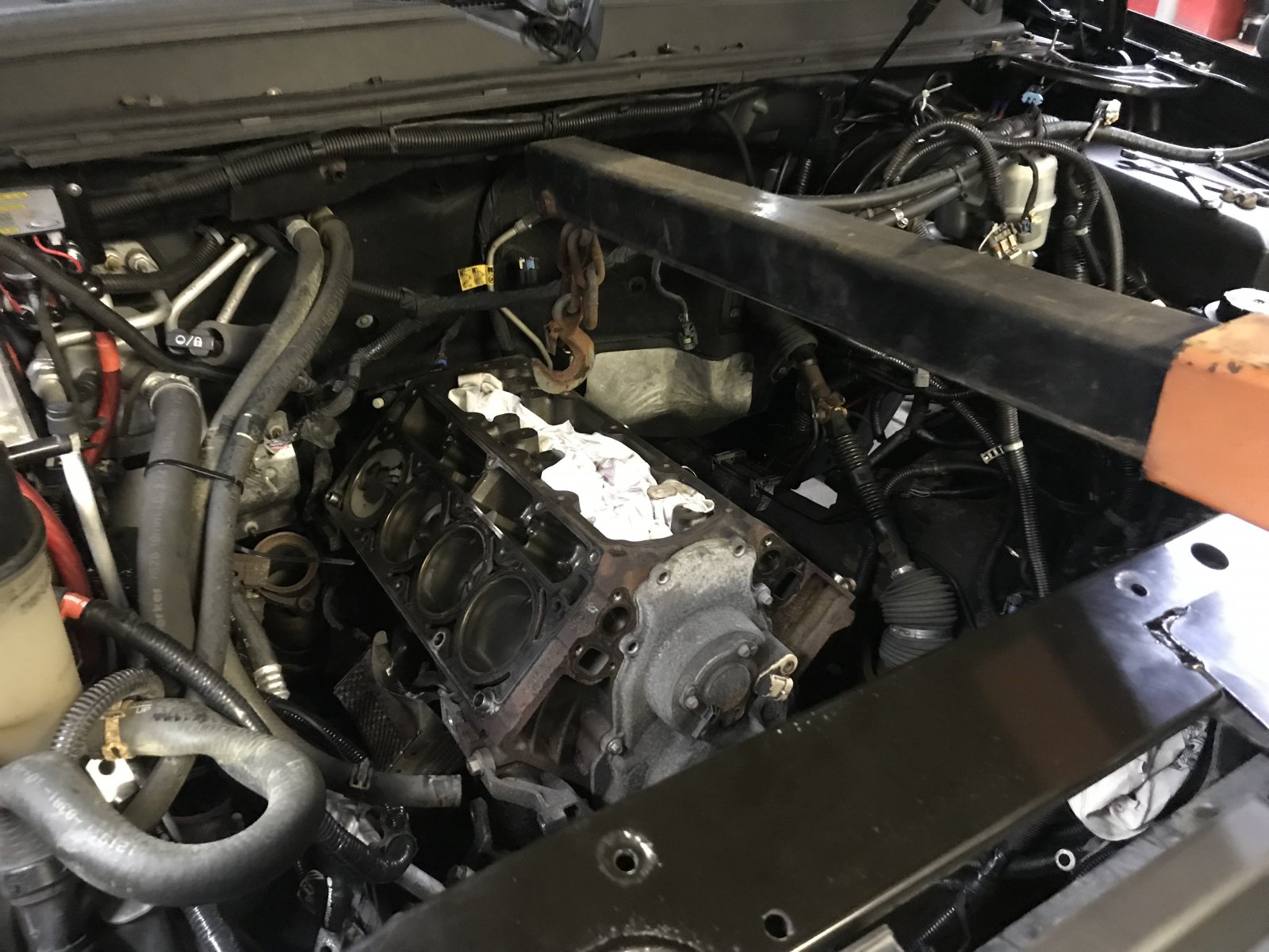

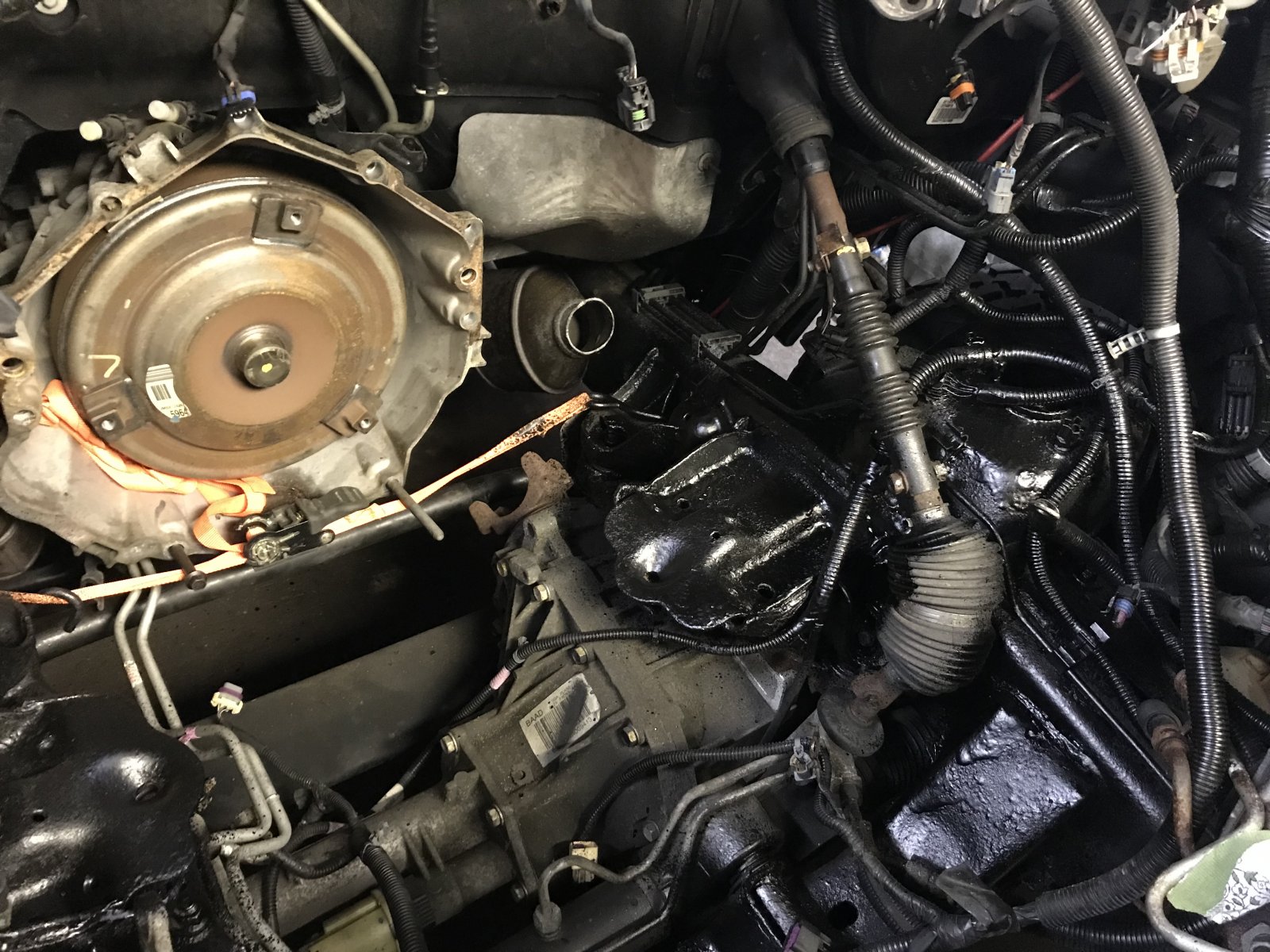

not much to show but most has been done under, for the engine pull.

The DOD pumps are actually "high volume/pressure"... I would however still replace it regardless with a good Melling pump. Well worth the $120 and if yours has 60k miles on it, should replace it anyways. If you spin it over 6k at all, it will help.

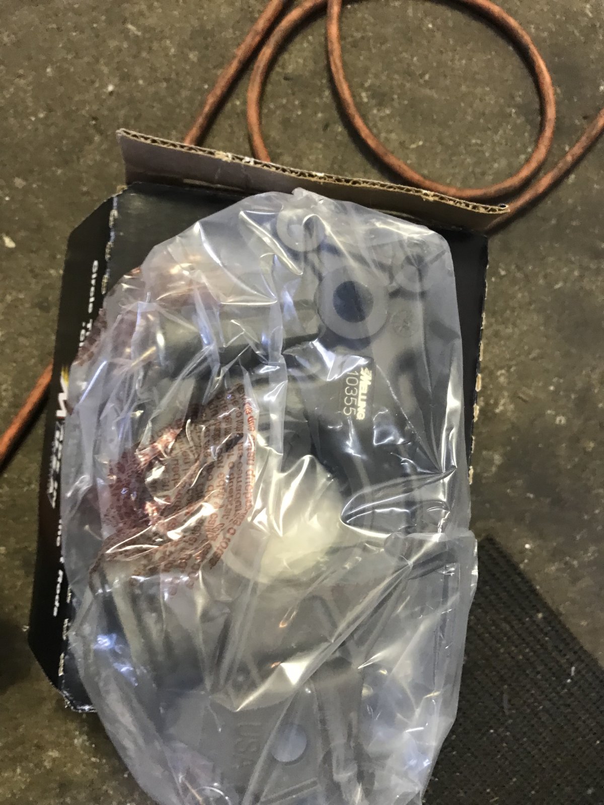

Do you have a part number would like to order asap don’t want to wast any more time
Edit
https://www.jegs.com/i/Melling/689/...MIurjChe-H4QIVi6GzCh01vQPxEAQYASABEgL4-fD_BwE
https://www.summitracing.com/parts/...MI4Oq-wfGH4QIVSoGzCh1cfgR-EAQYAiABEgK7L_D_BwE
Chrismnj
Chrismnj
Sep 17, 2015
1,227
2,121
NJ
@67RS427 ordered both, will see what my gm guy says one is standart volume high pressure and the other high volume high preassure, personally don’t think the second one will hurt maybe bad for gaskets?

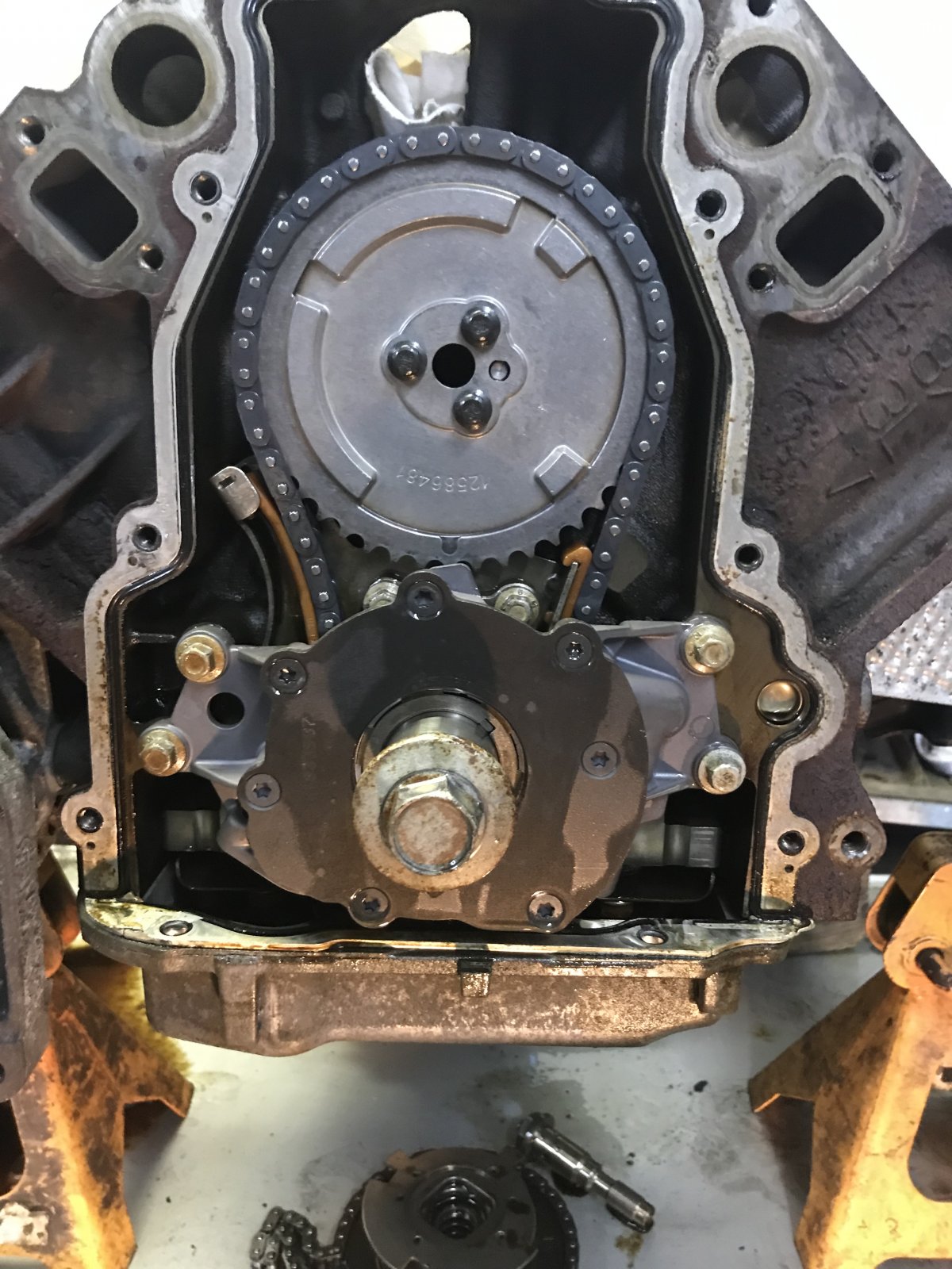

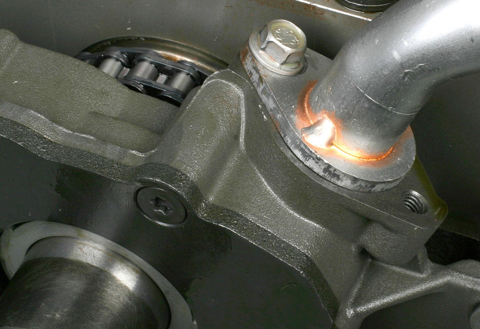

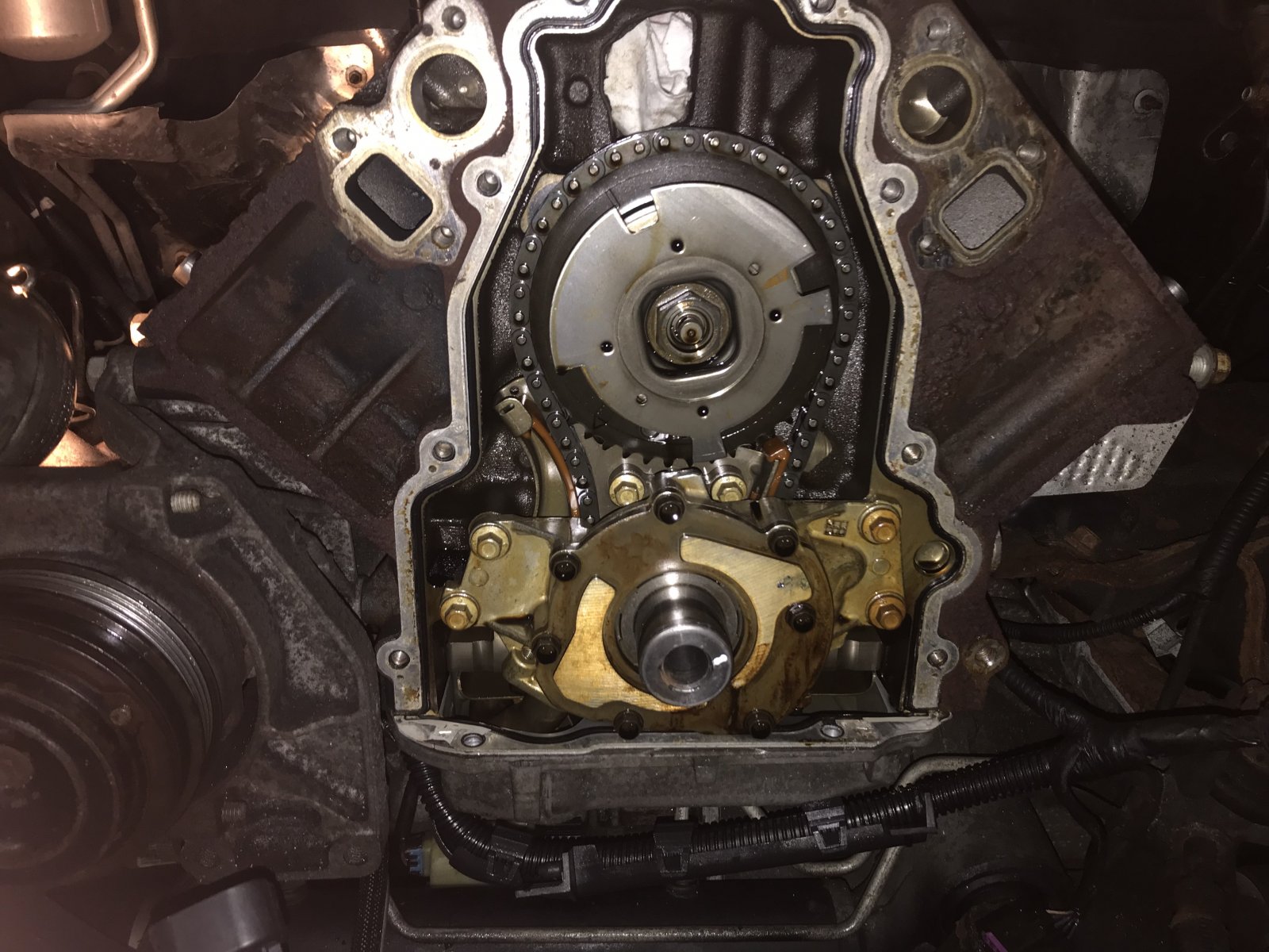

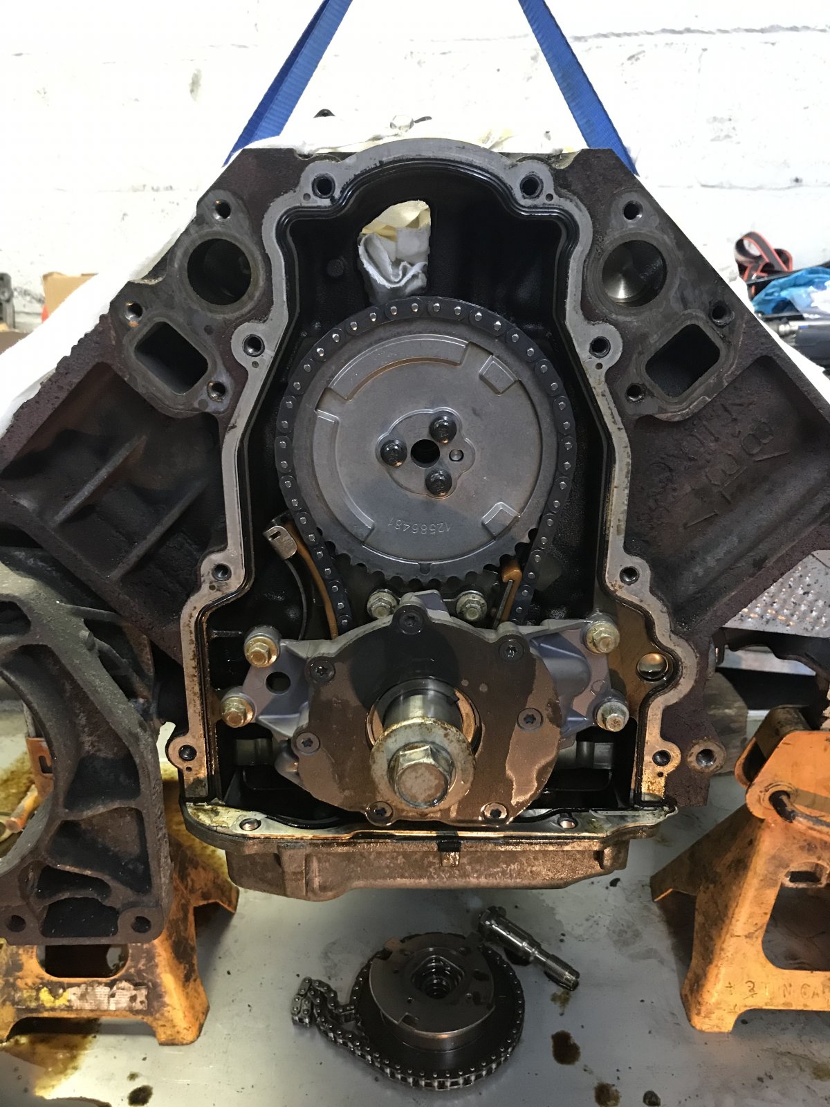

my mechanic said there is a missing bolt at the bottom of oil pump, wasn't there today will get some more info tomorrow, but missing bolt WTF GM?
01FormulaTA
Mar 23, 2017
536
567
Thats odd, are you sure he isn't talking about where the pickup tube bolts to the Oil Pump? There's an empty bolt hole on the bottom of the oil pump that isn't used...

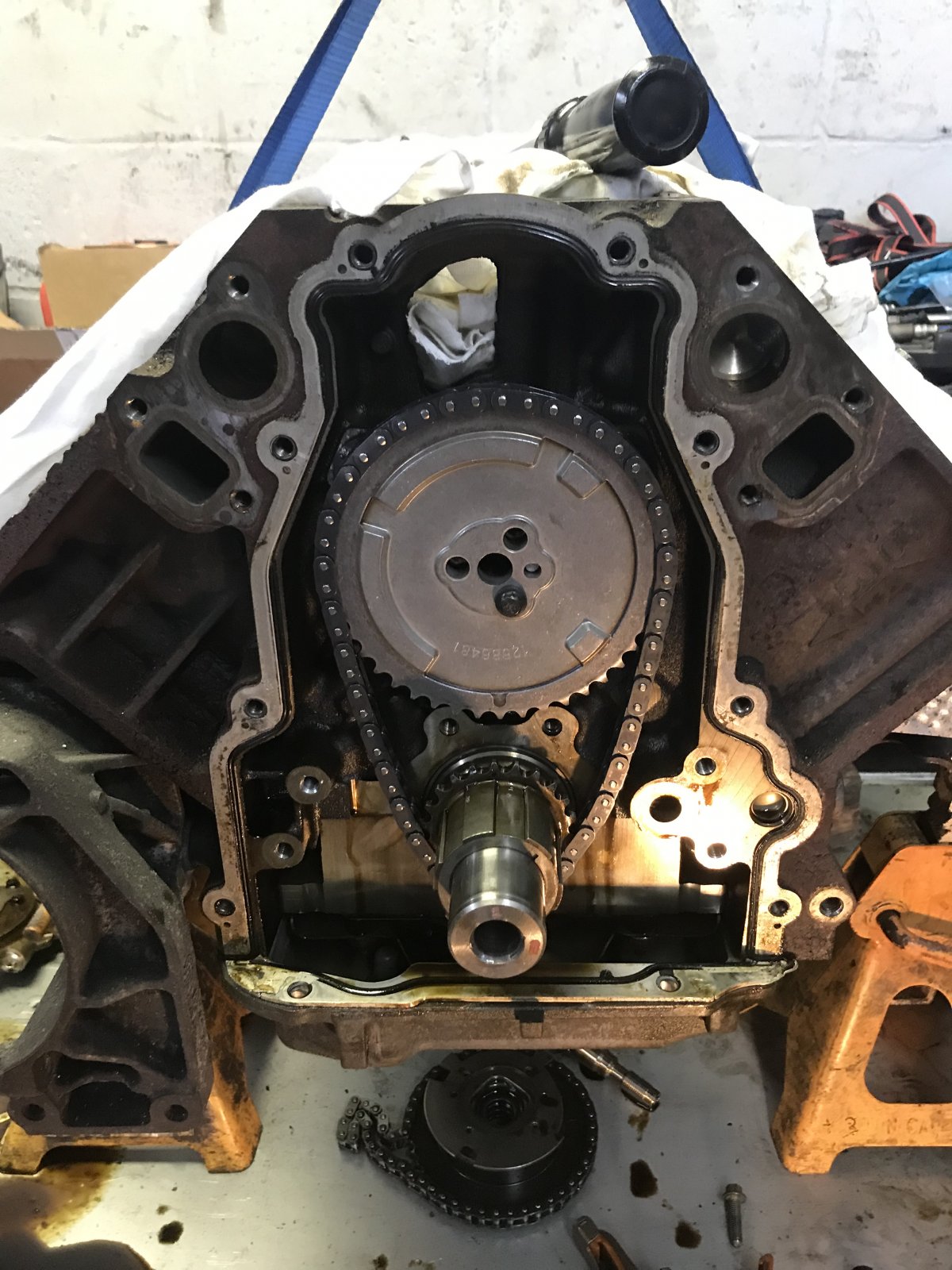

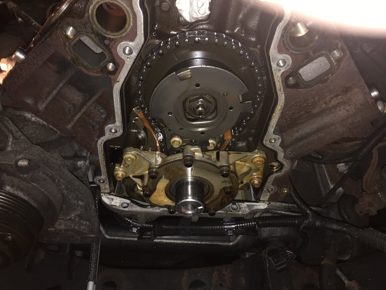

decided to do the new type chain tensioner, with older type chain had too much play
