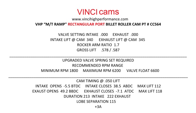

Few weeks ago I messaged a guy local parting out a gmc 2500. At that time he told me he wrote add wrong and motor wasn't for sale. Since them I have had the timing chain tensioner in my 5.3 give out and send metal through the engine seems fine but who knows tbh it kinda scares me that there might be unseen damage. Well the guy I messaged few weeks randomly messaged me tonight saying he decided he didn't need that engine and said he would sell it for $650. It's a 2007 ly6 6.0 with 188 thousand miles. No harness but I think the 5.3s harness Will work on it other than the 6.0 has vvt but I will probably delete that. Was thinking using a ls9 cam they have 0.558/0.552 lift 211/230 duration and lobe separation angle is 122.5. I have also read that using the lc9 5.3s heads and intake would give the ly6 power more in the lower rpm range and would increase compression. I have a spare set of heads from our parts burb which had a cracked block. so I can build this engine up and have it ready if the 5.3 in my burb dies. What do you guys think of that combination would it work good? Or any better ideas or recommendations? I want alot of torque and low rpm power below 4000 rpm I rarely get above that.
21,322
30,319
Was thinking using a ls9 cam they have 0.558/0.552 lift 211/230 duration and love separation angle is 122.5.

A custom ground cam would be pretty expensive that's why I was looking at ls9/ls7 cams can get them relatively cheap.
Who is Vinci?
Any other stock cams that might work without vvt?
I have seen few things about ly6 engines with 243 cathedral port heads but haven't been able to find anything detailed or with dyno results.
This picture is comparing a ls7 cam to aftermarket cams with similar duration if I am reading it right looks like it's timing is slightly retarded compared to the others.

I would be willing to bet that Vinci could tell you all the ins and outs about what you are wanting to accomplish with the 5.3l heads on the 6.0l block. He has been doing this a looong time and knows his stuff.
If you email him he will usually give you his cell number and be happy to call and talk with you about it.
I will try to get ahold of him see what he can tell me
