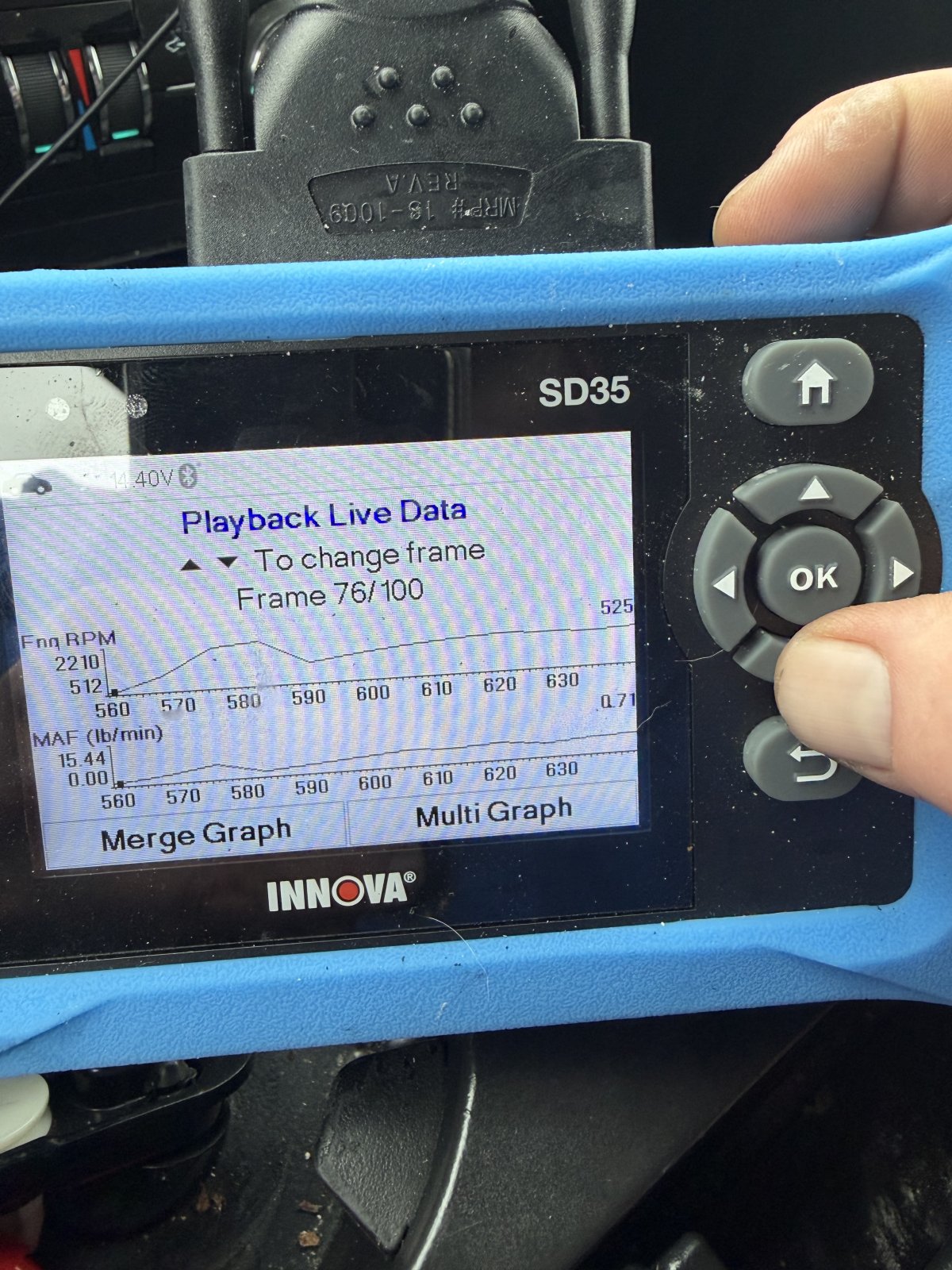

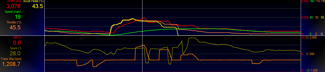

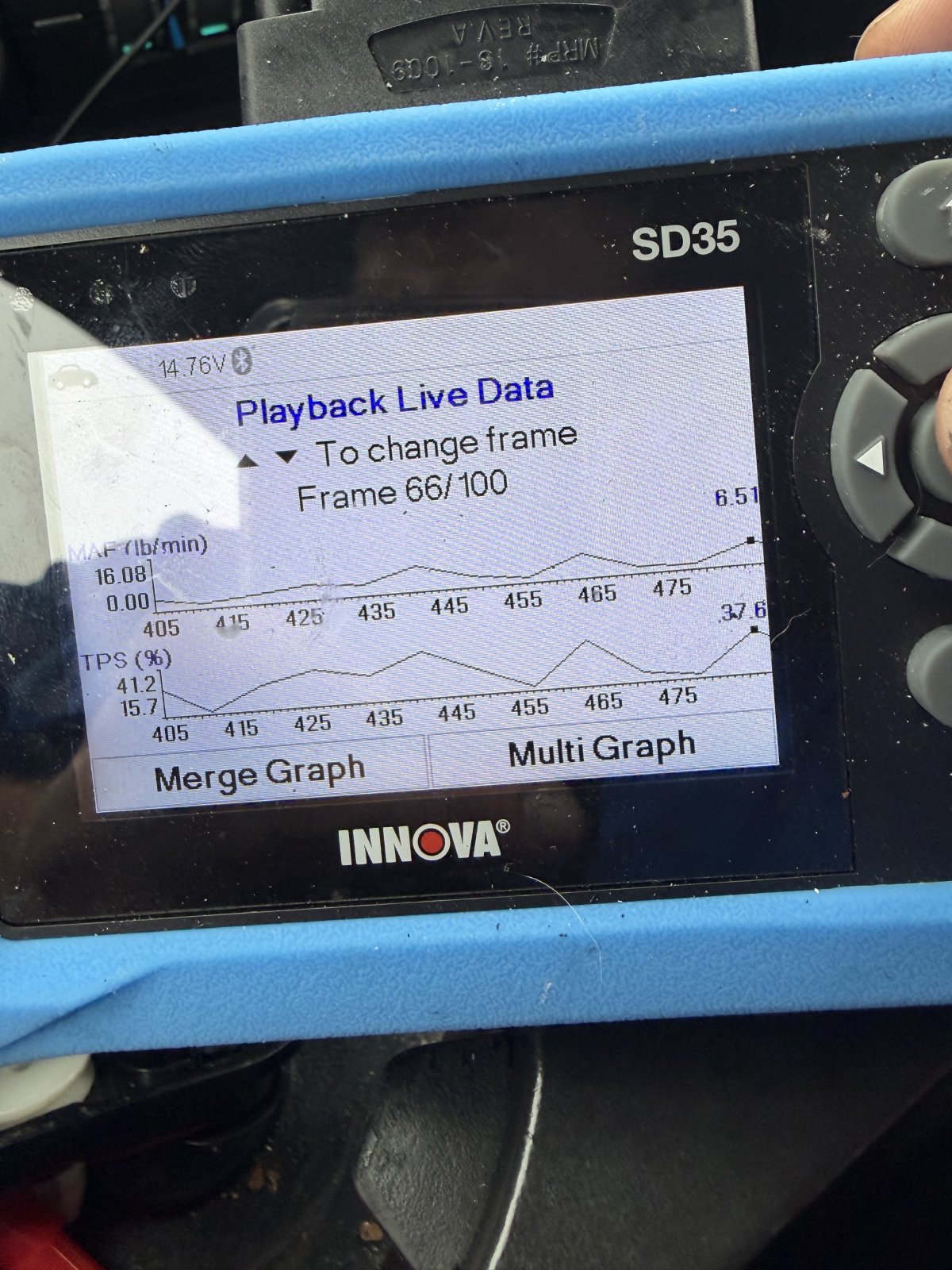

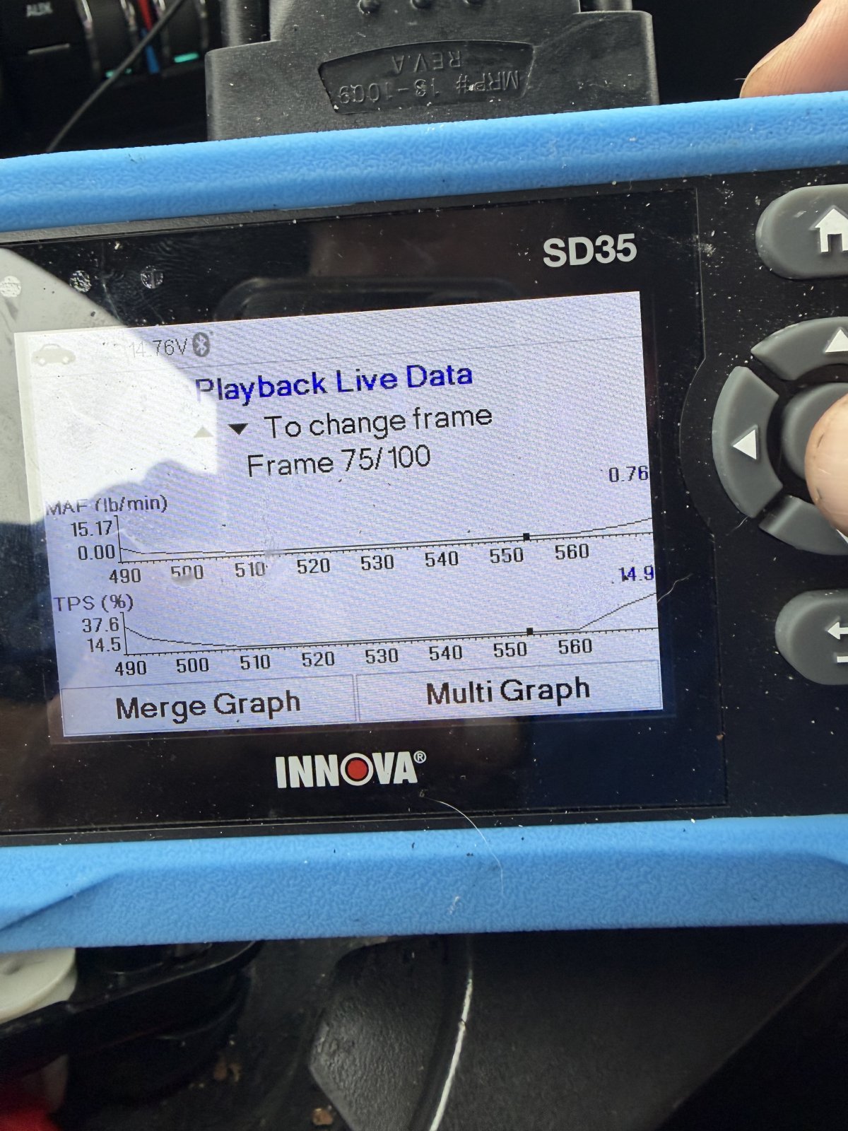

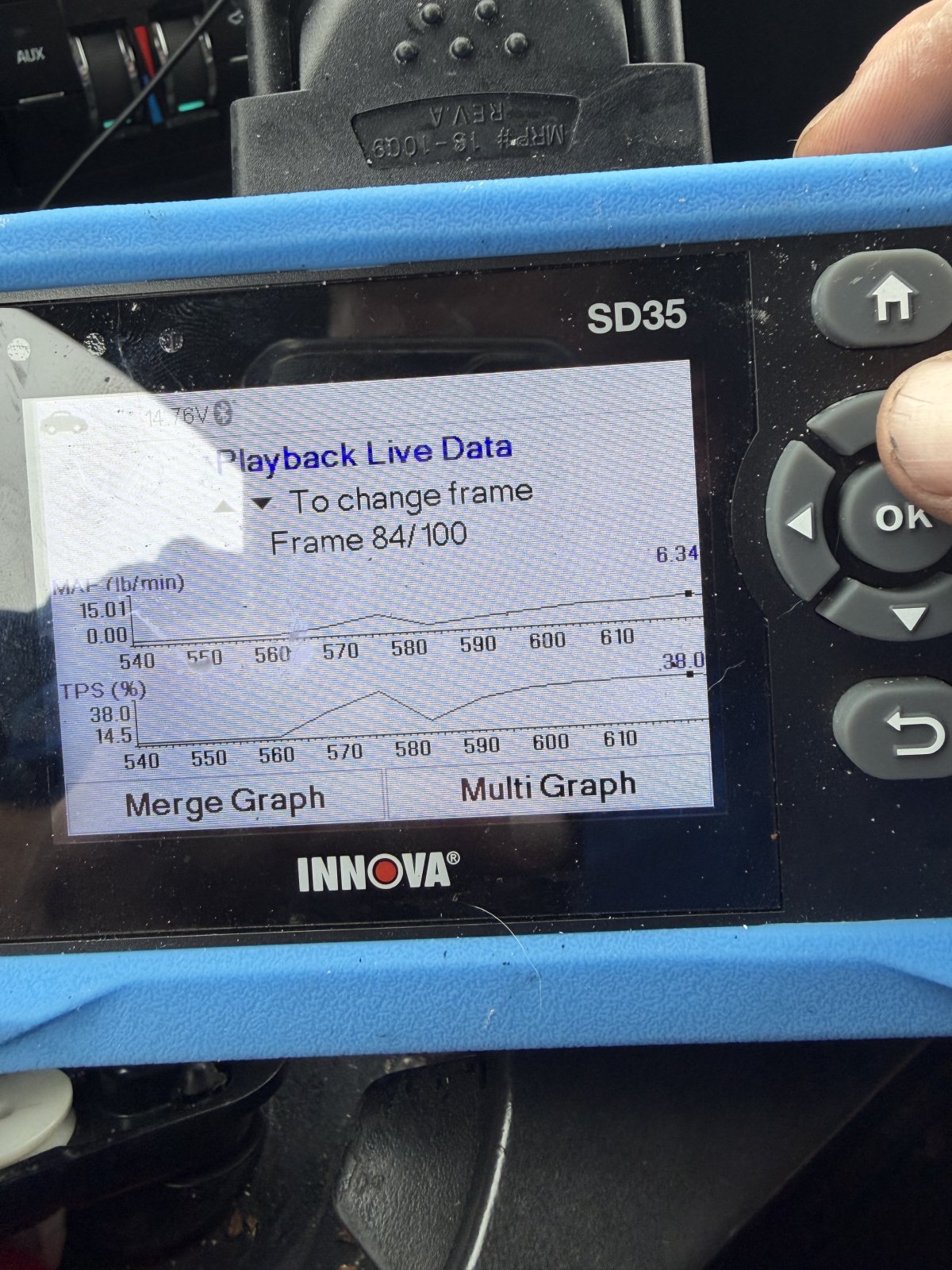

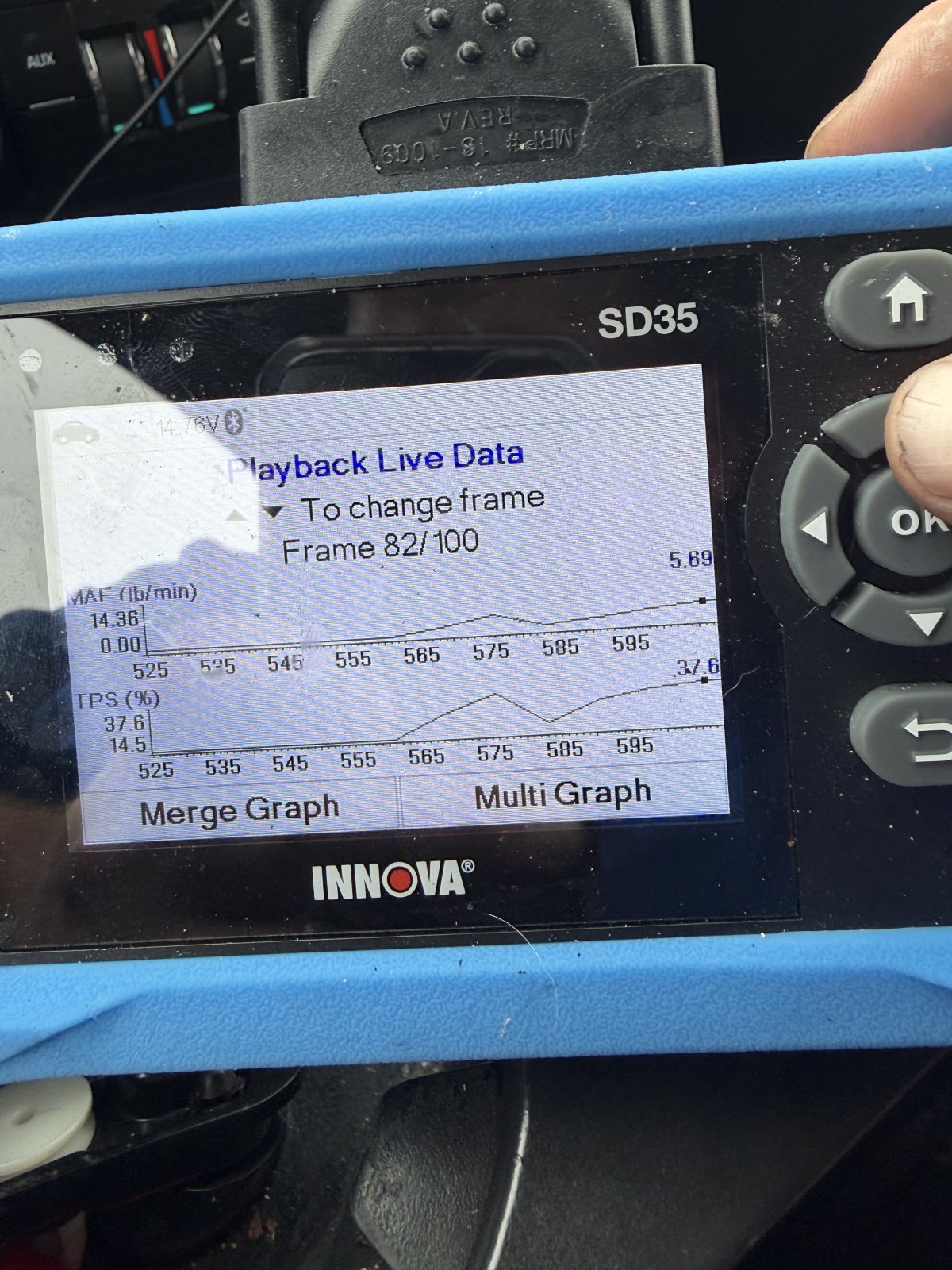

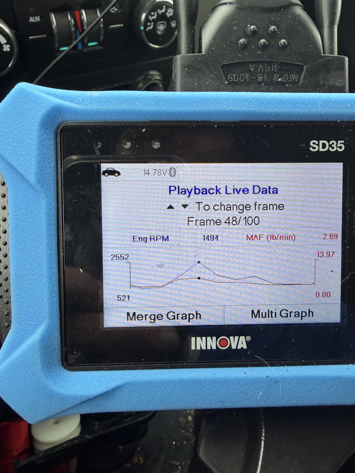

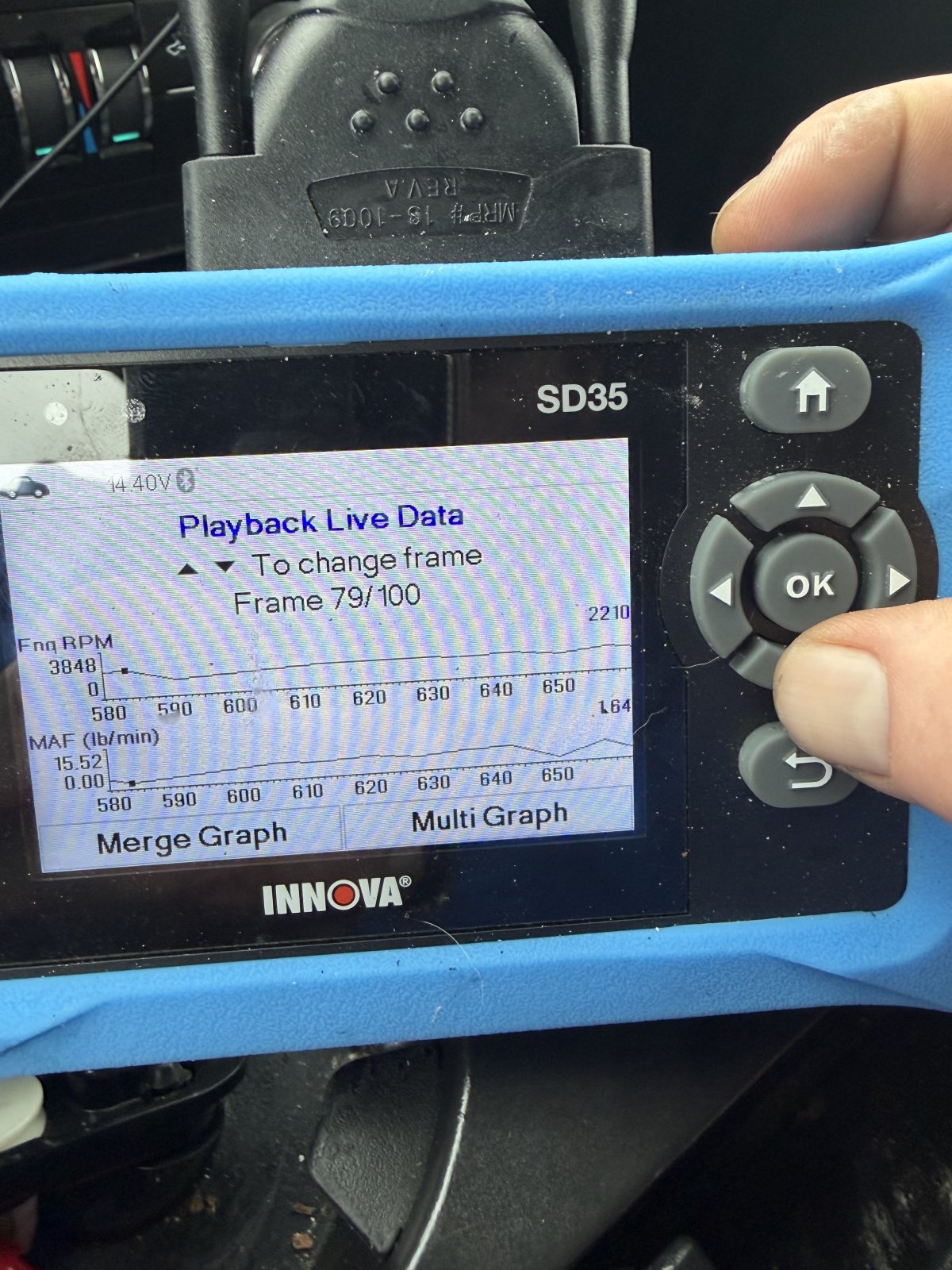

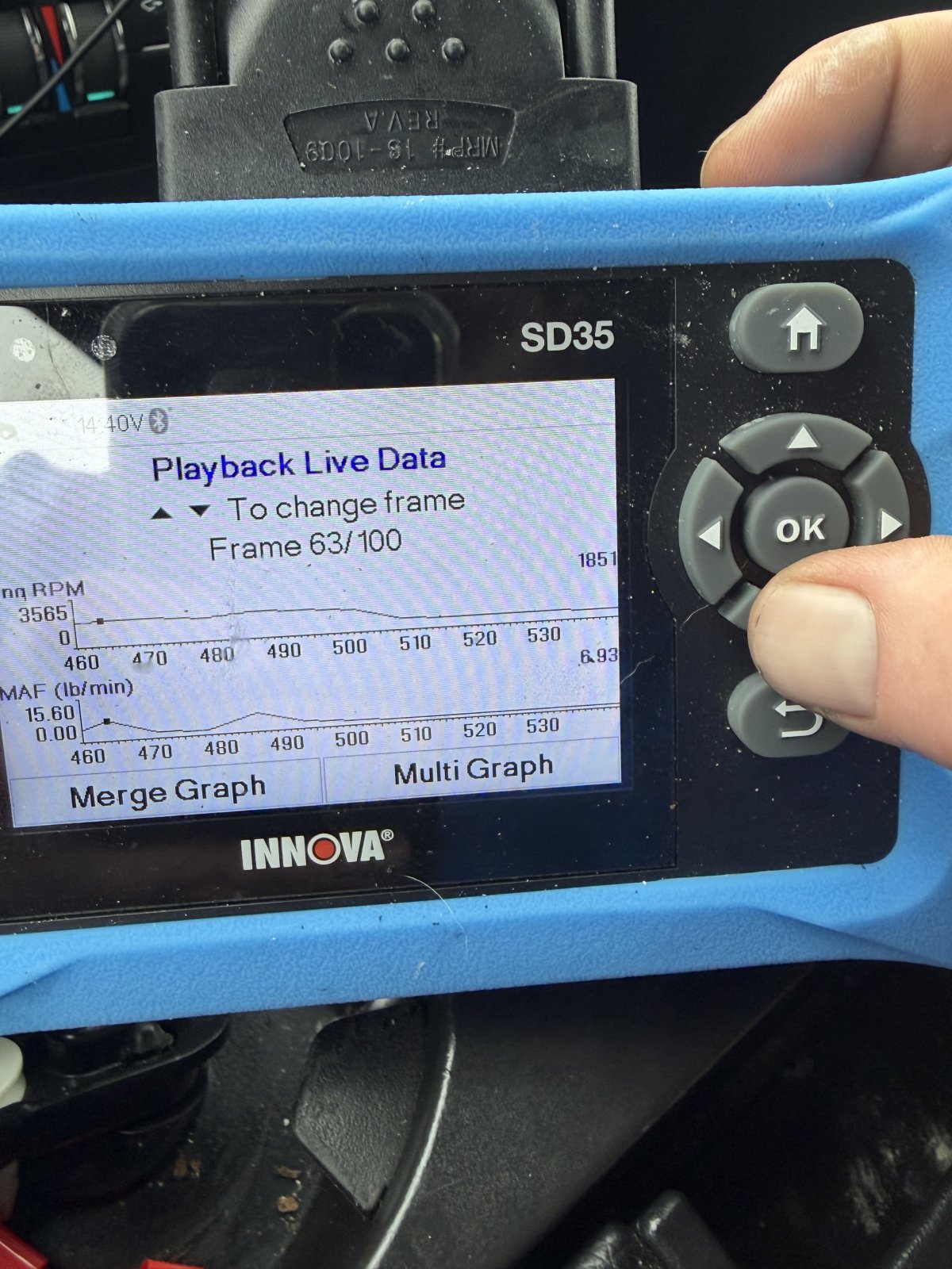

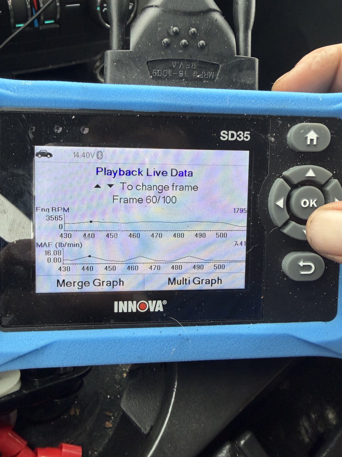

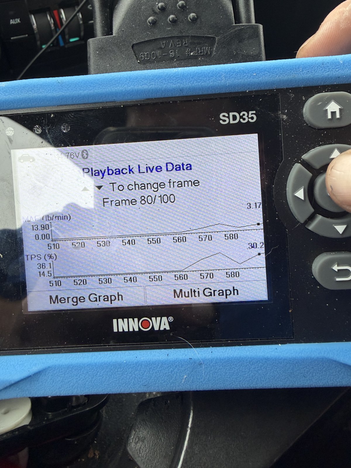

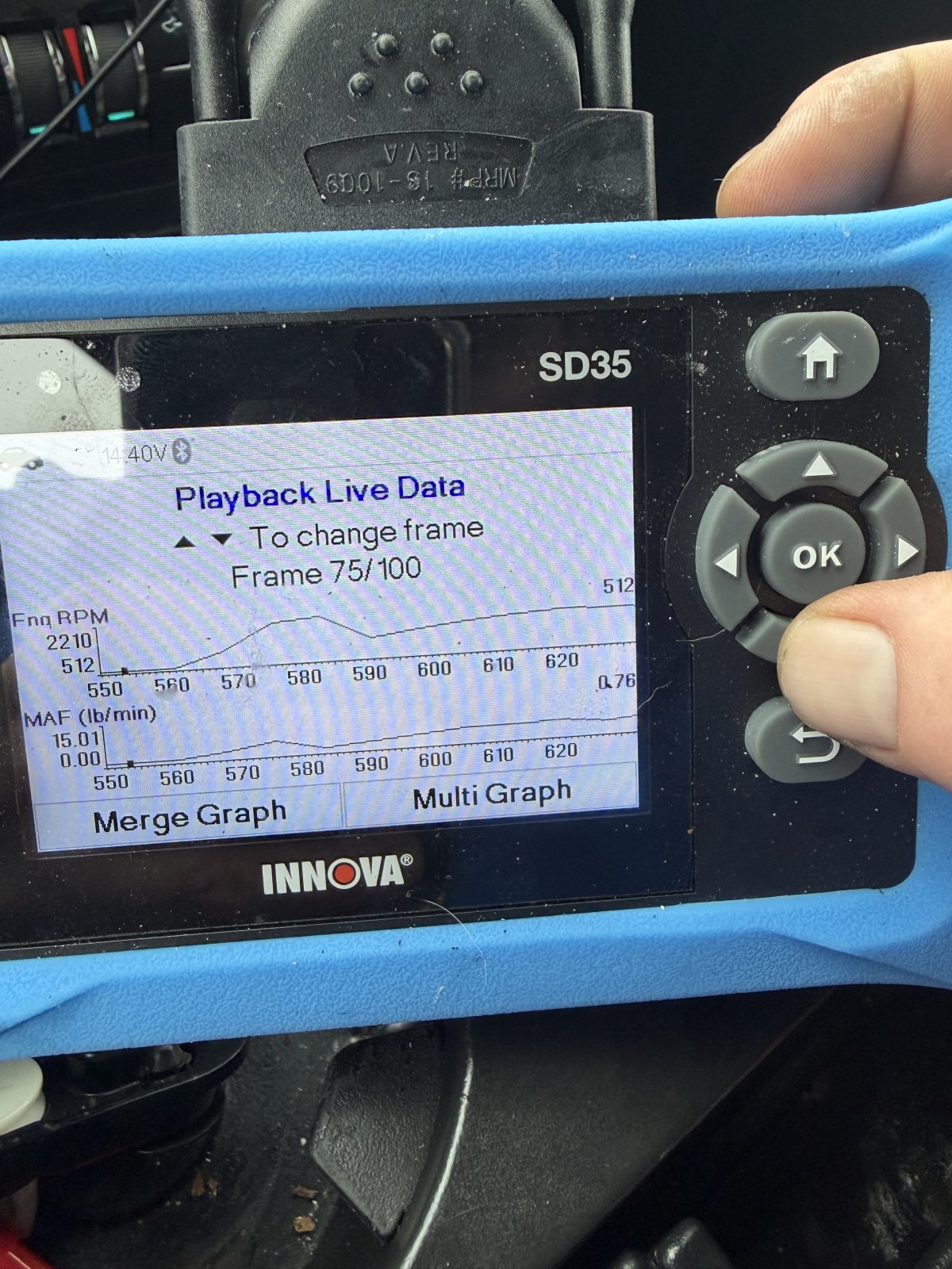

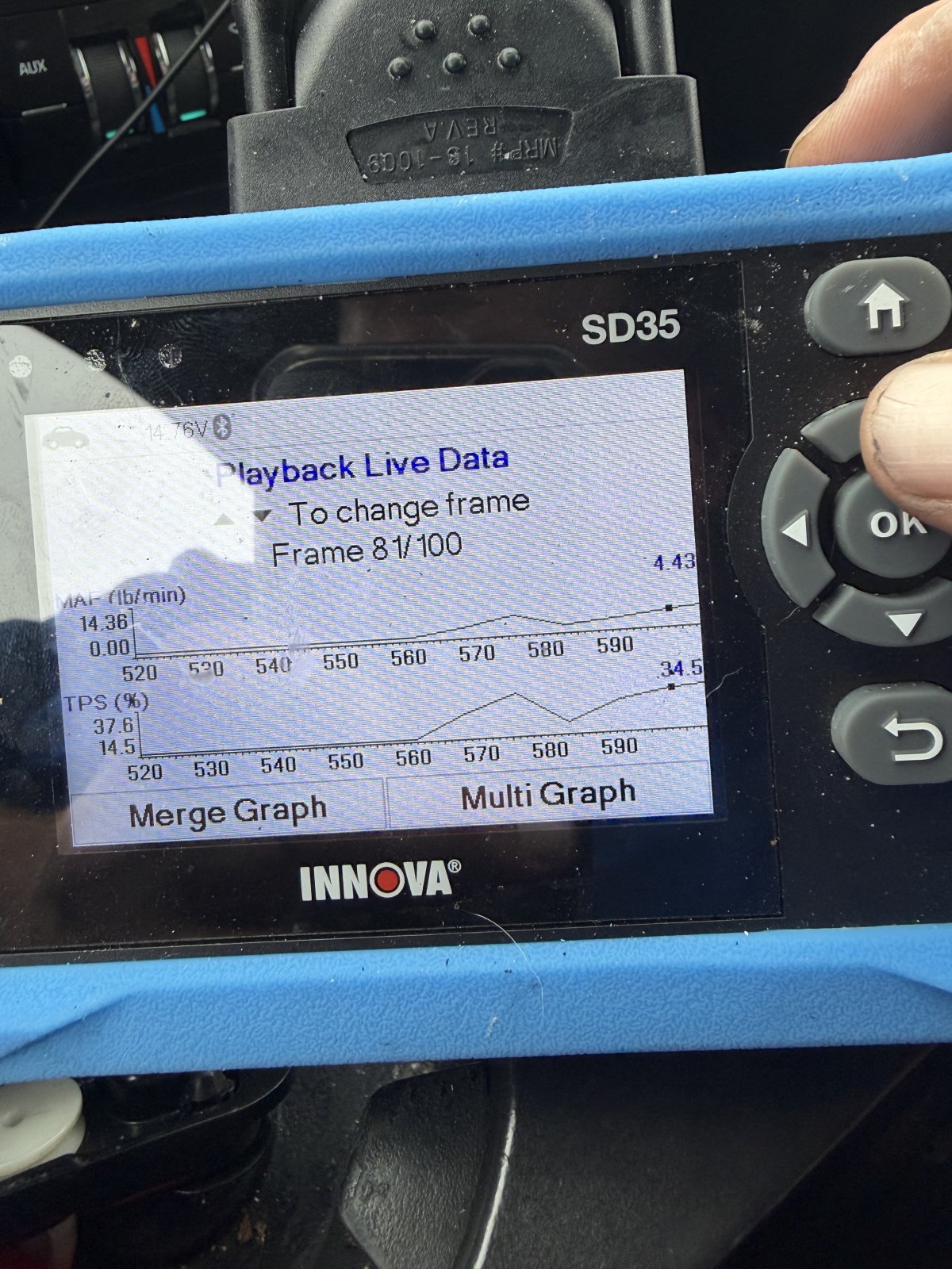

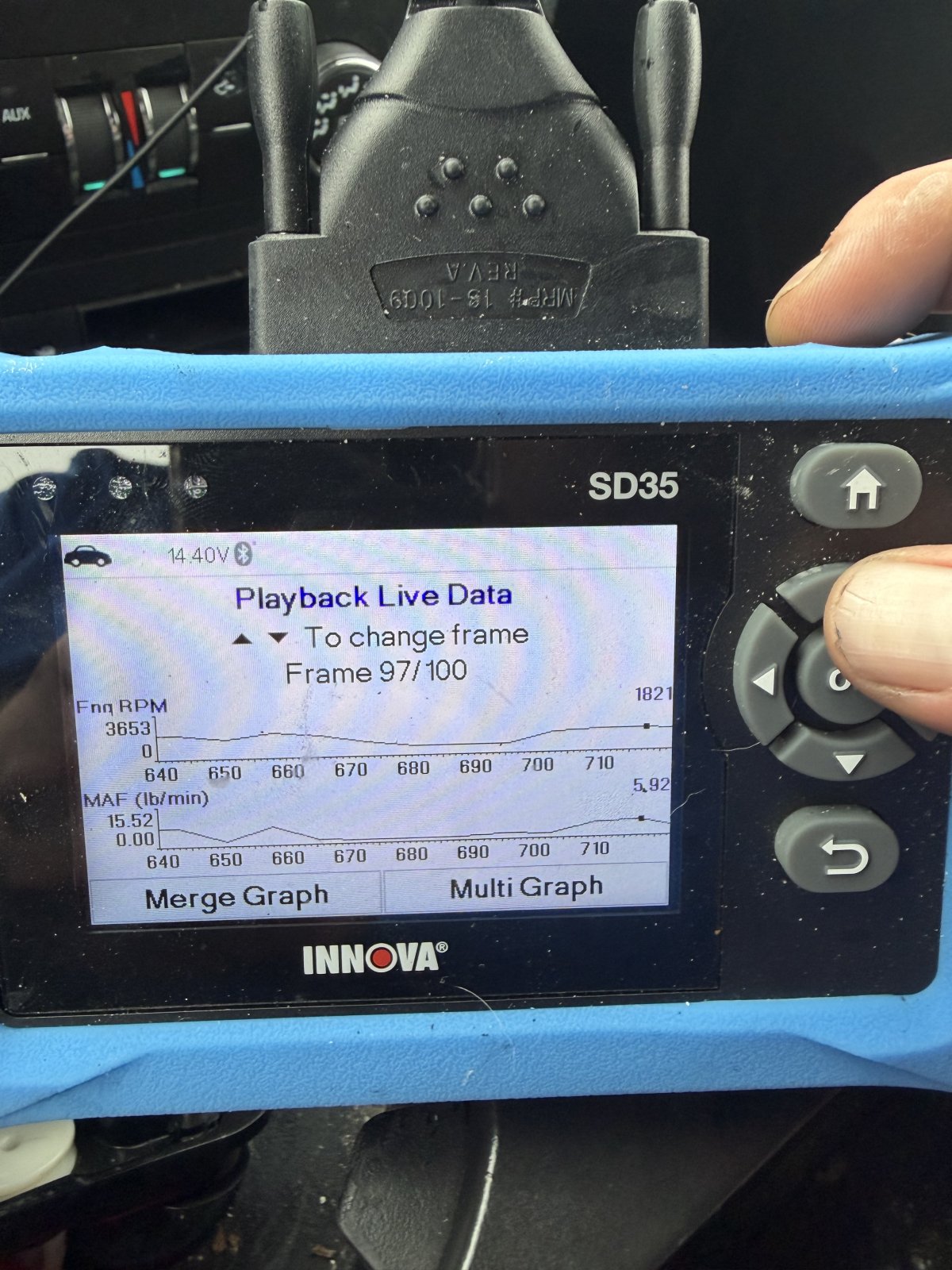

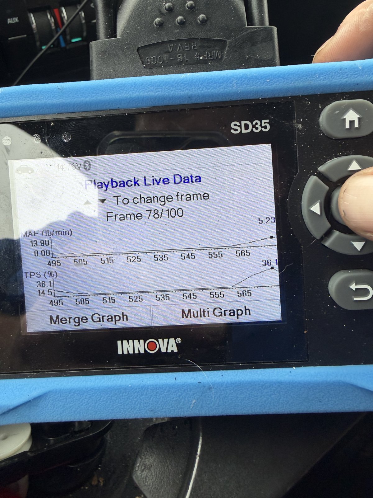

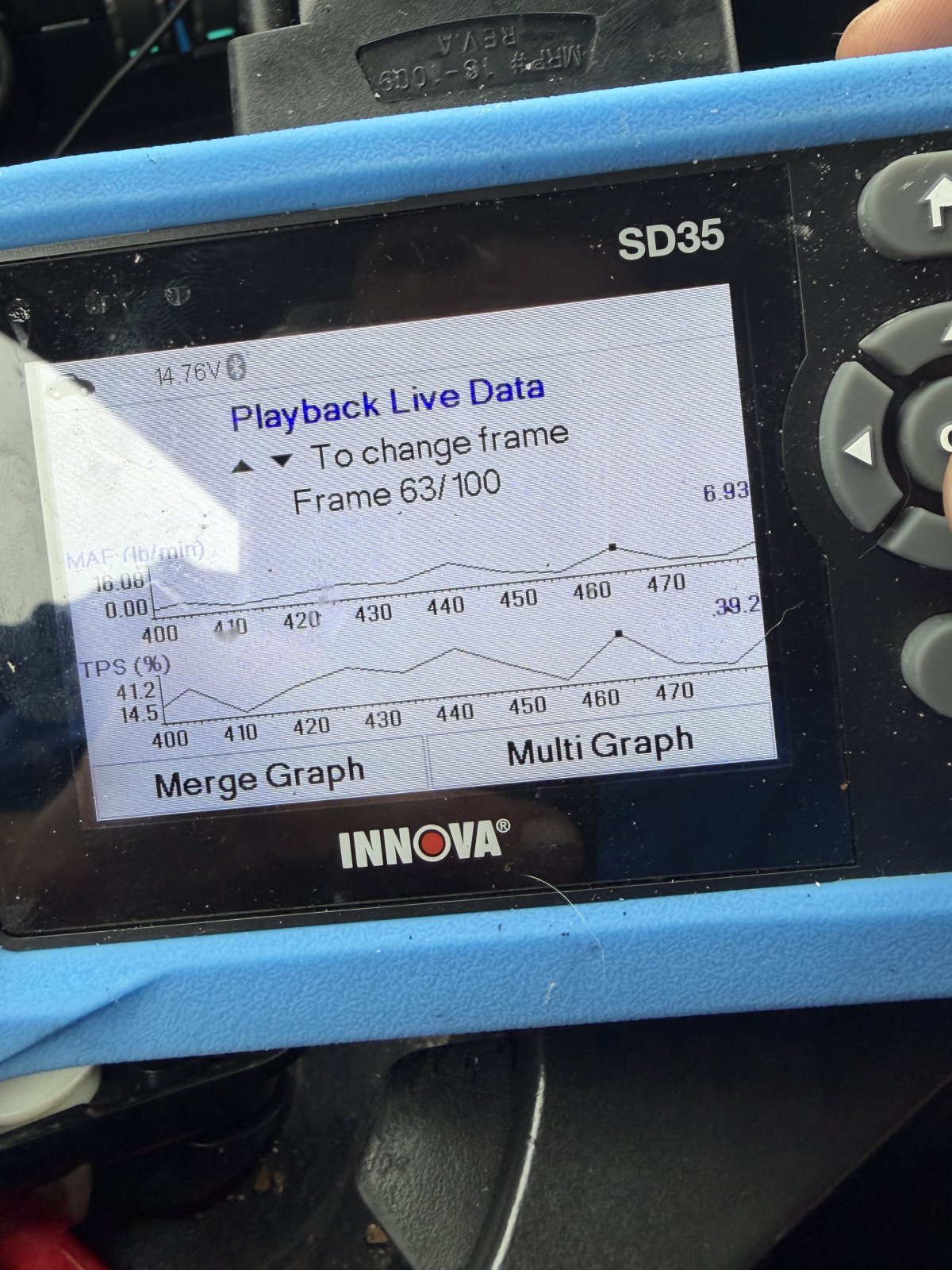

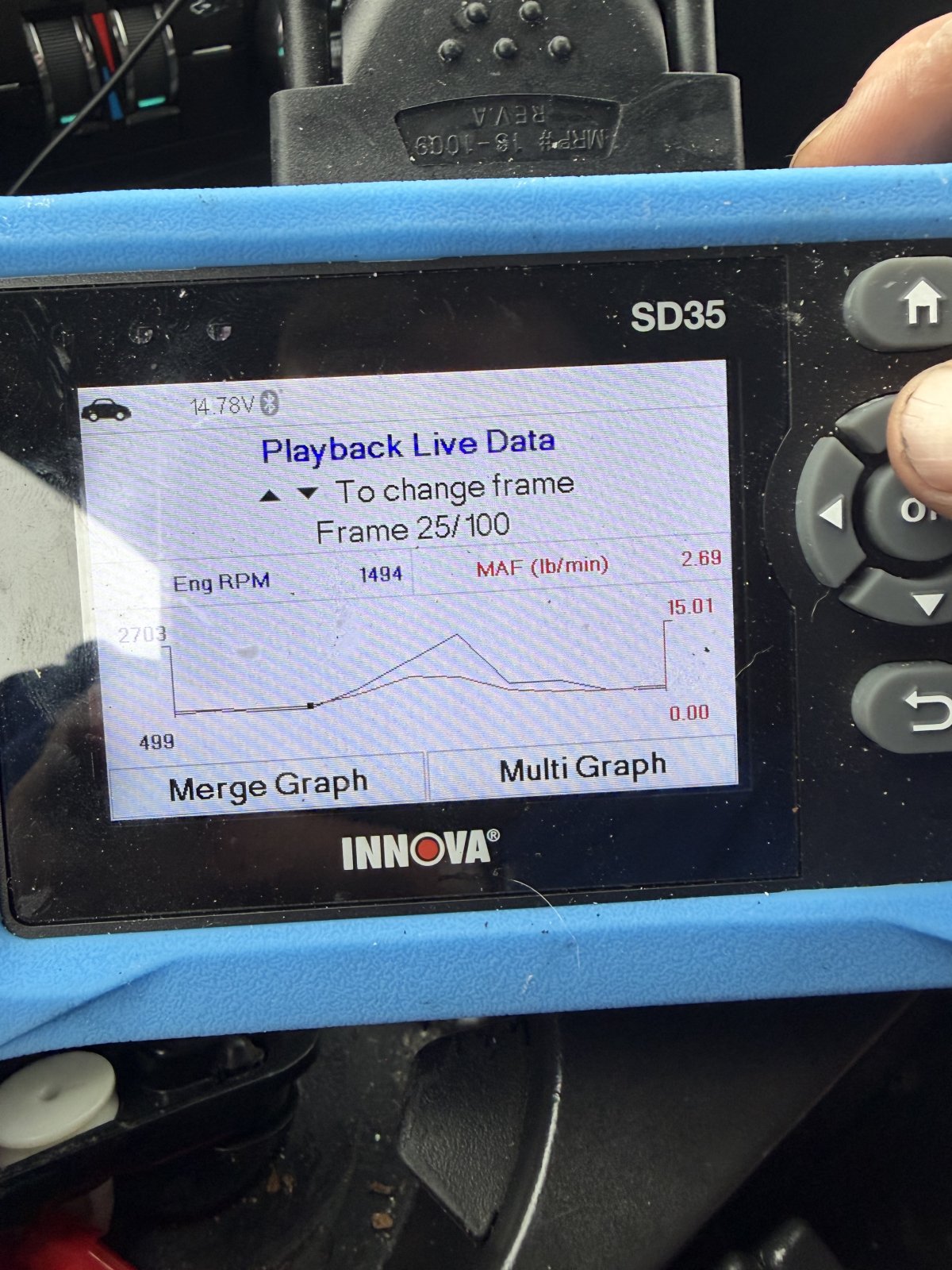

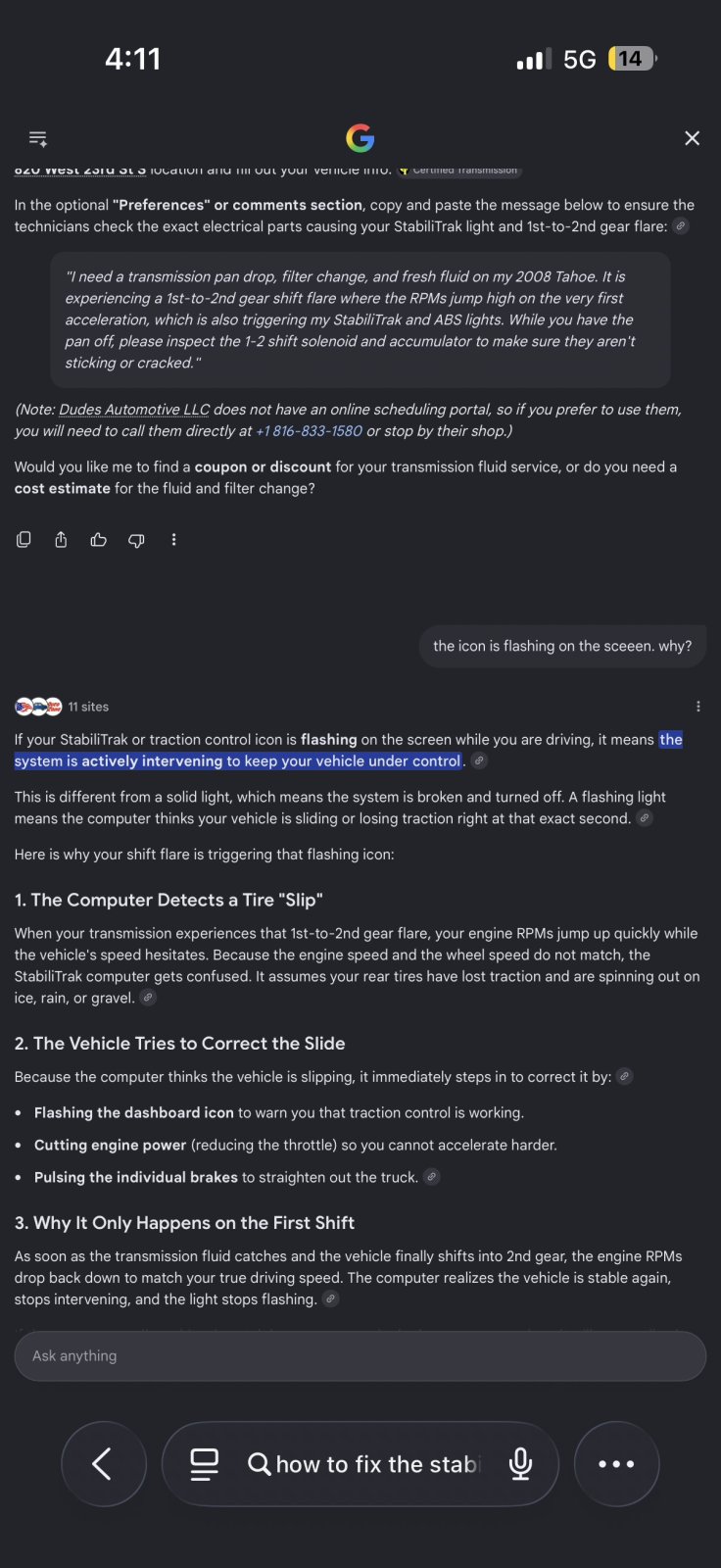

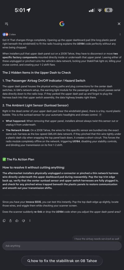

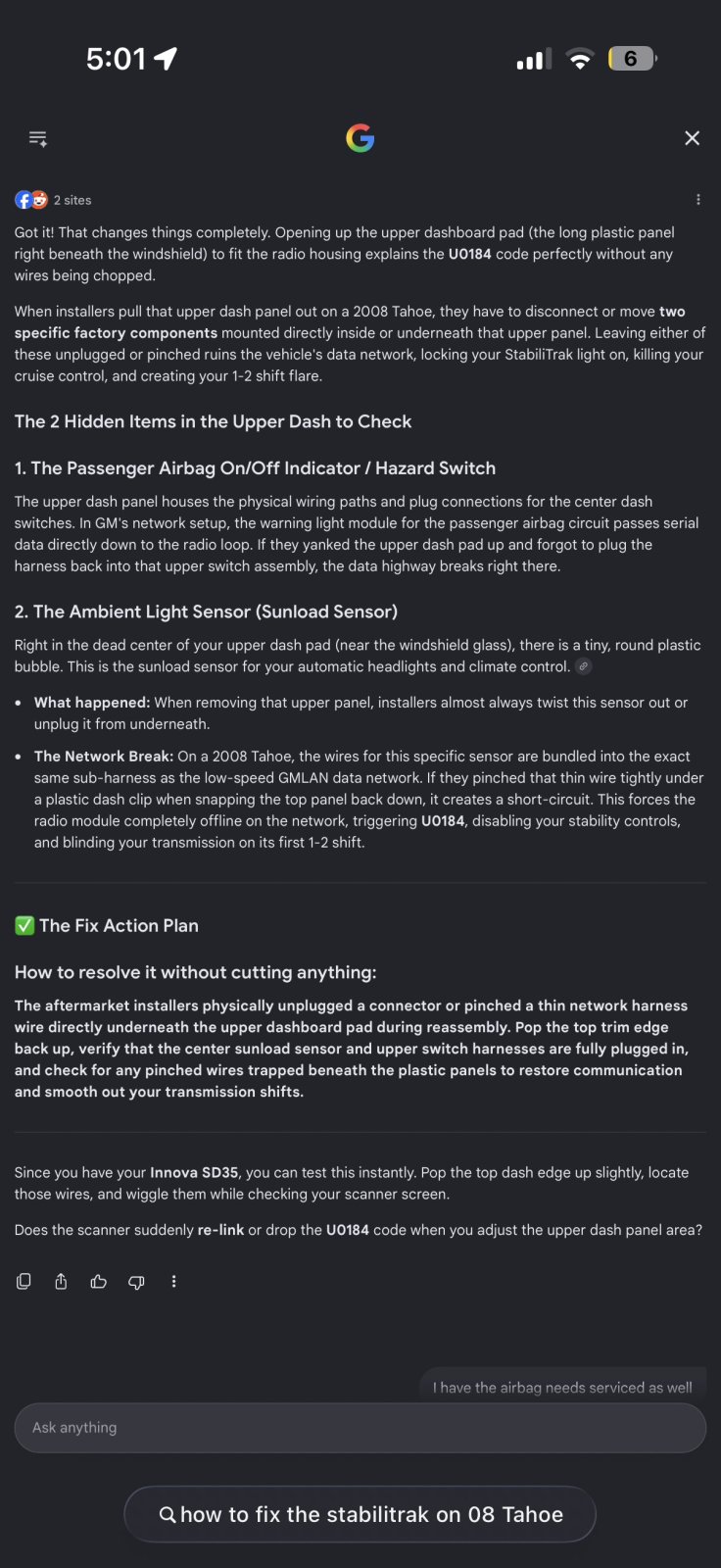

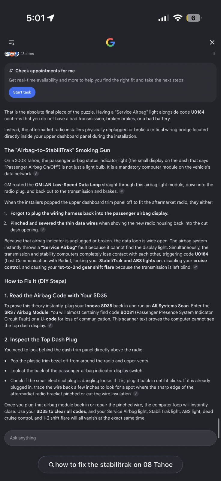

I took a couple pictures of the live data tonight while driving it. To be honest I’m not very knowledgeable with these kind of things so I may not have been focusing on the correct aspects that will help me find out the underlying cause. Also to be more specific the vehicle will accelerate some, just nowhere near the output the RPM Spikes that are occurring. Mostly just compared the rpm’s to the mad and the mad to the a tps. If there’s specific anyone would like to see in order to give a better suggestion just say the word

Copy that I’ll do that later today. It’s just such a specific thing that happens EVERY time upon first real acceleration (I wish I could be more specific, it’s just each time I’m giving it gas from sub 1k rpm or sub 20mph to accelerate as you would when a light turns green) it feels like I imagine trying to move in quick sand would be, it struggles until either I surpass 2500 and let off the gas a bit the rpm will instantly drop all the way to 800 or so then when I press on the gas it drives GREAT with no issues whatsoever. Until I have to slow down or stop then the process will restart. I’m going to get a video and post it later this morning for context. You can actually feel it almost… relax then drop down as it should. I’m not sure if this correlation has anything to do with whatever the underlying issue is but during this time of struggle and rpm surge the oil gauge will get up to around 60 then drop down to 40ish. When it’s driving well it’ll hover between 35-45 but mostly right around 40. Hopefully the video will help explain better than I’m able to.

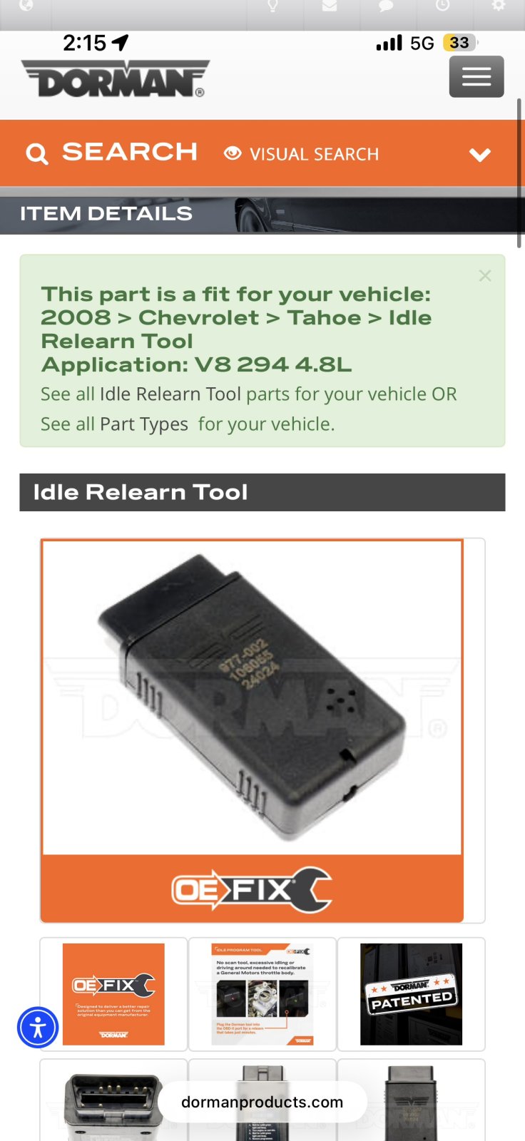

FWIW Dorman's web site shows that the idle relearn 977-002 tool goes back to some 2014 models only; it doesn't seem to be compatible with a 2008.
