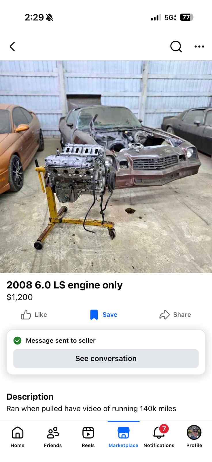

I just saw this LY6 for sale on FB marketplace. Is this a good candidate to swap out my 5.3 LMG in my 2013 Tahoe?
I’d like to keep flex fuel capabilities, but it’s not a requirement - I never see e85 in my area. Would I have to use a l96 cam to do that, or are l96 and LY6 the same?
Is there anything that would not (or I should not) transfer over from the LMG? Intake, injectors, throttle body, sensors, etc?

Thanks for the comments guys. False alarm on this one - I messaged the seller and asked what it came from. Answer: 2010 Denali. So it’s an aluminum 6.2 , not a 6.0. I’ll keep looking for a fully dressed l96.
