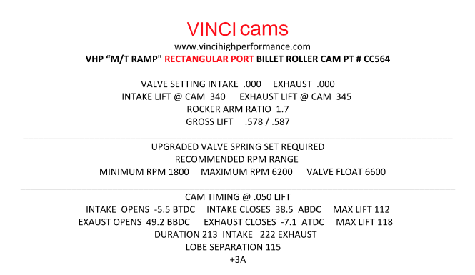

Hey is this still for sale? How much you want for it? I was looking at a vinci cam stage 2 trucker cam and all the accessories.
Yes, I still have it all. I haven't been actively trying to sell it, but would make you a good deal if you want it. I'll PM you a little later today with the full parts list and an asking price.
