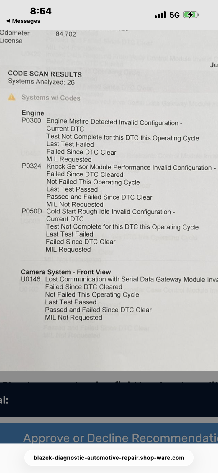

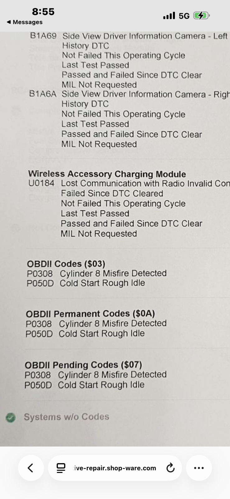

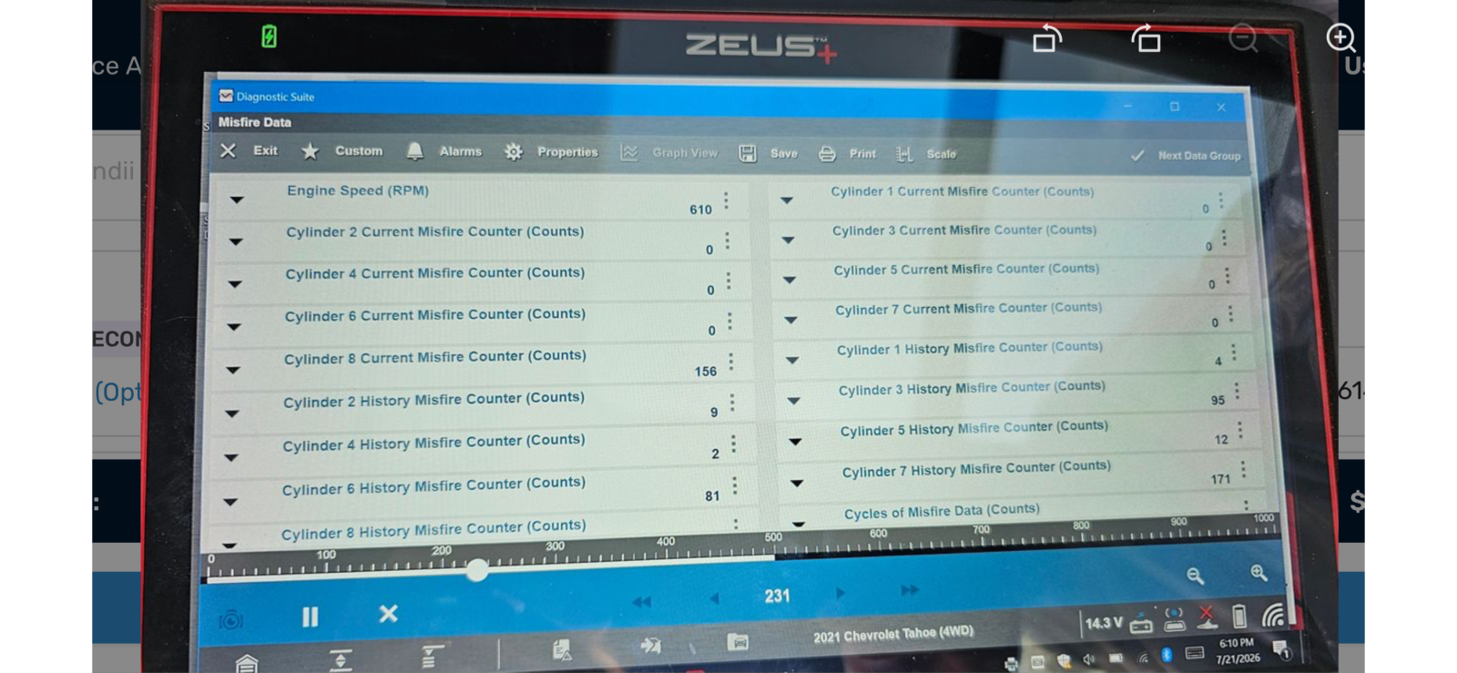

Here is some screenshots of my report.
Does any of this point to something kinda specific? It’s like reading in Russian to me, I don’t understand it.

Before you have cylinder heads pulled, I would have the mechanic pull a valve cover and inspect the cylinder #8 spark plug first, then possibly use a more advanced borescope to look inside the cylinder at the valves. Possibly perform a compression test and cylinder leakage test on the #8 cylinder.
A decent borescope can also go a long way to fully understanding what is going on by looking down at the cam and lifters as well as looking inside the cylinder(s). A decent borescope with with a thumb control to rotate and bend the camera around will allow the mechanic to look back up at the valves to make sure there is not a burner or chipped valve edge.
Something like this - https://www.amazon.com/Articulating-Detachable-Inspection-Semi-Rigid-Automotive/dp/B0G239JCXJ?th=1
Depending on what is found on the first inspection by removing the spark plug, the valve cover may need to be removed to inspect for bent pushrods, damaged rocker arms, and valve springs and make sure the #8 cylinder valves open all the way.
Unfortunately if the problem is with a lifter(s), a cylinder head does need to come off, if the cam is damage, both heads and the front of the engine need to come off which raises the cost and complexity.
