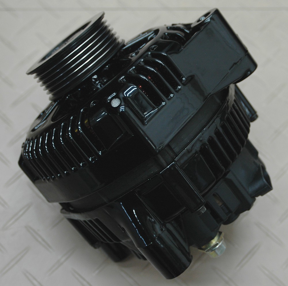

Latest pic
45,014
You painted that? Nice job.
Lol
That's not mine, just a stolen internet pic. I painted the one on my built LQ9 and it turned out exactly like that one. It just takes lots of cleaning with a toothbrush to get all the crevices clean. Use many light coats (the first few will be "dust" coats) rather than 2-3 heavier coats. I used gloss black brake caliper paint.
Ever seen them paint a big diesel engine before they ship it out? Everything including the accessories, turbos, duct couplings and often even the water hoses are all sprayed. A lot of the paint on the rubber parts flakes off with time/use, though.

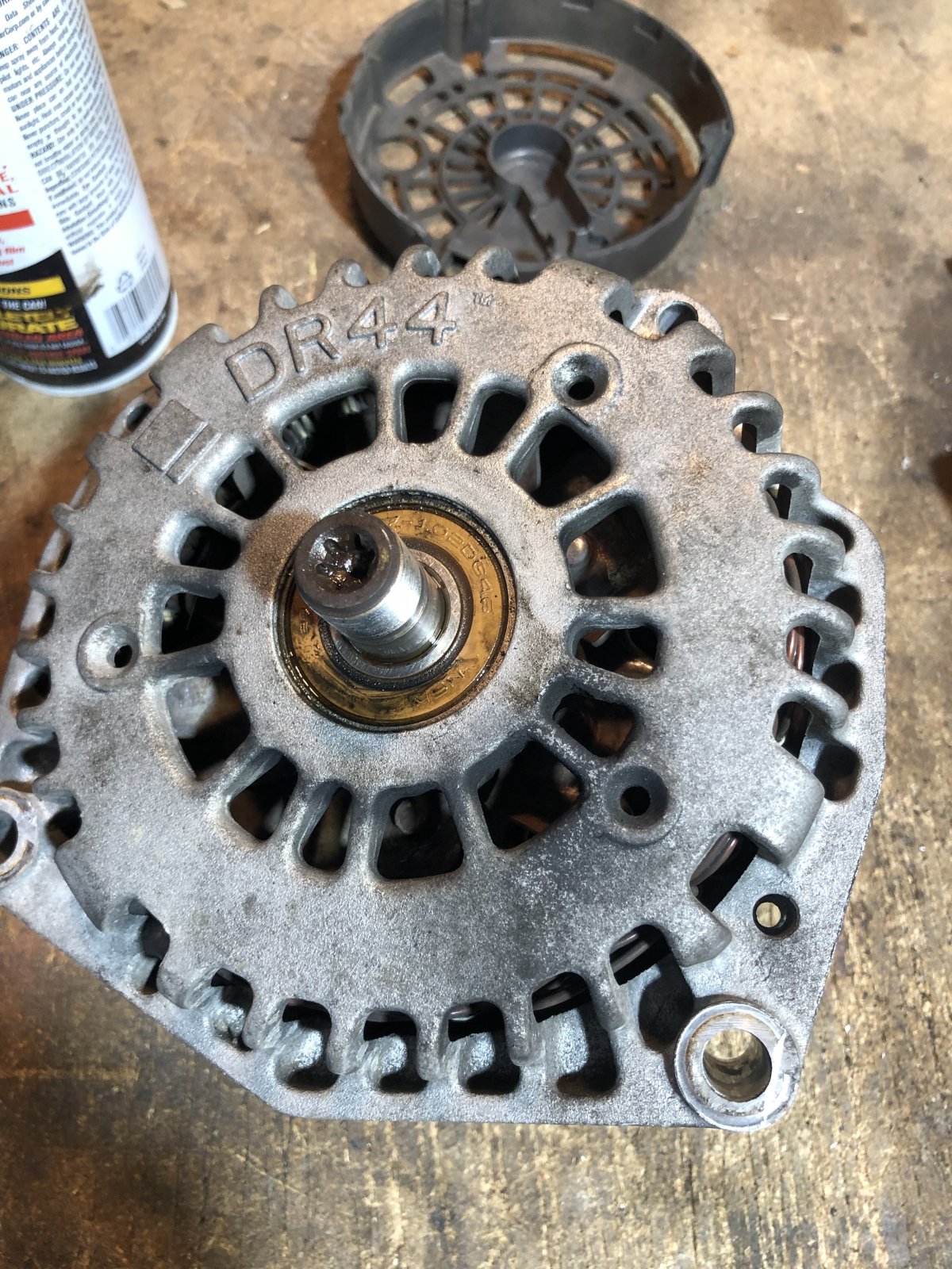

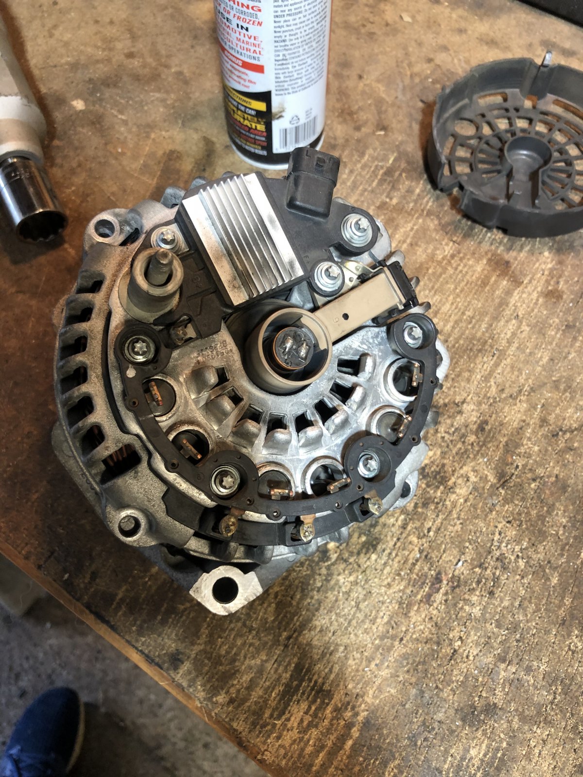

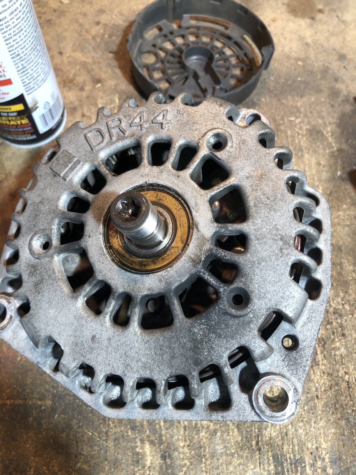

Ok I got the pulley off but how did you pull the front case off? Did you have to use a puller because of the bearing? I’m not sure if I shouldn’t just clean and paint without disassembling this thing. It’s off my 08 so I need it to work when I’m done lmao.
Edit: never mind, figured it out. Sorry didn’t mean to jack your thread.

Bummer. I separated the case and the stator stated in the front half. I tried to bang it out with a dead blow but it wasn’t happening so I’ll just paint the 2 halves as is. I can mask almost everything now except the back half of the windings but I’m not gonna desolder shit.
With the case apart is it possible to slide something between the back half of the case and the windings to serve as a mask? I was thinking maybe some playing cards or thin plastic.
52,954
I didn’t really see a way at the time and now it’s too late! I sprayed the thang lol.
