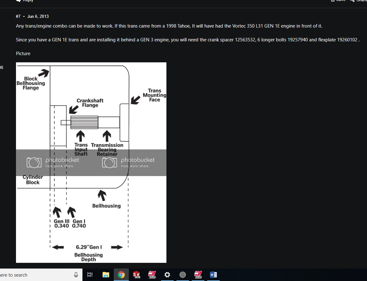

I'm not sure of the details yet but it should bolt up fine
i believe this is correct for my 98
