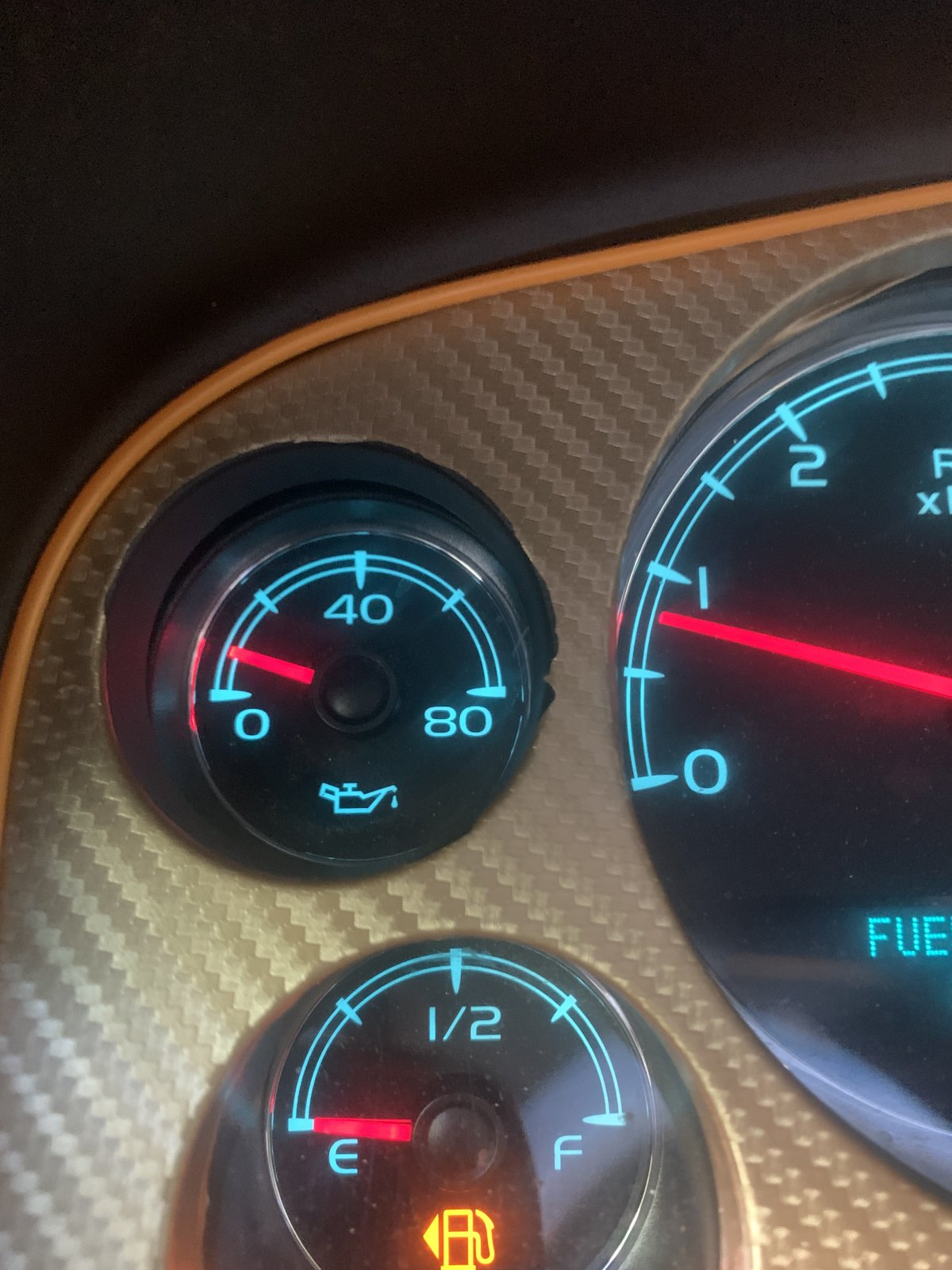

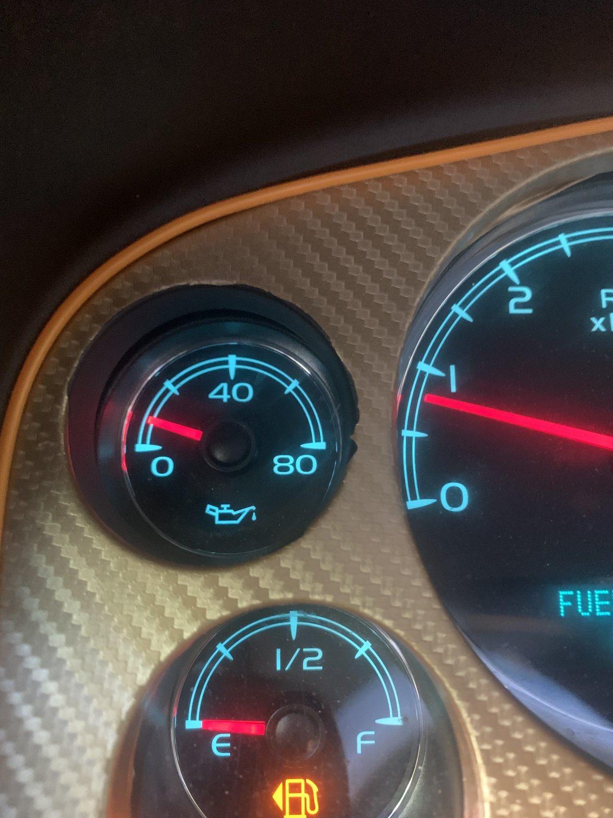

MalcDogg
MalcDogg
Mar 8, 2021
47
23

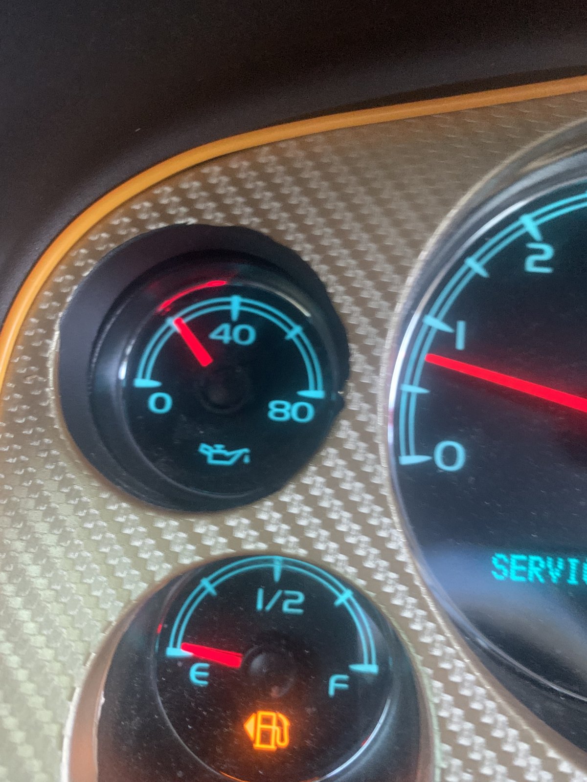

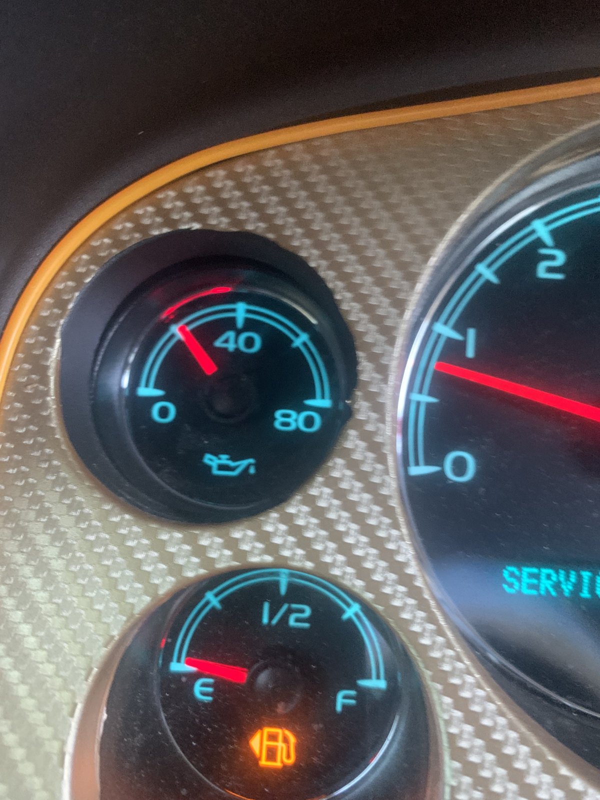

MalcDogg
MalcDogg
Mar 8, 2021
47
23
I took off the valve covers and I don’t have the updated valve covers
Order them today
The oil pressure starts between 20-40 then after driving for 30min it goes below 20 never gets to zero I do get a lot smoke from tail pipe on start up that’s it goes away after 5min engine is running fine but the low gets low after a few days have to add a quart or so
