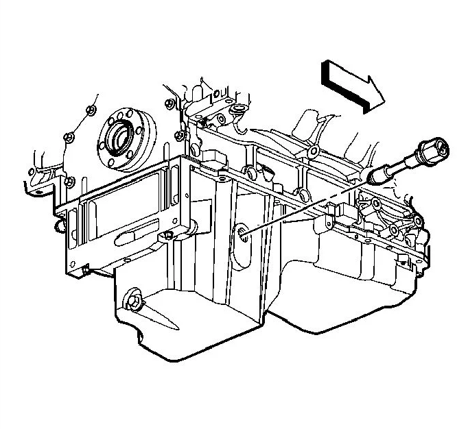

Let me chime in on the o ring test real quick
The o-ring is situated about level with the pan
The pan in these things are pretty large
2qt over will not appropriately raise the level, nor will a slight difference in angle introduced by jacking the rear end push enough oil to the front.
Consider the height of the oil level sensor in this diagram and the shape of the pan. I think that'll clarify why an extra quart or 2 is negligible. That much of an overfill would also allow the crank to dip into the oil and why it's not recommended to run it for more than a few seconds. If you experience the issue when hot, run the engine until hot, overfill, run again, get your numbers, then turn off
if you want to see just how much the pan holds, pull the dipstick tube out and dump oil in until it runs out that hole like a diff
Edit: Fixed picture
Edit again: If someone has access to cheap oil and would be willing to yank the dipstick and note how many quarts is needed to overflow the hole, that would be sweet.

Studying that pic and holding my finger parallel with the pan at the sensor height (the approximate level of the oil at 6 quarts), I rotated my laptop until my finger was pointing just above the front of the flange (the approximate location of the O-ring). Totally a rough measurement and guess, but I'm thinking an extra quart or two and a 20-30° nose dive should reliably submerge the O-ring.
Sounds legit :emotions34: and agrees with the conventional wisdom, so how do you explain Doug's experience? Not enough pitch?
45,011
I considered looking for a side pic of the oil pan and holding a protractor on my laptop screen to come up with a more accurate angle.
...so how do you explain Doug's experience? Not enough pitch?
That's my guess. I just don't see how submerging the O-ring WOULDN'T be a valid and reliable test. The key is determining an overfill amount and angle that guarantees it'll be submerged. I think nose-diving it is better than overfilling it by 3, 4, 5 or whatever quarts. If it were me, I'd do about 2 extra and pitch it.
20-30 degree nosedive is steep as hell. 20 degrees is a 36% grade. Bear in mind that's a slight bit steeper than Baldwin street
Another consideration is that as soon as you turn the car on, oil's going to be out of the pan and circulating/dripping through the engine, which will cause the level to drop.
if anyone could get some detailed measurements of the pan, perhaps we could calculate the rough volume to fill it. I'd crawl under and do it myself but I don't have a tape measure with me

Maybe. He said he did the overfill test- but how much did he overfill it? Then he backed the rear up on ramps- that's not much of an angle. IMO, based on this, there's a chance the O-ring still didn't get submerged.
45,011
Lol
That definitely puts a better visual on it! Like I said- rough estimate. I literally just held my finger up to your pic, parallel with the flange of the pan then rotated my laptop. At 2100, I'm not gonna have the sharpest mind to picture a protractor's scale over the screen.
