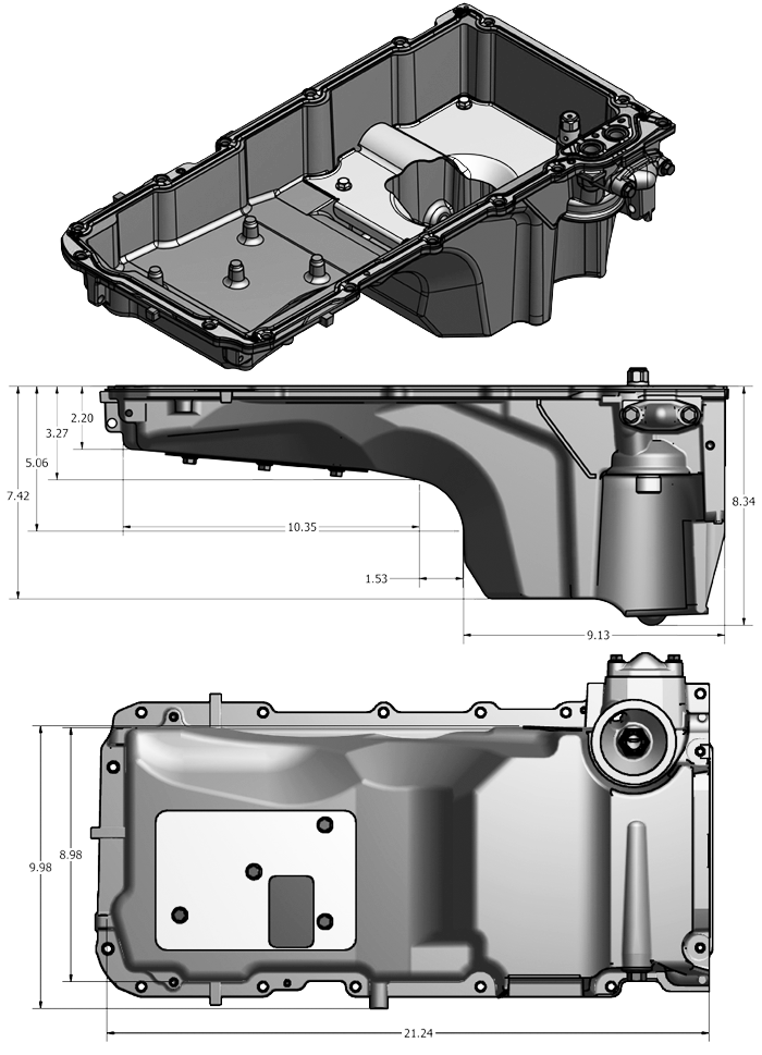

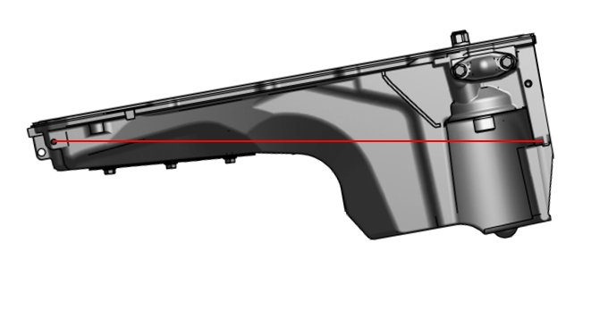

Did a little rough estimate on the oil level in the pan this evening. This is nowhere precise, just an estimate and some rough calculations. Here is a dimensioned drawing of the oil pan I found on the internet.

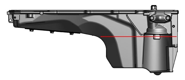

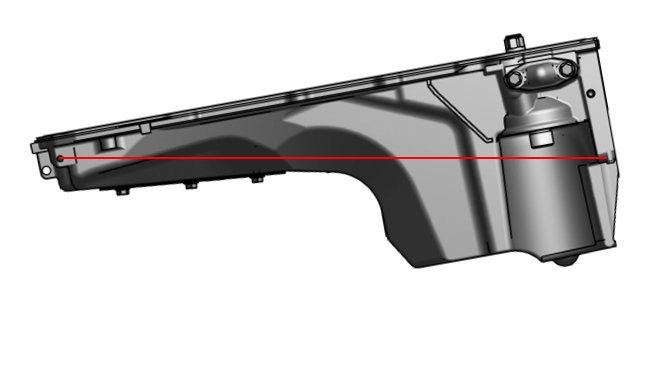

From this I did some rough calculations, and the red line is about where I estimate a normal 6 quarts would fill the pan to.
And if you tilt it 10° This is about where the oil level would be.
So probably 1 inch or so below the oil pump intake where the o-ring is. The problem is, now when you pour more oil in it has the full length of the oil pan to fill. By my calculations it would take an additional 3 quarts to raise the level 1 inch in this position. So my 2 quarts wasn't enough to submerge the o-ring, I needed at least one more. That or tilt it down more.

I thought that when the manufacturer says oil pan capacity is 6 quarts, that would mean that 6 quarts fills to the top of the oil pan? I was looking at replacing my oil pan and several makers list the oil capacity for the oil pan replacement as 6 quarts,which I assume is the capacity of the Oem pan. Just throwing it out there as this is interesting stuff. Even so, it would not change dougamiller’s estimate too far off.
Using the dimensions that I found and assuming the casting is about 1/4 inch thick, 6 quarts would fill it to approximately the line that I marked. The pan would hold significantly more filled all the way to the top, by my estimate probably over 12 quarts. The rotating assembly (crankshaft and rods) reach below the block and into the oil pan. If the oil filled it all the way to the top they would whip it into foam, something you don't want happening. So the oil level is certainly below the top of the pan.
When they describe it as a "6 quart" oil pan, they are referring to the depth of the sump. Depending on the vehicle it is intended for, some oil pans for the LS-series engines hold more or less.
