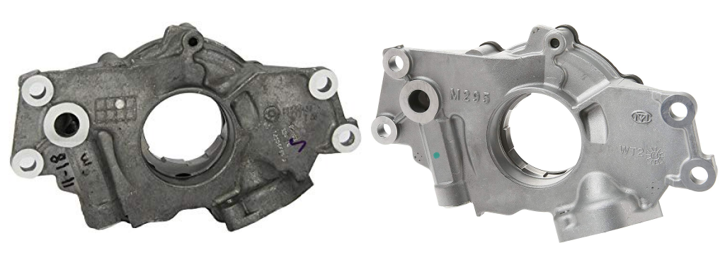

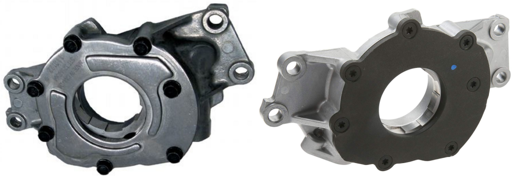

Melling makes the pumps for GM. AFAIK, the only difference is the GM pumps have the part numbers engraved or embossed on them.
Really? I did not know that. The aluminum castings do appear to have come out of the same tooling, but the Melling assembly is somewhat different. The Melling front cover is CNC cast iron, GM is stamped steel. The Melling housing is hardcoat anodized, GM does not appear to be, but not sure. Don't know about differences with the internals.
GM on the left, Melling on the right. This is the standard Melling pump, not HP or HV.
Melling, AFAIK, is the OE supplier but their pumps that you and I buy are improvements over the original according to this article:
https://www.enginebuildermag.com/wp...es/03_01_2012/986163348GMGENI_00000054947.pdf
Lots of good info in here even for you Gen III LS guys.
