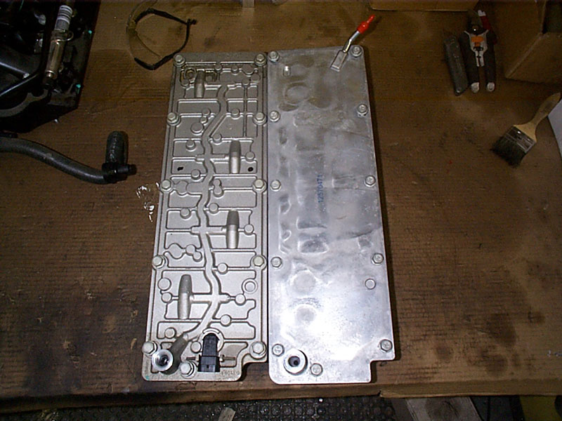

When comparing your valley cover to the pic below does it resemble the one on the left(AFM Style) or right(no AFM)??
Right

Well if that’s the case then your particular engine was not one of the early builds and does not have the AFM components...that being said the oil pressure relief valve is only required for AFM so you should delete it, although this may not fix your problem since it should never activate without AFM, unless it’s a faulty part and stuck open (M14x1.5 plug)...let us know how it turns out...curious to hear what the issue is and how you fix it...good luck

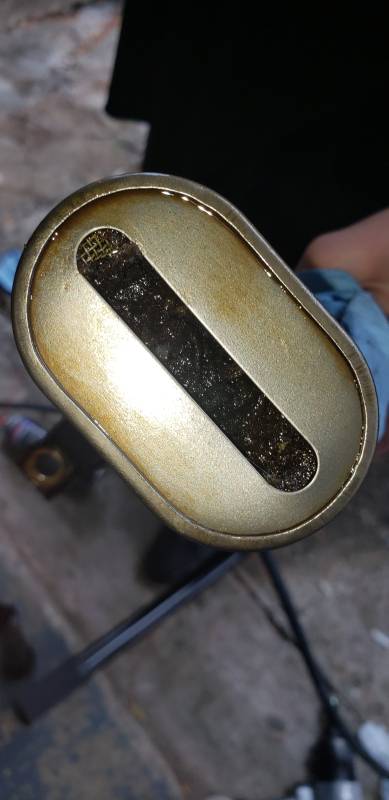

I also had a low pressure issue on my 05 tahoe, i replaced the oil pump 2 days ago with a gm oem pump thinking the melling pump i had installed 3 years ago was bad. Come to find out when i go to turn on the tahoe i still had really low pressure, so i decided to remove the pan and found the pick up tube screen was clogged with what im suspecting is some sort of mesh/paper from the ac delco oil filter i was using.
I still have the truck on jacks since the dealership/auto parts store is closed on christmas.
Hope this helps. Good luck.
Hope this helps. Good luck.View attachment 212875
Sent from my SAMSUNG-SM-N920A using Tapatalk
WTF? Geez i sure hope that isnt from a OE authorized filter! I use the ACDELCO PF48E. Im 59 and have never seen a pickup tube screen plugged with filter media before. That is absolutely unacceptable, send the pic to GM and see if they reply? Not for compensation but for an answer as to if this is occuring with that brand of filter.

There's no way. I have been cutting open oil filters for 40+ yrs and all oil filters have a metal perforated tube in their center. The folded filter media is wrapped around this tube. Oil flows from the outside, thru the media, thru the little holes in the center tube, then out of the filter and back into the engine. Now if the filter starts bypassing because the media is clogged, then all bets are off, but the media couldn't make to the pickup in large pieces. You would have big problems if something has clogged the filter media that badly.
My guess would be that someone has been in the engine before and left that debris in there.

^^ I have no idea, my guess was just that something from the filter broke loose and made it to the screen. I tried looking for the filter i took out to open it up but i probably threw it away last week.
This is what was on the sceen. Im the only one that does the maintanance on it since i got the truck 14 years almost brand new.

I can almost say with certainty that stuff didn't come from a filter.
The oil leaves the oil pan/pump and goes through the filter before being pumped through the oil passages and bearings of the engine. If that stuff left the filter it most certainly would have plugged a bearings oil passage and destroyed a bearing long before it made it back to the pickup screen in the pan. IMO
