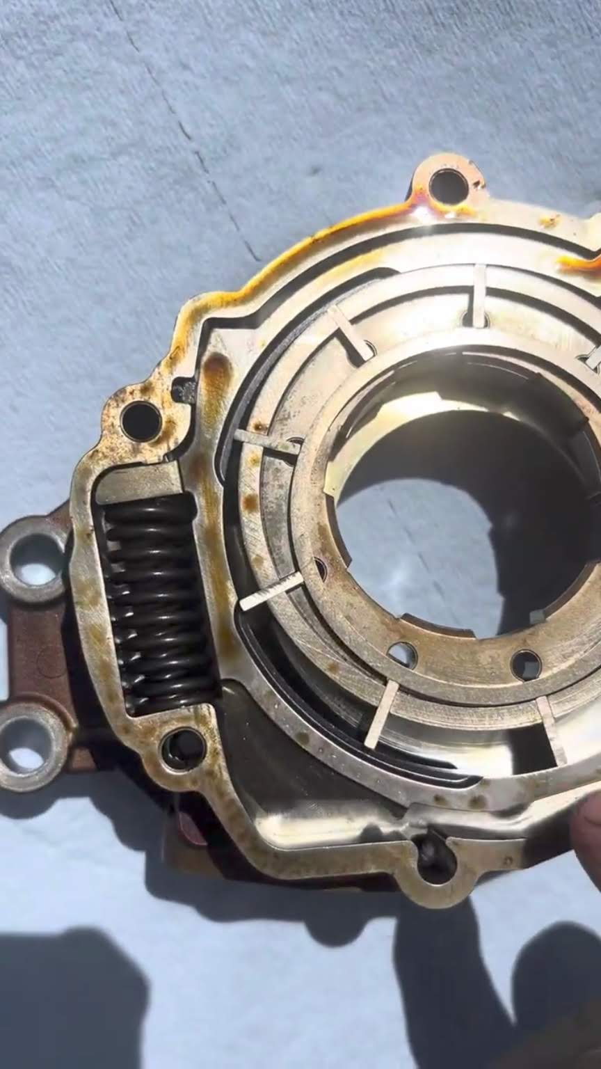

Does anyone have a pic from one of these pumps opened up

if you've seen inside a normal gear pump, this is a totally different vain style. that spring in the pic is what sets the oil pressure by changes the displament of the pump.
the next Gen up trucks with the LT engine arw veritable displacement pumps but are contorted by the ecm to target whatever oil. pressure they want. these older ones being mechanial idle at max displament, but since it's a hybrid and shouldn't be idling very much, the extra power used at idle is offset by less power used at higher rpm compared to a gear pump with the small bypass ports.
