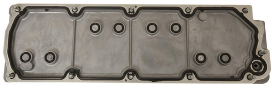

What about the O Rings on your valley cover? Why did you even replace the pick up tube? Why not just replace the o ring on the original tube?
Also I know the 07 L92 doesn’t have AFM however the early L92s DID have AFM components...LS engines with AFM used a higher volume pump than non AFM LS engines...the AFM pumps use a thicker gerotor with a larger OD than the 12586665 standard volume pump. The AFM pump is identical to the 12571885 high volume oil pump but uses a different spring...try part 12612289
Also I know the 07 L92 doesn’t have AFM however the early L92s DID have AFM components...LS engines with AFM used a higher volume pump than non AFM LS engines...the AFM pumps use a thicker gerotor with a larger OD than the 12586665 standard volume pump. The AFM pump is identical to the 12571885 high volume oil pump but is uses a different by-pass spring...try part 12612289
I replaced the pick up tube because it was cheap and easy to replace with the engine out. I also did it to help ensure I had a 100% clean pick up screen, and to make sure I had the right o-ring.
Hmmmm I don't recall o-rings on the valley cover, and I didn't snap any pics of it when I had it off. Although I know my valley cover is different( ie flat) since I dont have afm. I think you may be confused, I know they later added afm to the L92 without other modifications, but I dont think my engine has any of the afm components in it. If there are o-rings on the valley cover that I missed, i could see that being a problem since the main gasket is new, the old o-rings would probably not make a good seal now. Sounds like a good thing to check since I would need to pull the intake and valley cover to install my lift plate if I end up pulling the motor again anyways.
Not confused at all....it’s a fact some early 07 L92s had AFM components even though they didn’t have AFM active...the 6.2s that had AFM active are the L99(Camaro) and L94(2010+ Escalade and Denali SUV)...I bet if you went back to your original pump and pickup tube you would be back to normal oil pressure...and the Valley Cover has 8 O-Rings that block off the AFM oil ports(present on all Gen 4 LS), if they aren’t sealing this could also be part of your problem

Also the fact you mention you replaced the oil pressure relief valve is another indicator your engine may have AFM components...that valve is used to bypass excess oil pumped by the high-volume oil pump when AFM is not active....if you install a standard volume pump without deleting the oil pressure relief valve it could cause low oil pressure

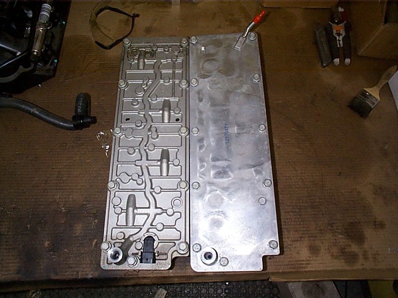

When comparing your valley cover to the pic below does it resemble the one on the left(AFM Style) or right(no AFM)??
