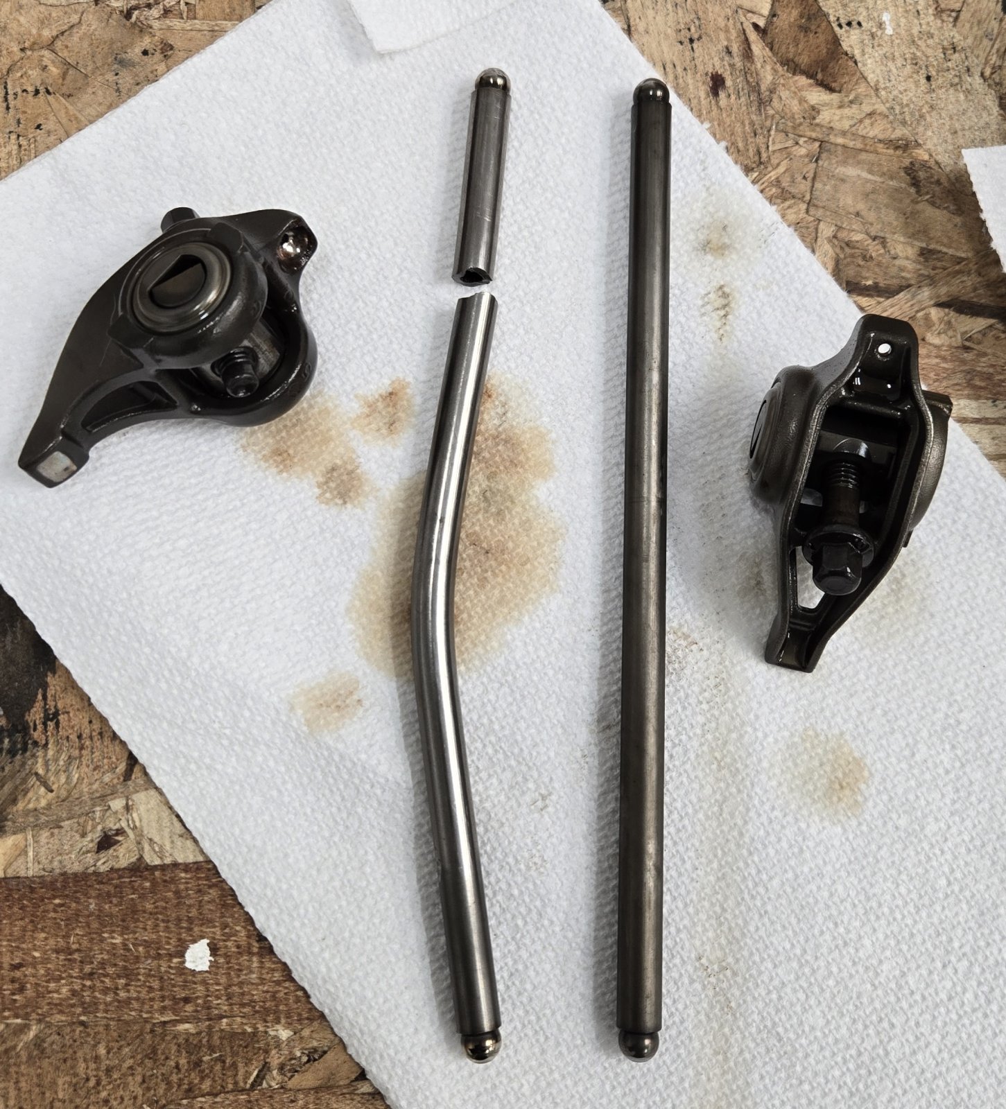

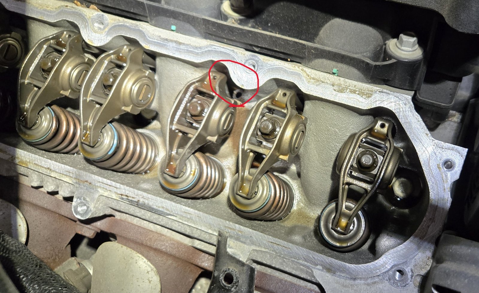

I have a 2018 GMC Yukon Denali - with 68k miles on the 6.2 L86 engine and the 10 speed transmission. Collapsed lifter just bent and snapped a pushrod. Looking for recommendations for shop(s) or technicians around Minnesota who can and have performed the complete DOD AFM delete.
Also question for anyone who might know: Is this push rod for the for the exhaust or the intake lifter for cylinder #4? Is this an AFM or or Non-AFM cylinder?
Thank you!
For your enjoyment, I will post photos of my misfortune. Please let me know if I am heading down the wrong path here - I have seen people with bent pushrods but not many snapped off ones and I am wondering if that makes a difference. I'll do a full write-up soon and post it for others to hopefully learn from my experience.
Pushrod snapped off toward the top - partially visible.
Broken push rod off of the right side of cylinder #4. (2nd cylinder from the front on the passenger side)

I am sorry this took so long for me to get an answer to you. I brought mine to Doug Rippie Motorsports in Waverly, MN. The actual repair cost will depend on if your engine is already damaged or not.
My engine was actually not damaged yet other than the broken pushrod, but since I turned off the engine right after it happened I was lucky. In my case, the DOD delete using the BTR (Brian Tooley Racing) can and dod delete kit cost a total of just over $7k.
I did speak to others and so I know of a few other places that offered to do it. I do not regret having this done and Doug Rippie Motorsports is a great place to have it done except it's a 1 man shop - Todd - and he's very busy so it took a few weeks for him to get to my vehicle. Todd is the most knowledgeable guy on this topic I've ever met and he specializes in GM V8 engines.
