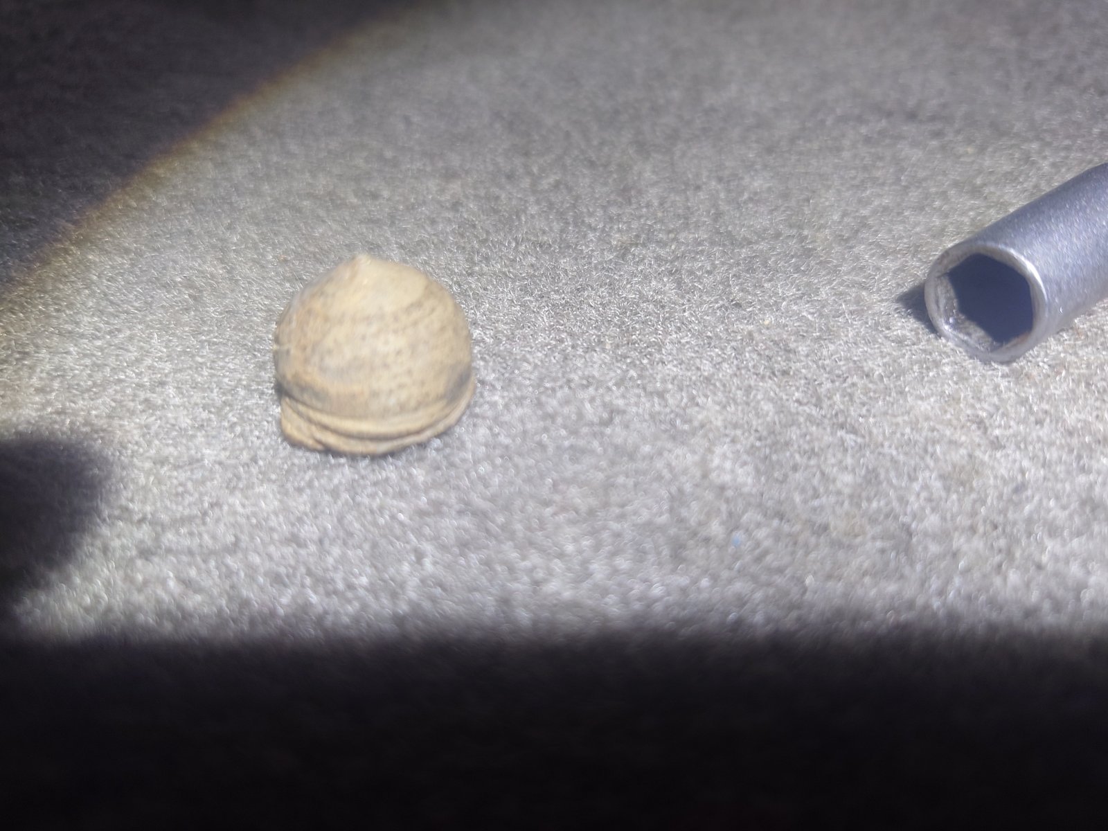

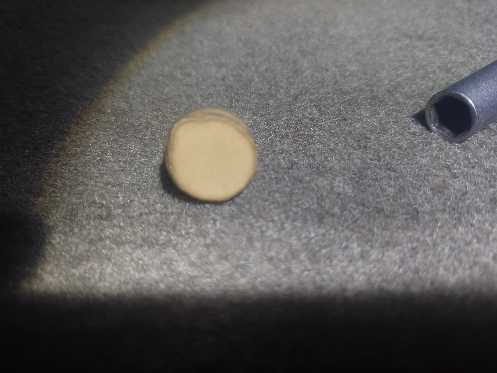

I disassembled, what brought me more in love with this car. It was very easy to remove the cover and when I looked at the problem there was a strange part, which was stuck in the right lock.
It looks a bit like a half nut from an oak, but can be a piece of glue as well. Obviously it fell down and landed exactly in the lock...
