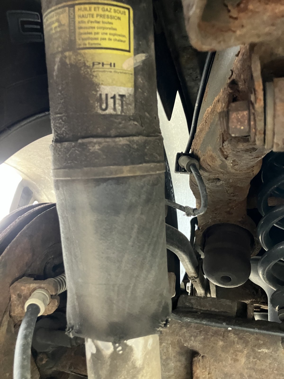

I can't get the pics yet but the Driver's side rear shock had 3 less than half inch "tears" in that outer fabric material

that is my thought as well...but the rear is at least as high as it was prior...no compressor activity...
tears near the bottom the my attached photo - you'll need to open to see the full pic see below

placed here...pic of driver's side rear shock...you have to open the jpeg to see the tears...

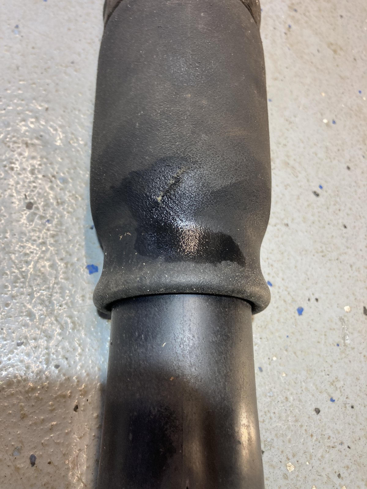

These trucks sit high even wo air assist. Its when you load them w a camper like I do that they sag if not for the air lift. I saw your pic, the shocks are toast. One of mine had a small tear, see pic
