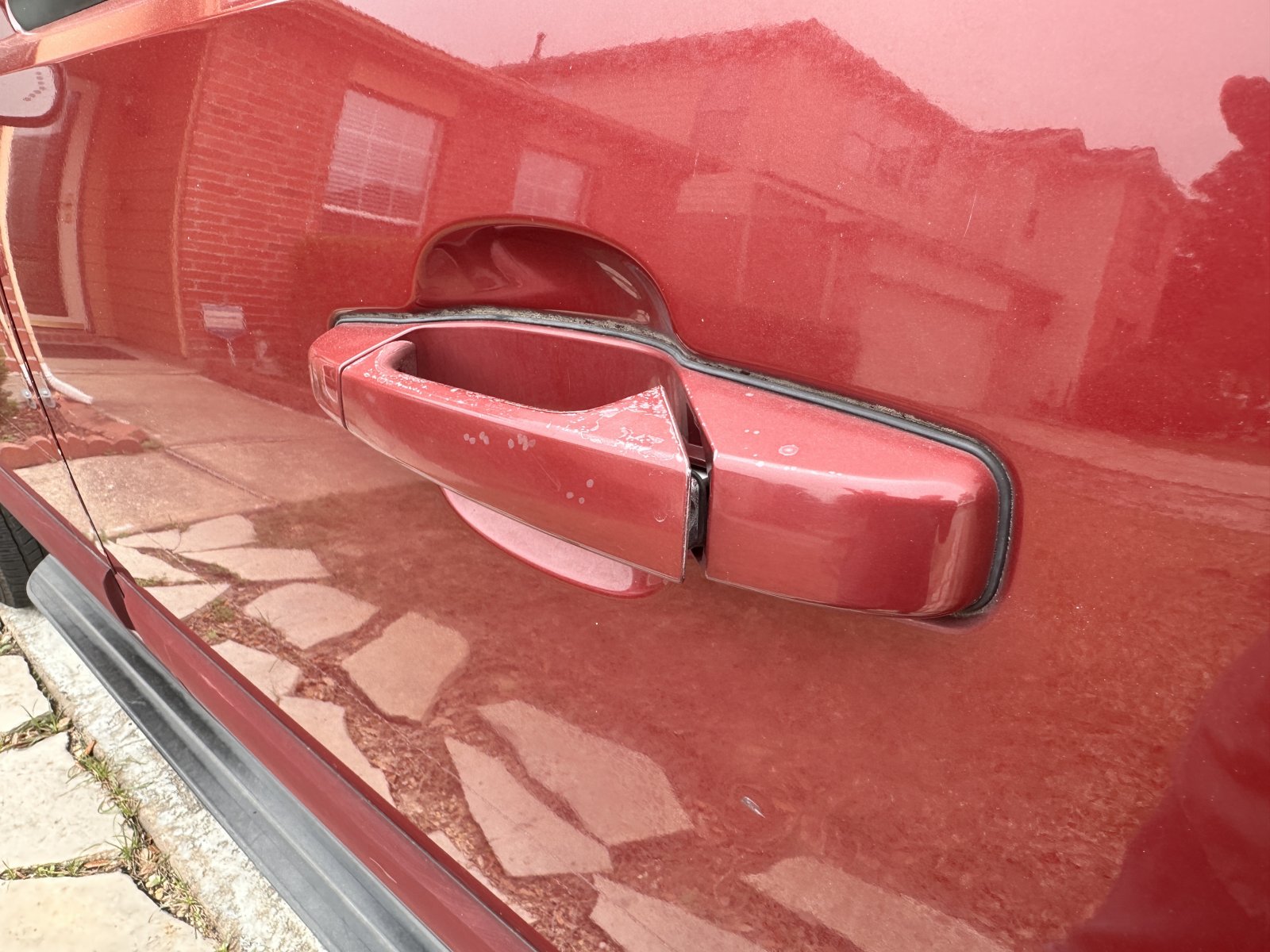

Thanks, I will try that. I have to replace one door handle before I go to paint, So I will jump in there and do that. So I shouldn't have to replace the actuators? Currently this is my driver's side rear door handle and how it sits.
applying lubrication may or may not resolve the problem, it certainly couldn't hurt.
as mentioned though it could also be voltage related, a weak battery or perhaps a poor ground somewhere in the mix
if the battery is a unknown age or is more than 3 years old you might want to have it tested, clean up the battery post's EVEN if they "look ok"
another thing to clean is the mega fuse connections on the firewall, take the fuse off and wire brush all sides and connectors.
these trucks do weird things when the voltage is not up to *****
if the battery test shows it to be "borderline" then perhaps consider a new one.
