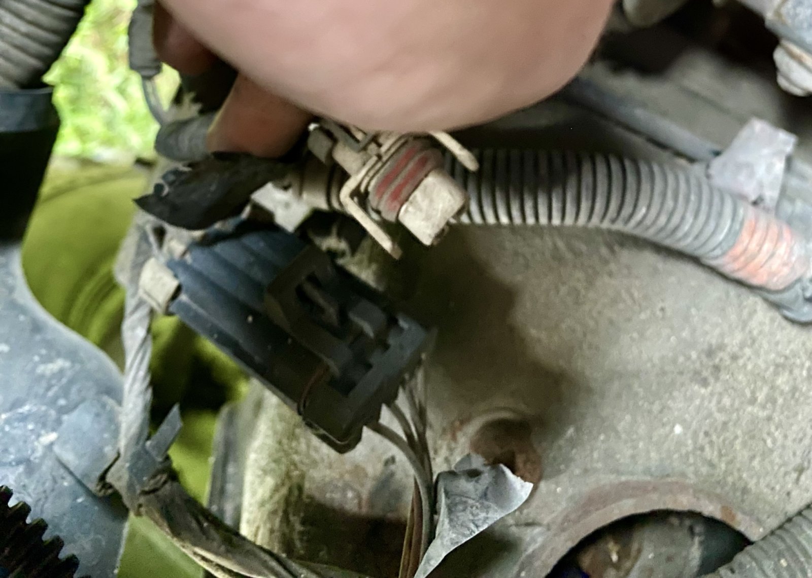

it might be to either the ride height sensor or the shock or abs sensor, I don't recognize the plug off hand check all around the general area
interesting.i definitely will here directly. here is nothe plce it could go, just by sight and feel
well.....i might have found my vacuum leak, lol. the airbox doesn't have the rubber grommets & wasn't in in the holes properly. map sensor, & more oem stuff & run live data again, later. will take more videos.
