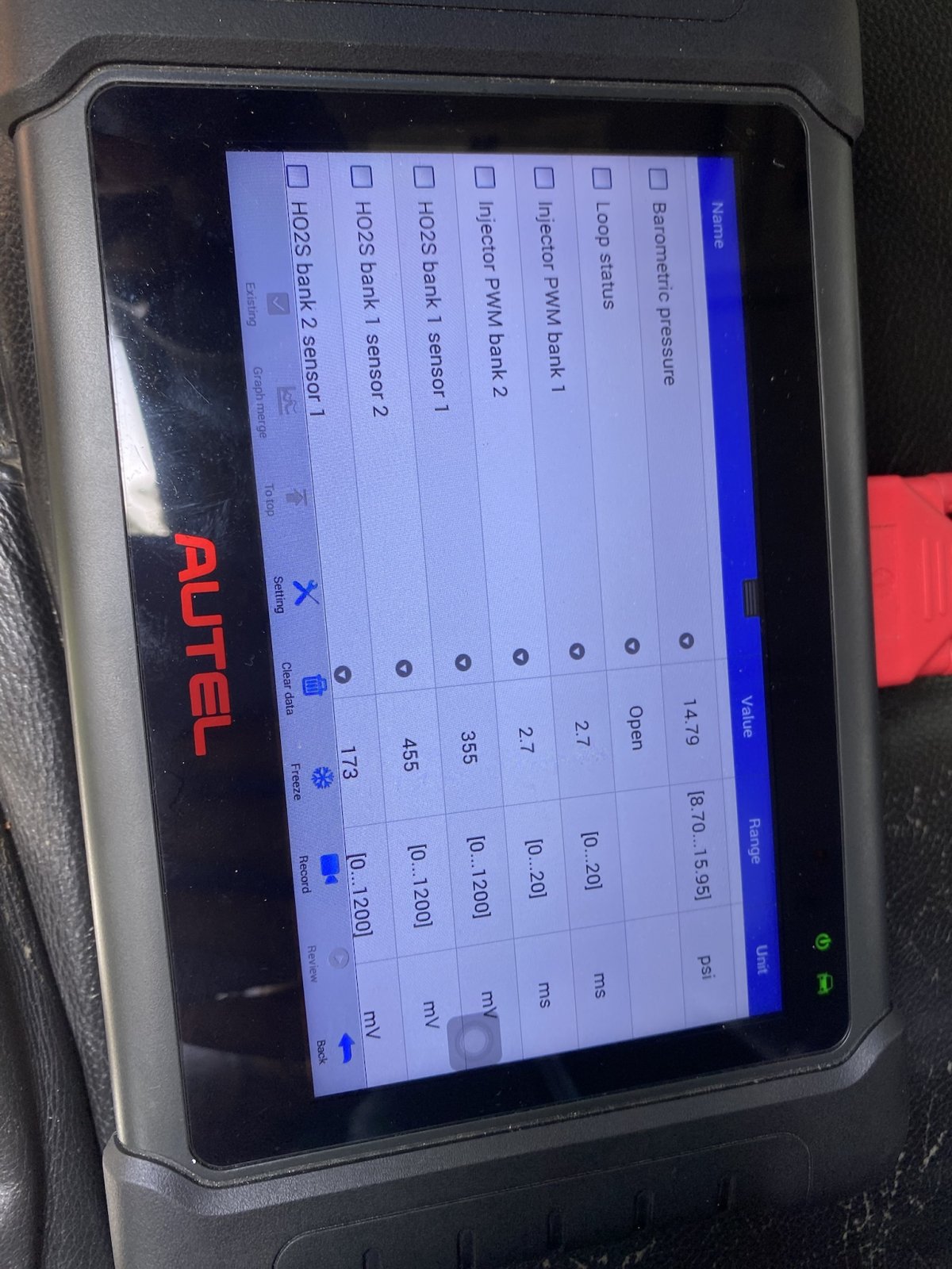

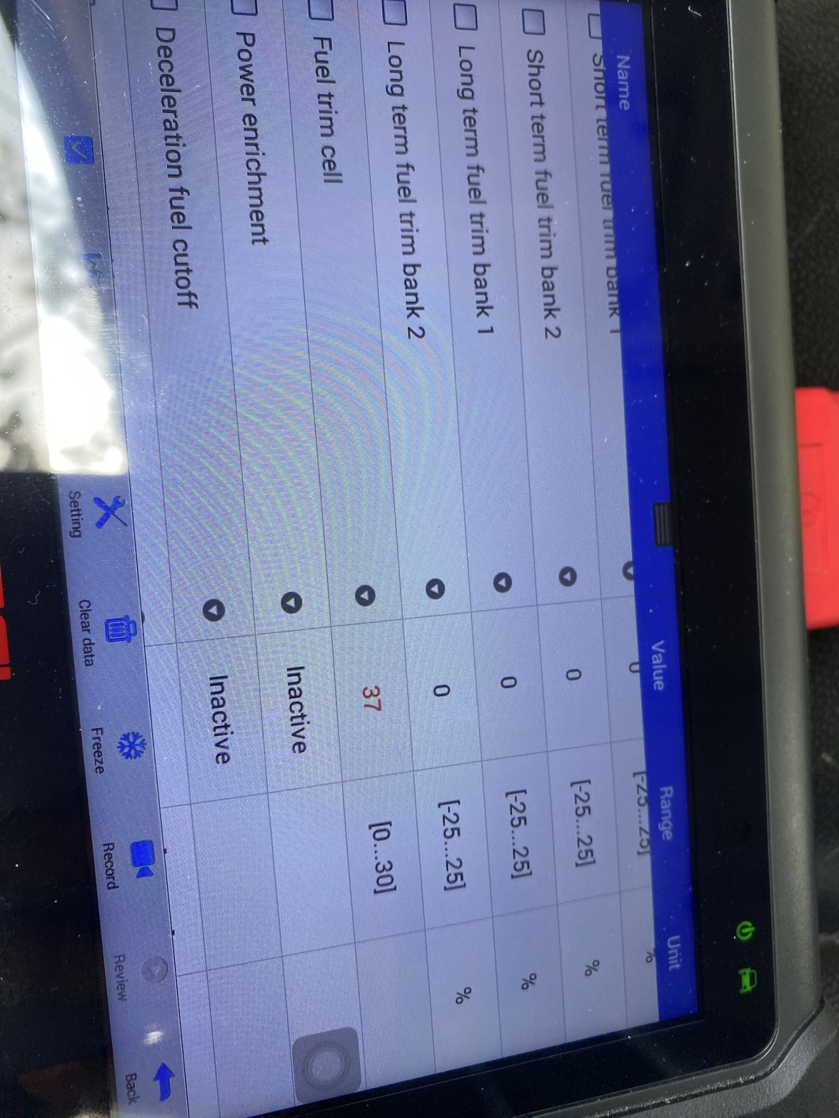

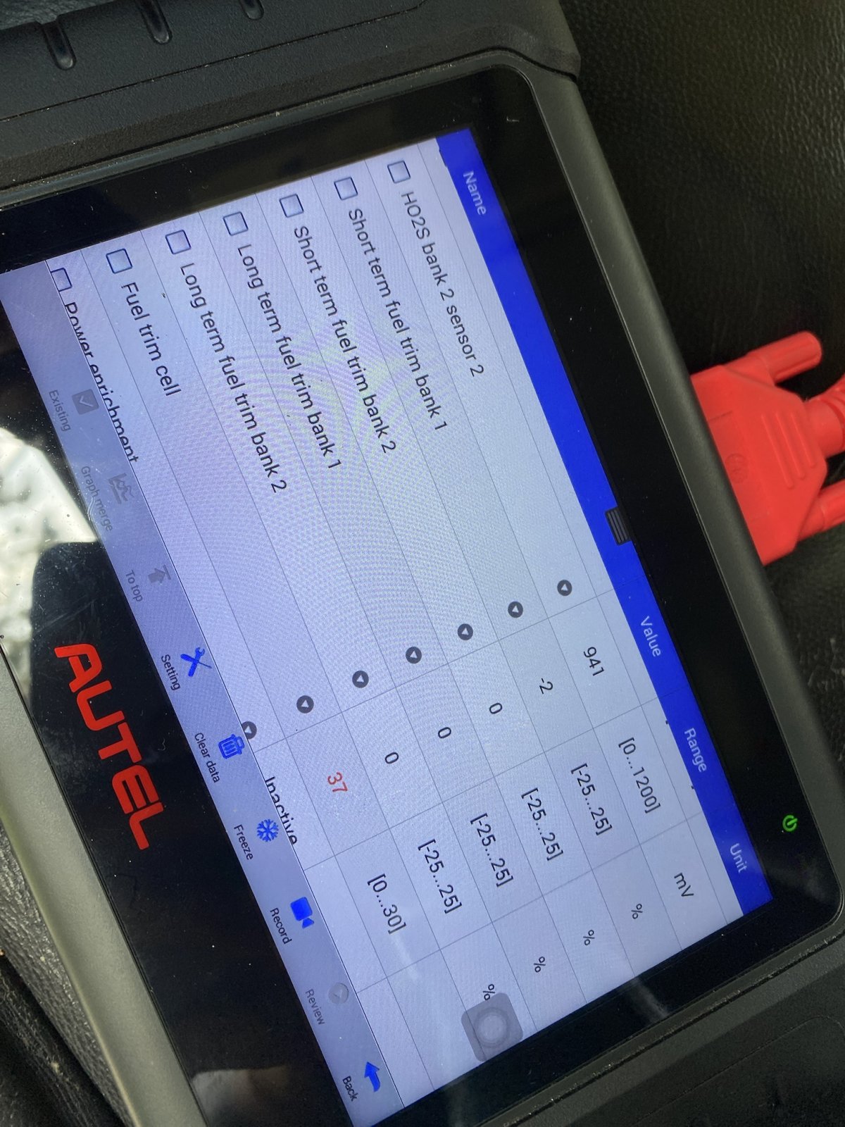

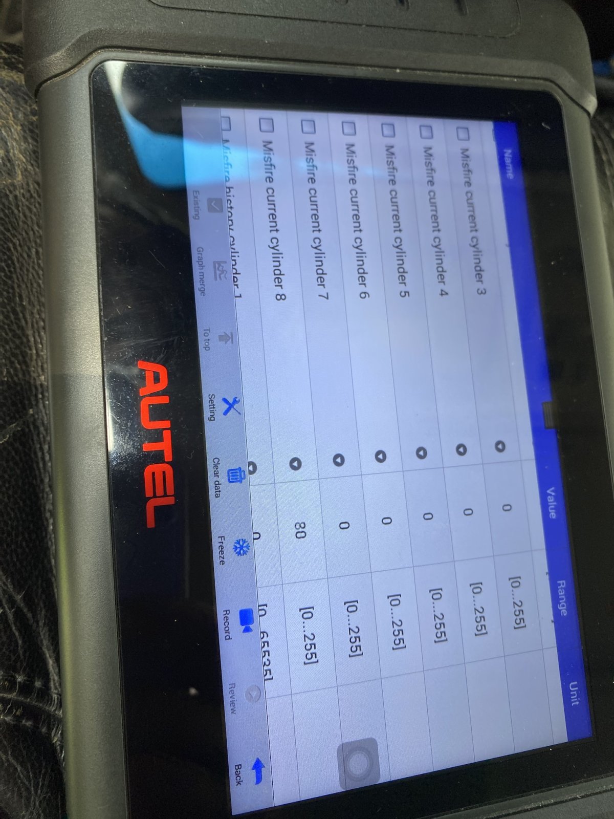

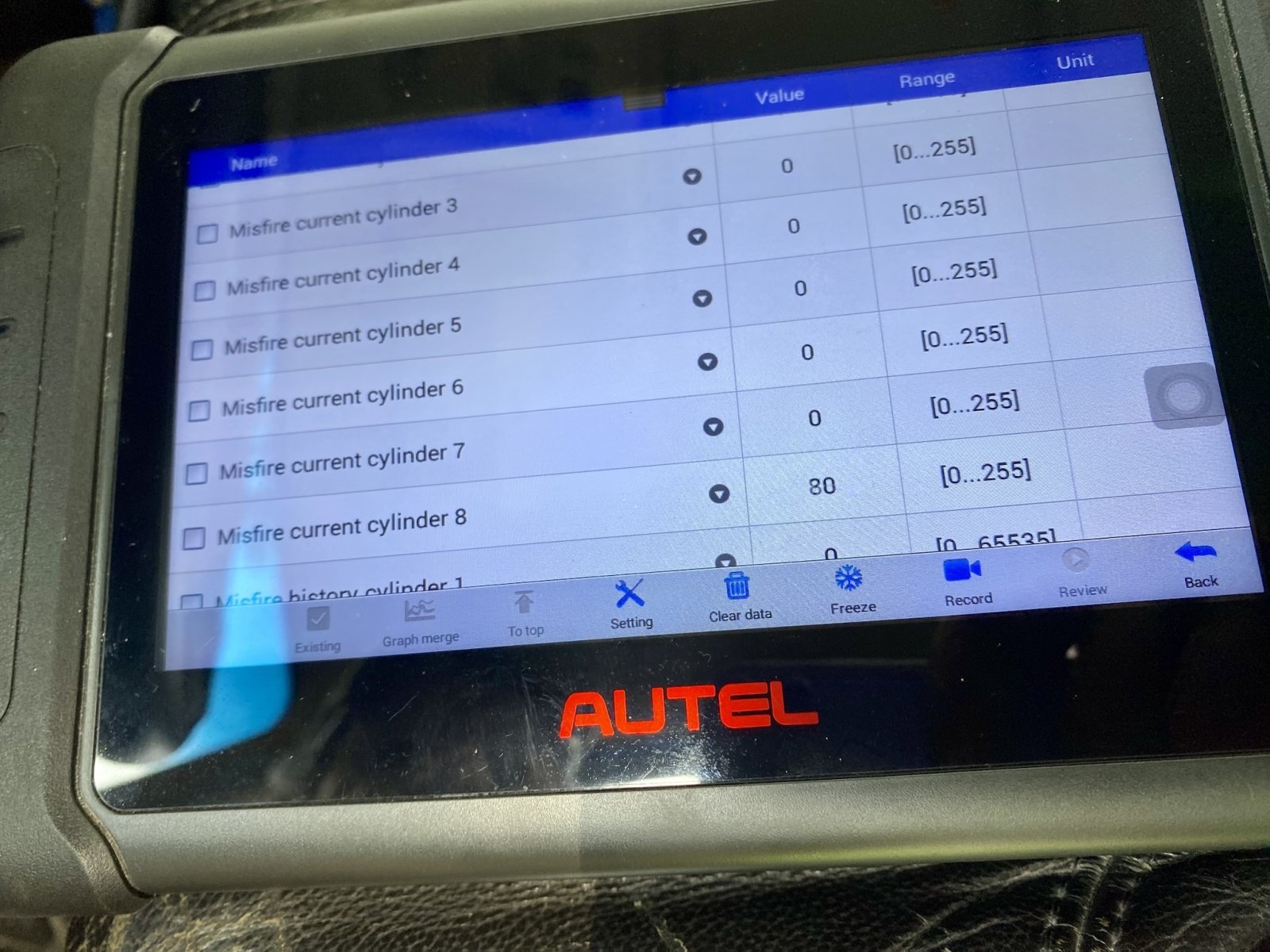

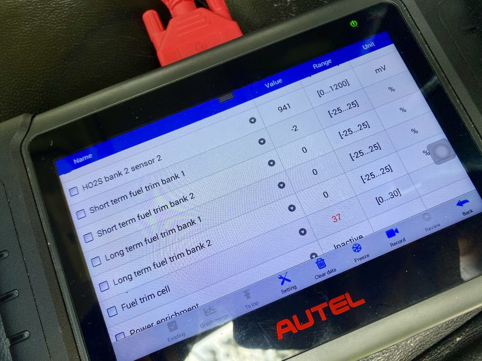

live data dump. what do YOU see?
Jul 9, 2026
95
88

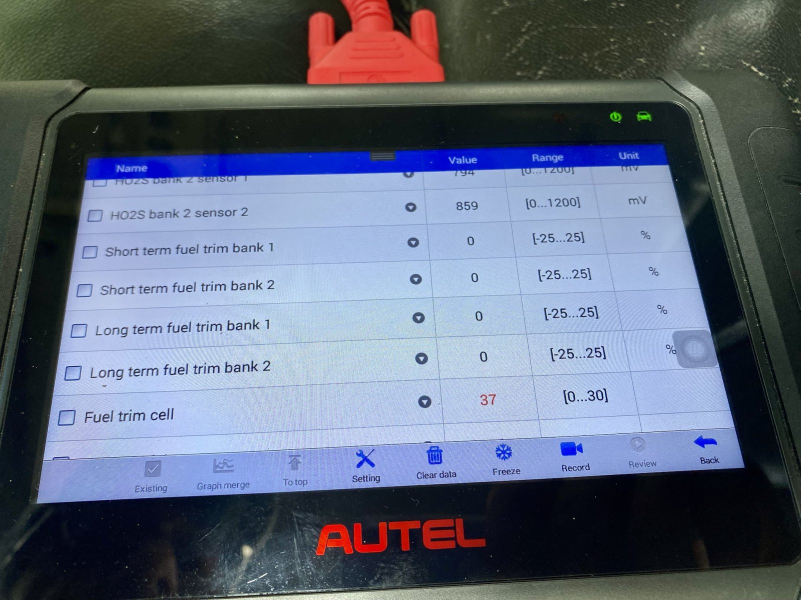

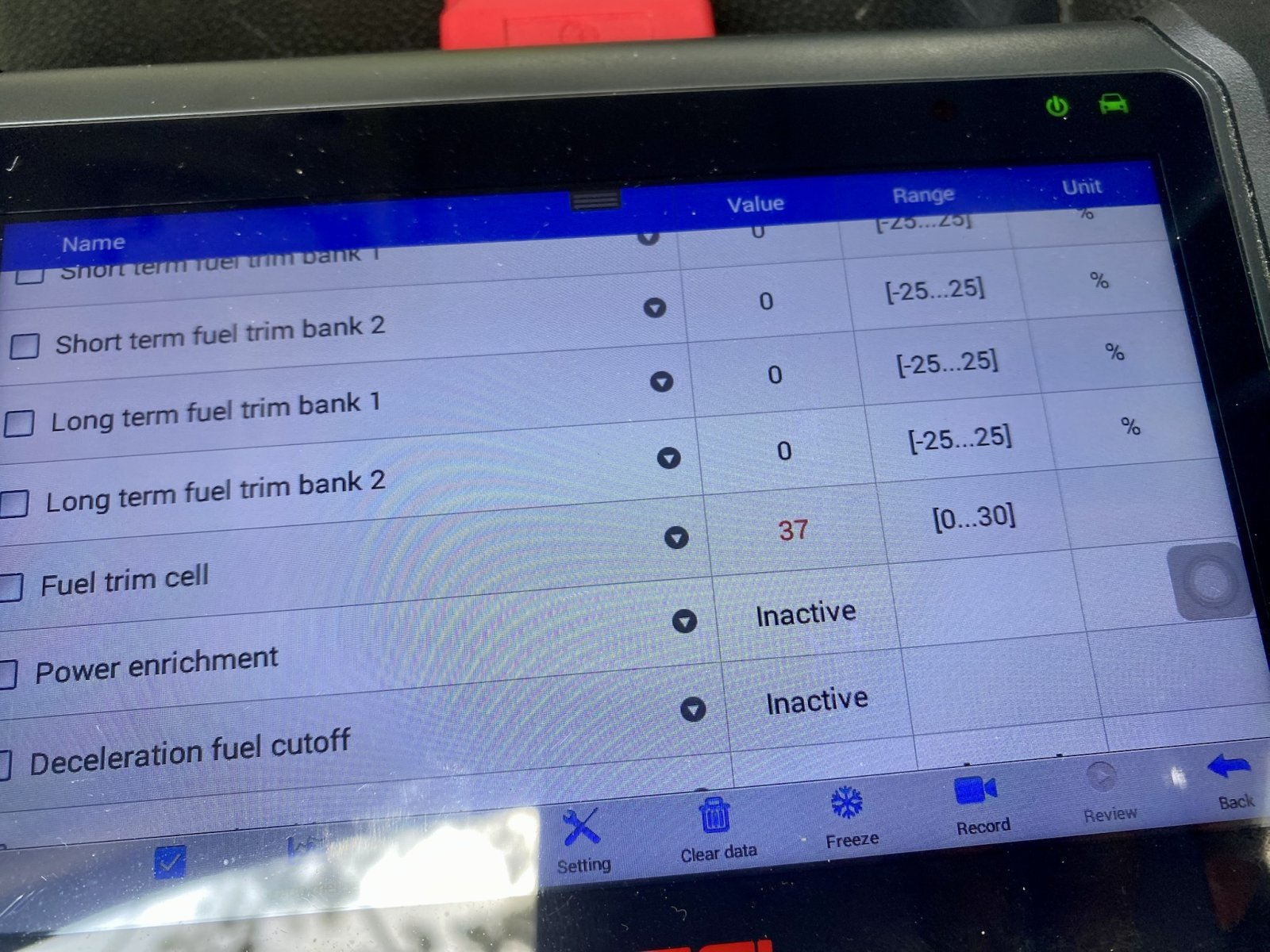

at idle, the trim cell stays at 37, but under load (2k rpm+) it clears right up and stays normal.
New parts this week: MAF, Plugs, Wires, Coils, EVAP under the hood, EVAP canister in the rear, all o2 sensors (i can only change 3 of them, because when they stole my cats they cut it off to the point where i can't get to it to do anything with it)
i dunno if people say it enough, but thanks to all of you who take the time out of your day to help people with these things. i'm a fisherman, but learning to be a mechanic it seems lol. seriously, freaking thank y'all.

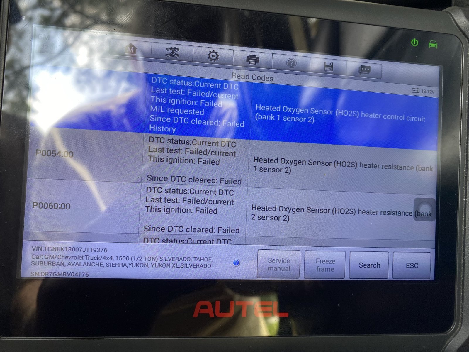

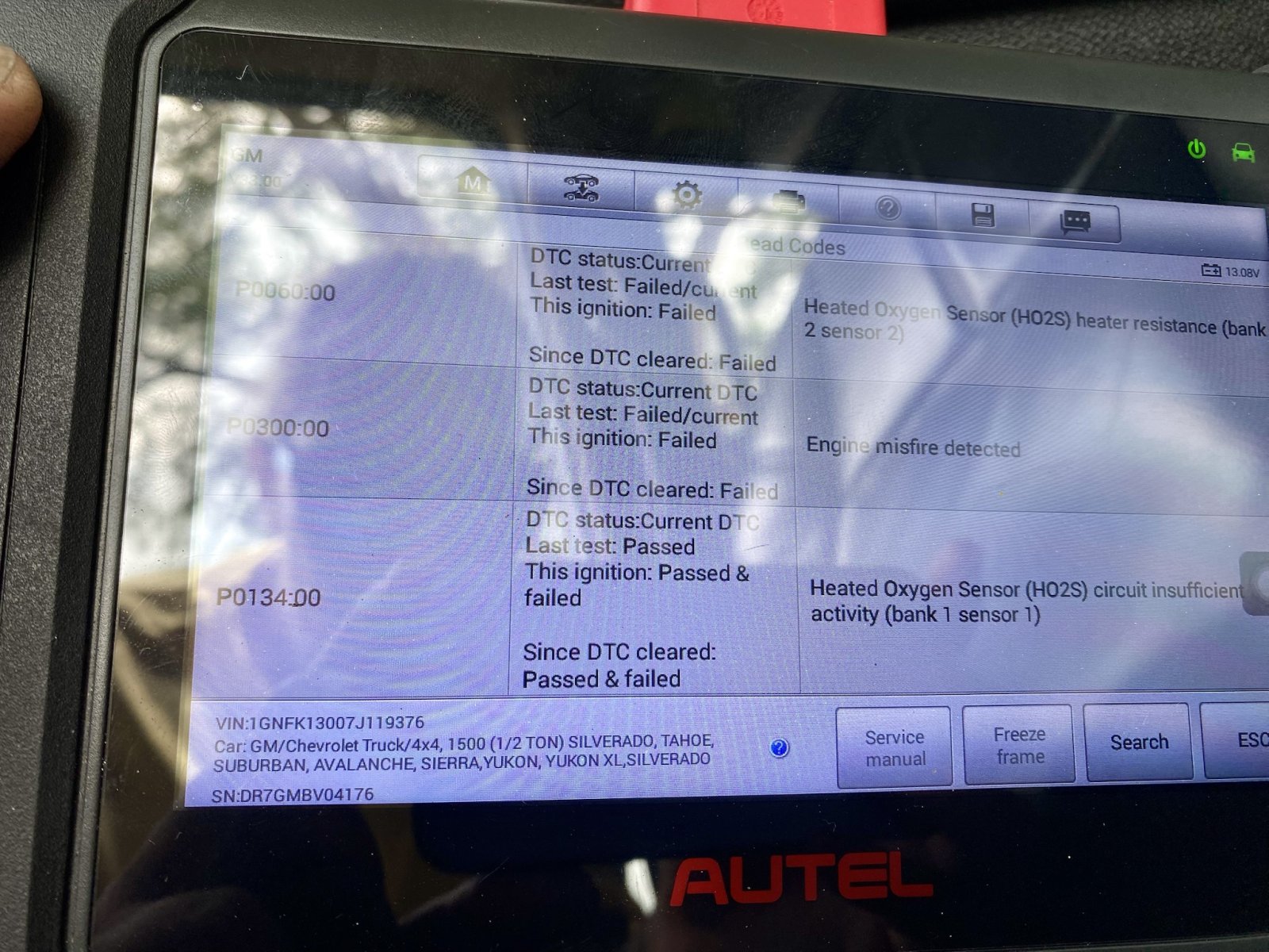

codes:

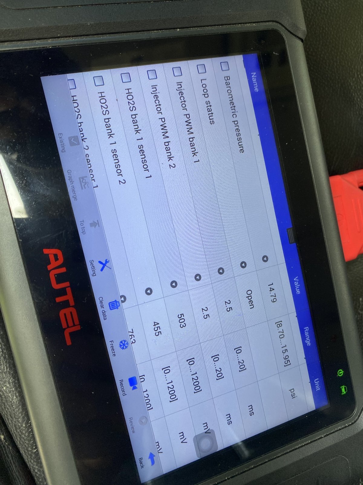

live data:
going to switch 6 and 8 around (coil packs & wire) to try and rule out hardware. again, at 2k rpm everything clears up perfectly.

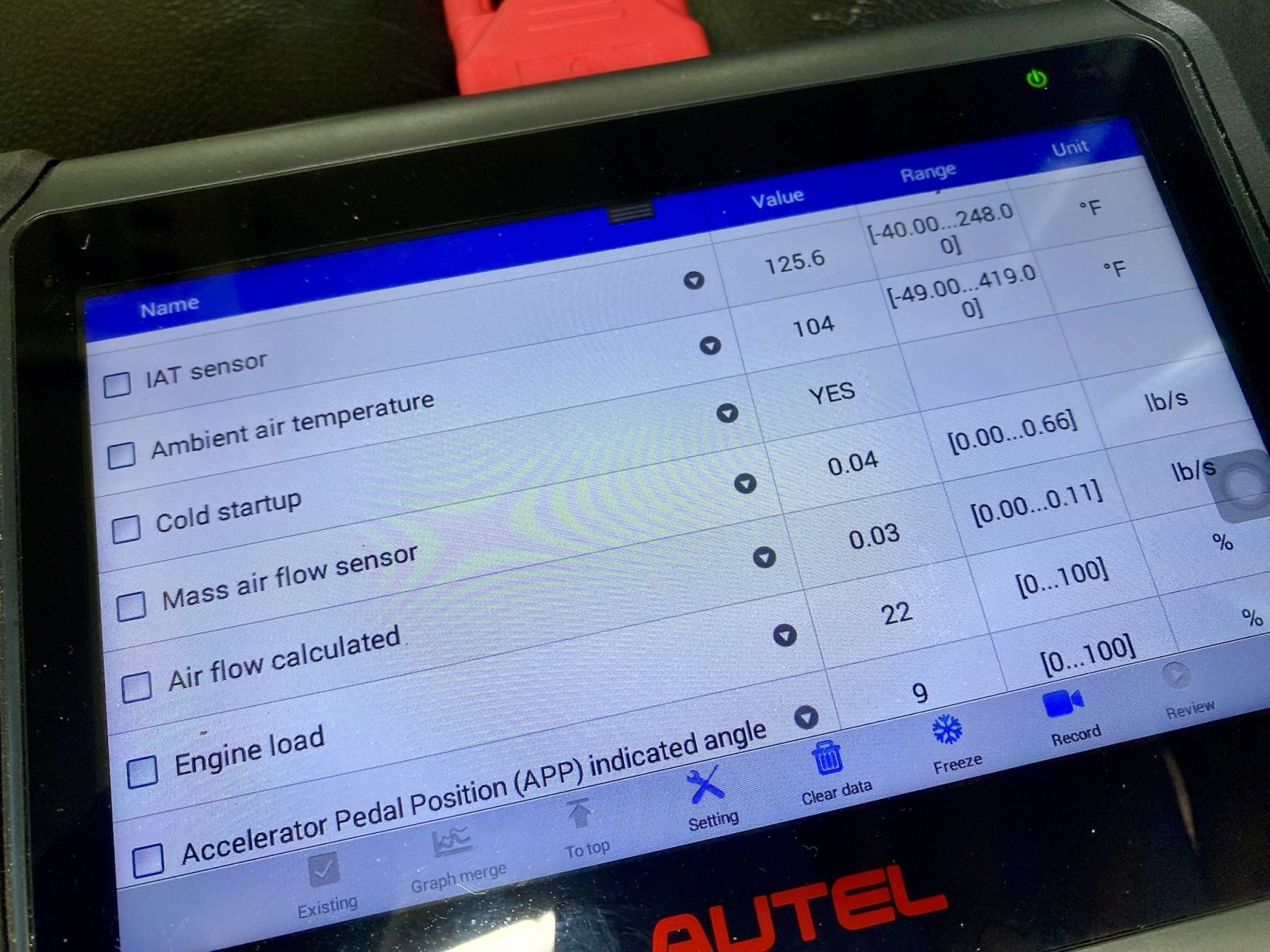

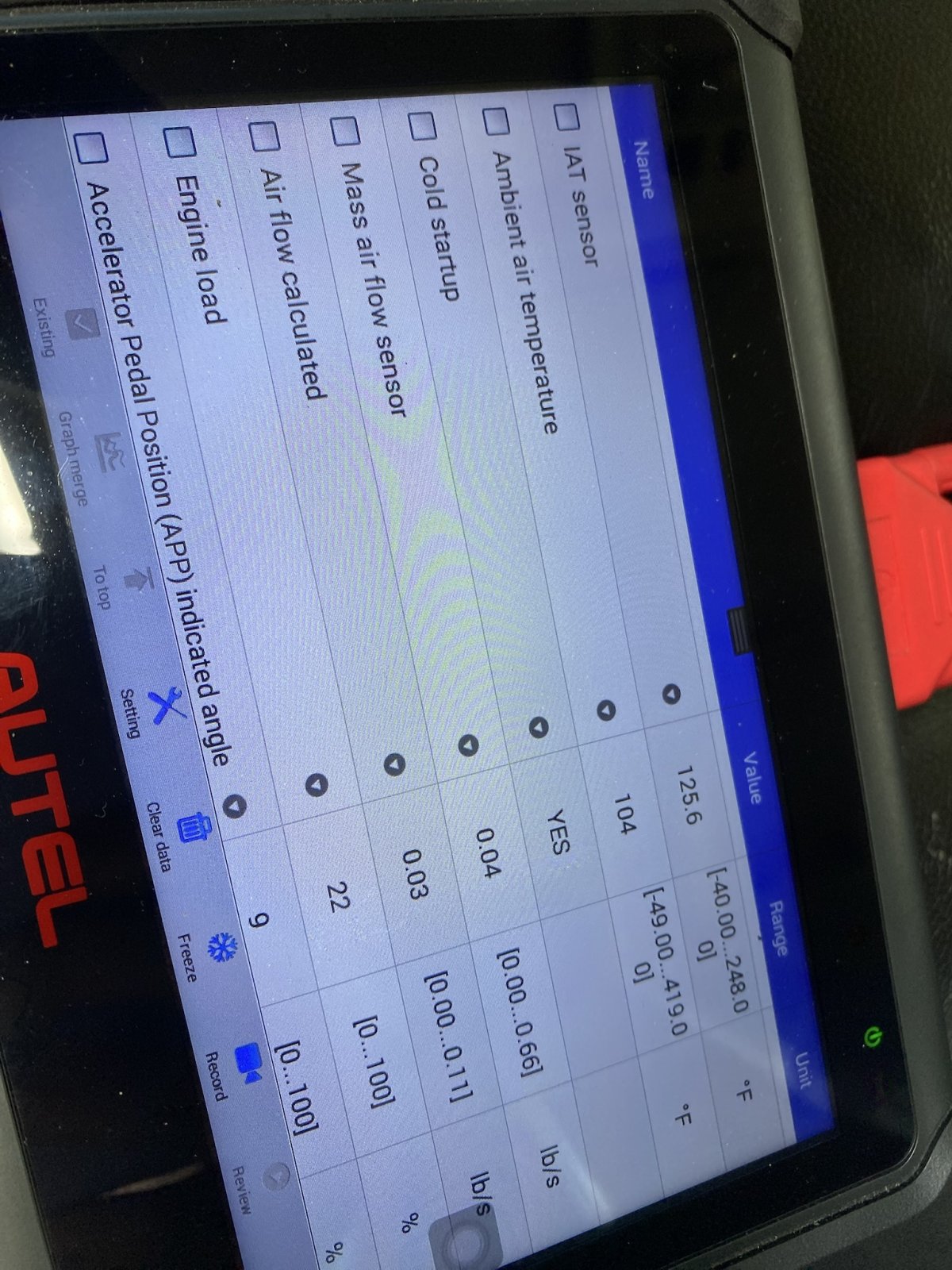

MAS air flow needs to be changed to grams for me to read it.
What is your AAT and IAT cold after sitting overnight.

IAT and Ambient should be very close to the same when cold after sitting overnight before you start it.
MAS should read around your engine size in grams a second when hot up to temp and idling between 550 and 600 rpm

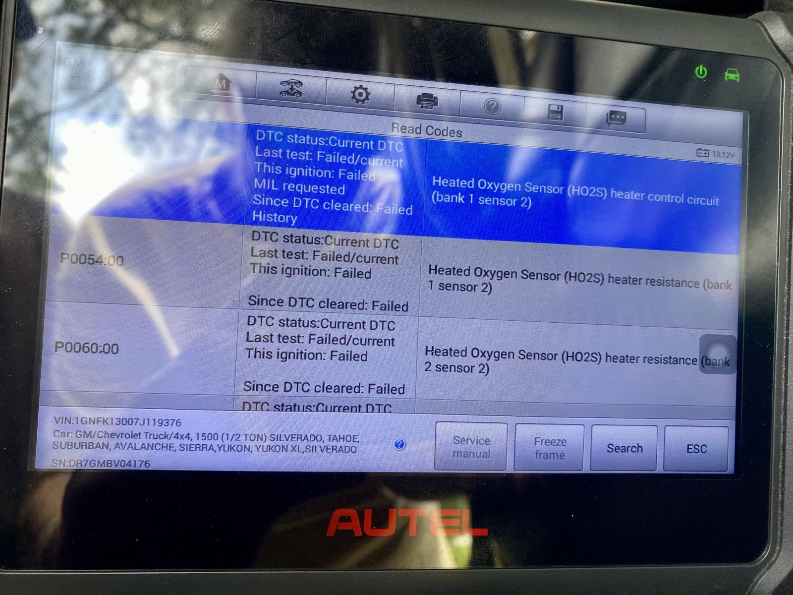

Check fuses under the hood for heated O2 sensors. I think there are 2. I don't know what the default is if blown but it looks like either the sensors are not getting power to the sensors or non heated sensors were installed.

And now, besides the obvious mis-fire on cyl 8, what's the specific complaint?

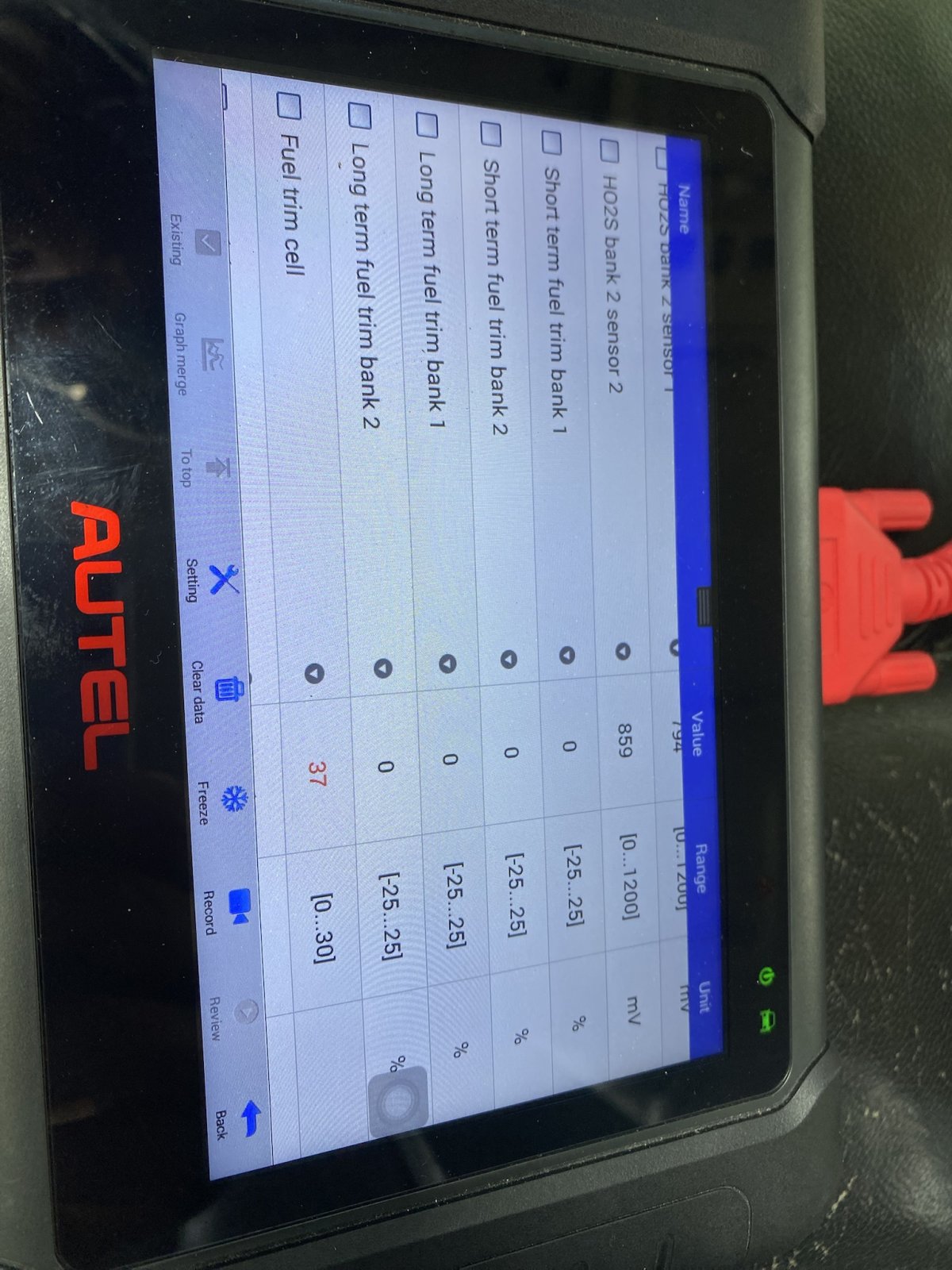

Lean on idle that improves (especially if only one bank) points to a vacuum leak.
I didn't see all the data, some of it had glare. Just post the values at the rpm.

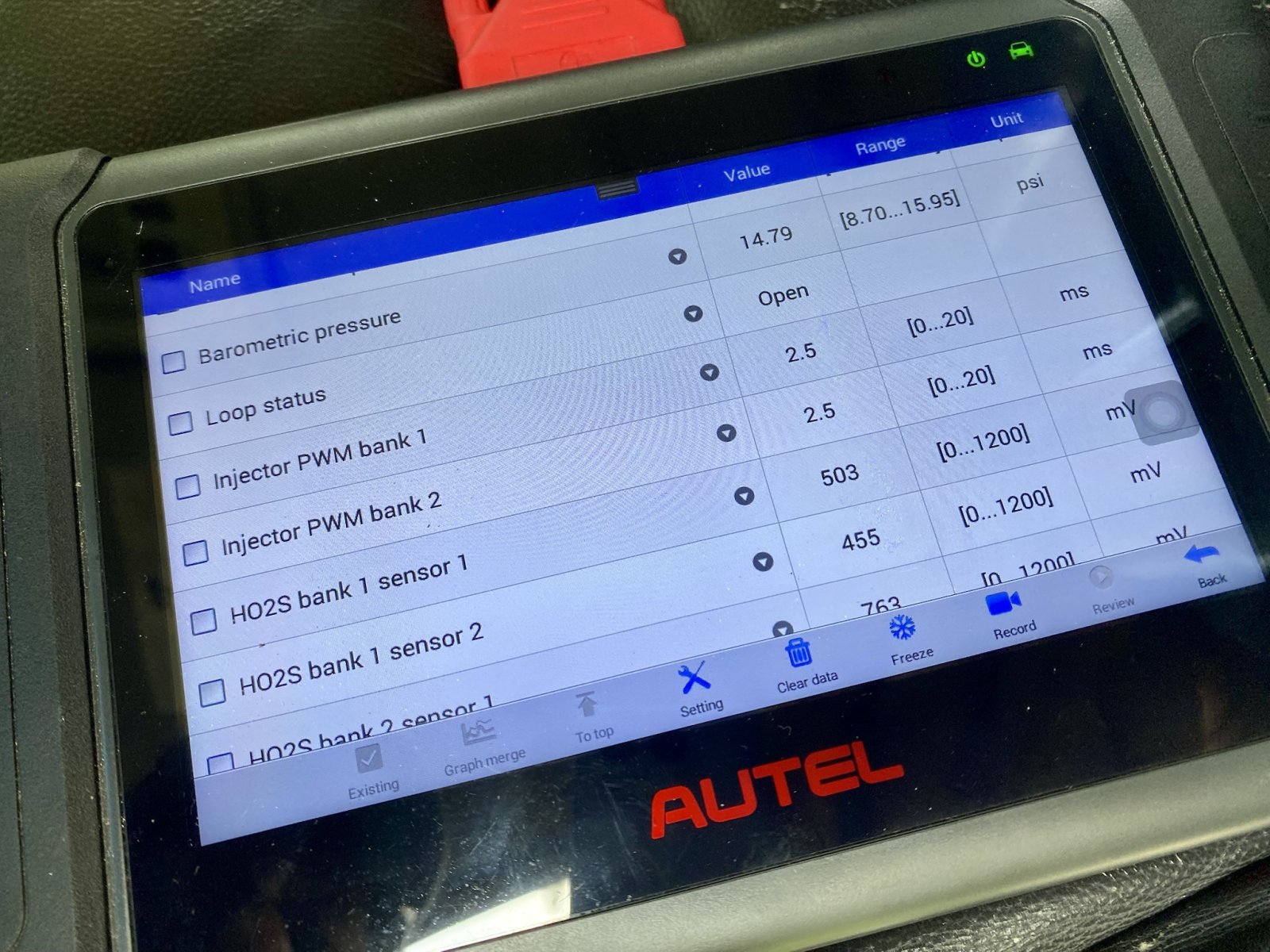

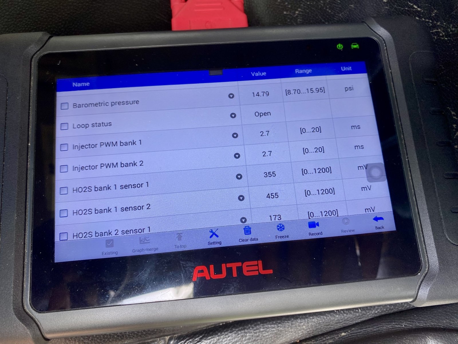

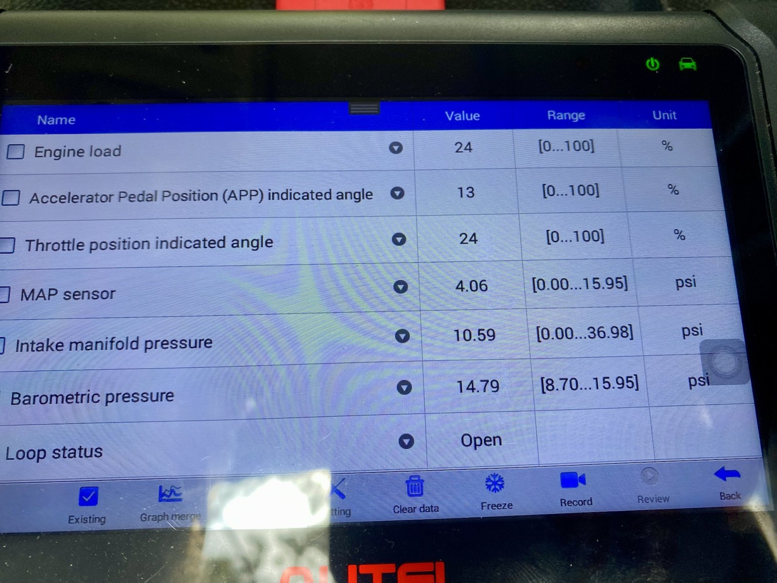

I didn't see rpm in any of those pics, although my neck hurts and I may have missed it. None of the pics show that the PCM has fuel control (it's in open loop) so the O2 sensor readings aren't really going to indicate anything worthwhile.

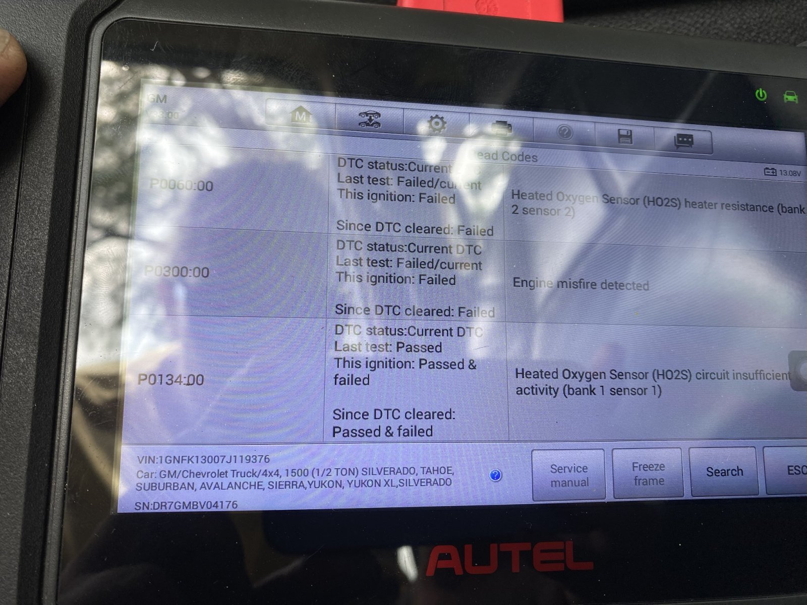

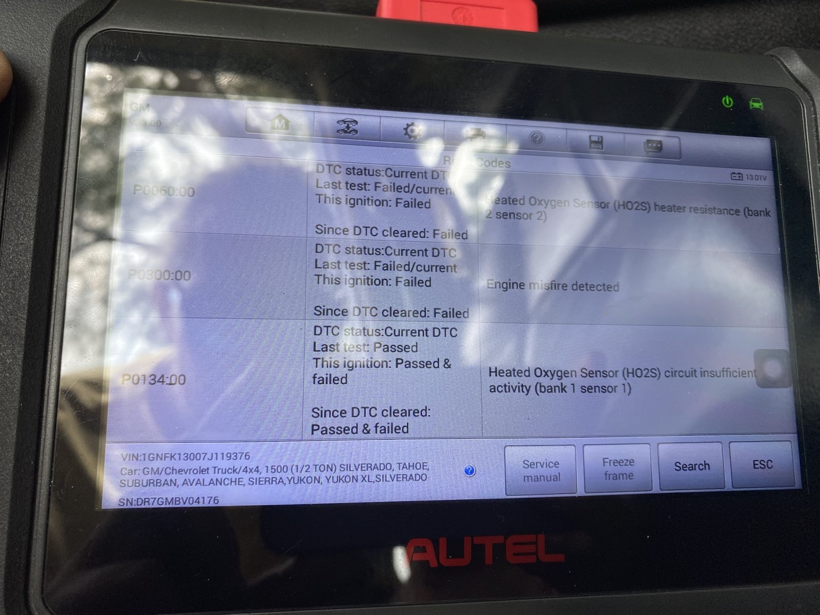

Seeing the codes for the O2 sensor heaters, do the heater circuits have good fuses in them, and is the voltage making it to the sensors?

yep, oem o2 sensors. i'll definitely look at the fuses.
gonna go check the fuses in a minute. at idle, fuel trim cell is 37. above 2k and driving it's normal.

it's running like a bad MAP would, from everything i've read about them going bad. and you can smell fuel.

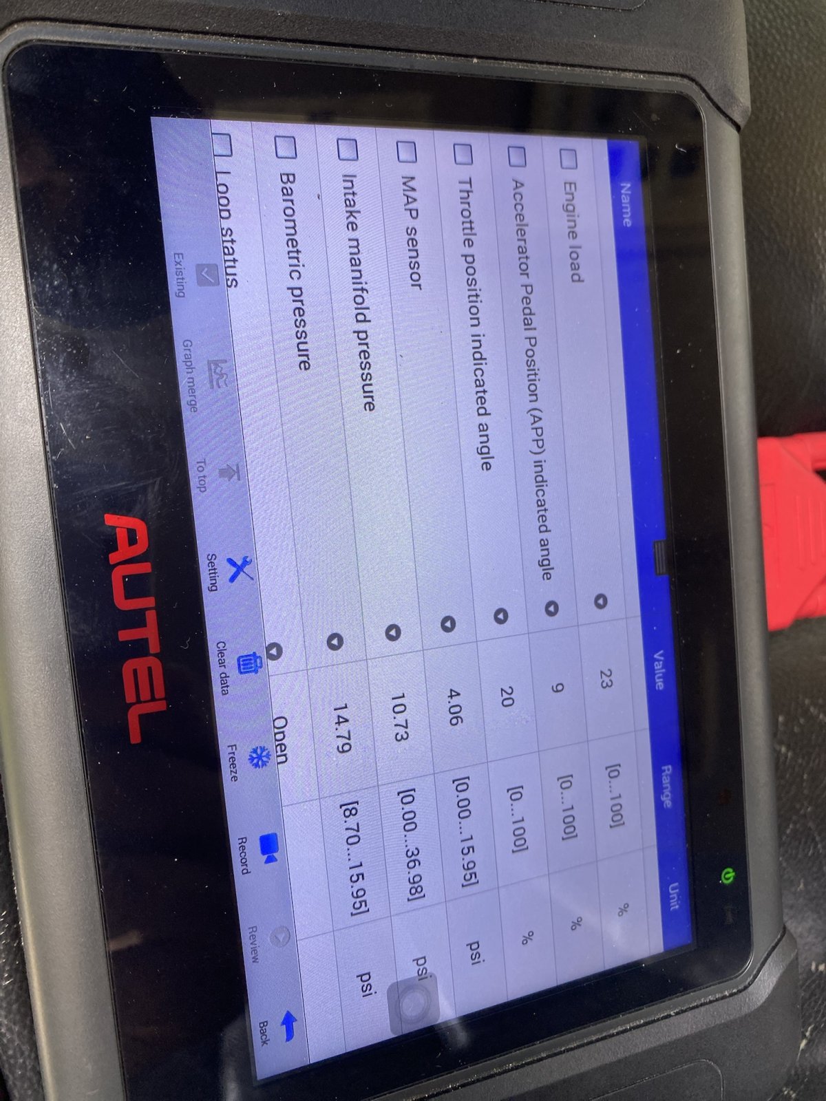

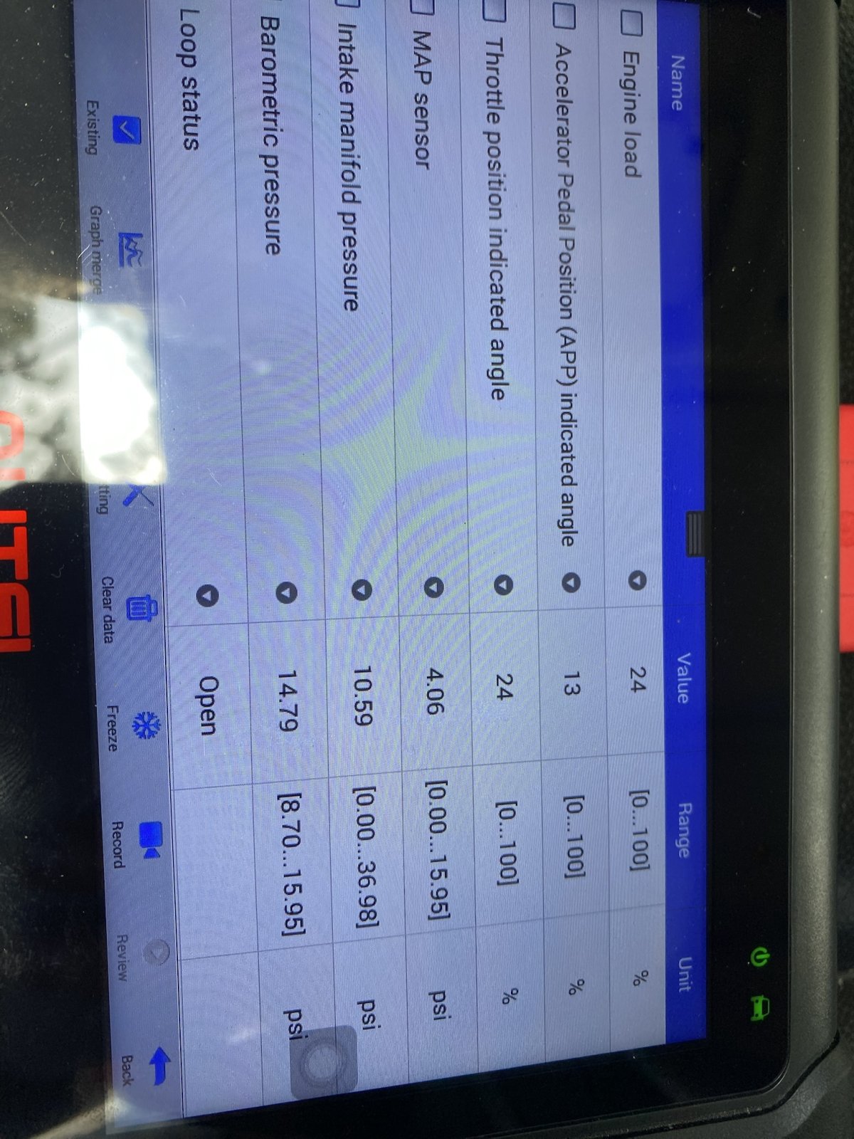

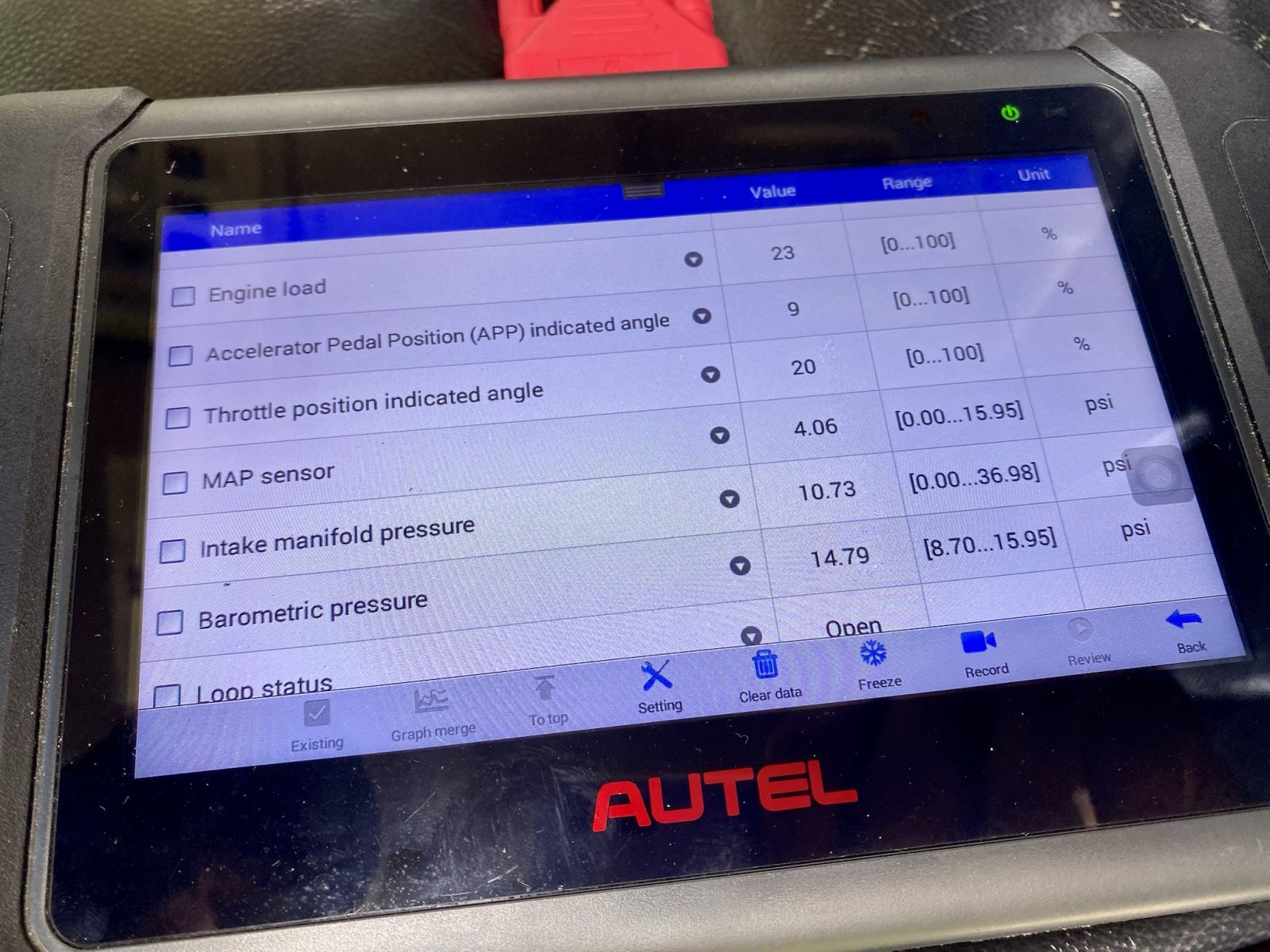

MAP says 4.06 PSI. I would like to see that at least 18 PSI or higher. Maybe im thinking in/hg

88
i'm going to get one tomorrow, worst comes to worst i take it back. i just changed the 02 sensor fuses, started it, no check CEL. runs like shit, but no light. everything i've read/watched about a bad map is exactly how it runs
psi to hg says that it equals out to 8.266

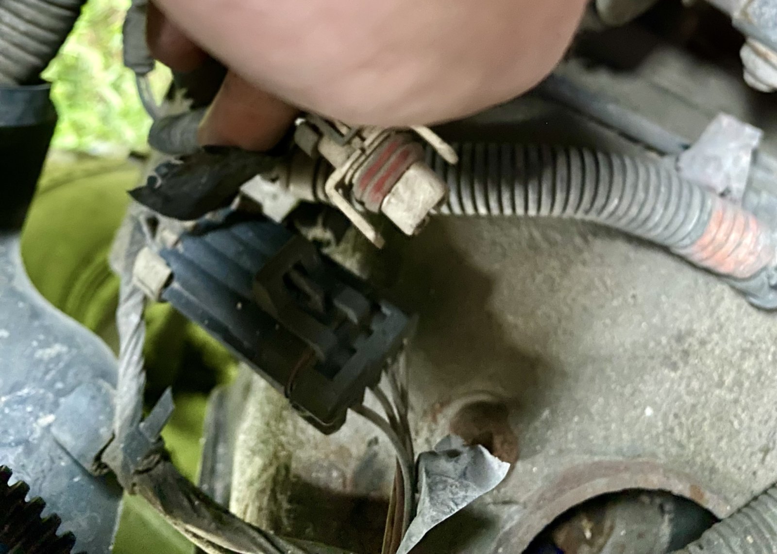

also, wtf does this connector go into? right by the front headlight. seen it swinging around. smh

What did I miss that indicates a lean condition, other than the MAF value?
The MAF reading in the pics is 0.04 lb/min, which equates to 0.3 g/sec (but, again, reading it directly in the metric standard would be most accurate). That's severely low; at hot idle (we don't know what the idle was) it should be close to the engine displacement in liters. That would indicate an inaccurate or dirty MAF, and the intake air temp issue would also indicate a problem with that particular combination sensor.

It can likely reach only so far. Move it around and see if there is something disconnected.
Also, which headlight? "Front" gives us a 50/50 chance when guessing. DS? PS?
after doing some research, it's gotta be unplugged from the ******* pcm? WTF!?! that's the literal only place it'll reach. if you're looking under the hood, right below the light. there's 2 holes that i could FEEL it would only go in, and then it got dark.
that MAF sensor is brand new, x2. brought the first one back, tried this.
running lean, or rich? because all you can smell is fuel
also w/ the temp, the truck had ran for a literal minute until i cut it off again. drove from my house to 1/5 mile down the road.
