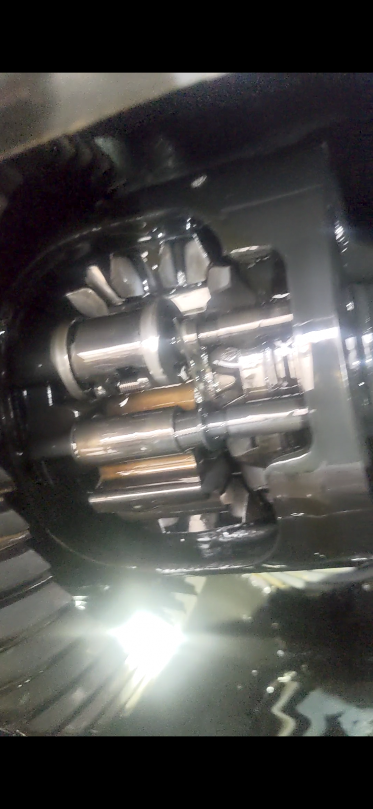

anyone know what the name of this type of limit slip diff is? I'd like to look into rebuild kits, like clutches and stuff. but never seen one like this?
any idea who makes it for gm?

This axle is made by AAM (www.demandaam.com) and is a locking limited slip. It does both when one wheel begins to slip and that counterweight engages the other wheel when rpms differ by about 200.
Great system, very reliable but not made for drag racing or burnout competitions.

A regular Yukon and not a Denali, it will be in an 8.6" 10-bolt, very similar to the center section used in the Buick Grand National and an enlarged version of the 7.5" axle used in the Monte Carlo, Grand Prix, Regal, Cutlass, etc.
That locking/limited slip feature was added to the truck axles around 1985.

It's the Eaton G80 unit made for GM. They've been using it for decades and I wouldn't want a RWD/4wd GM truck/SUV without one.
Can you clarify this statement?
Obviously G80 doesn't refer to any specific part. That's just the RPO that tells you the vehicle doesn't have an open diff.
You're saying GM has been using that same diff for decades? In what?
Just for reference, the 1996 Impala SS had an Auburn "G80" that was crap. That's an 8.5" 10-bolt.

Car G80 and truck G80 are different since about 1985.

so it would seem it has cluch packs but it's called a locker, so it's not really meant to slip. so no limited slip additives needed. interesting. the fluid I used was for a Lsd haha
I guess the real question that I had but can't find is can it be rebuilt? mine has a tons of the metal goo on the magnetic and the gear set inside looked very sloppy. no noise or anything from the ring and pinion when driving. so that's left me wondering if these are just super sloppy because if all the mechanical stuff.
I'll let it ride and see how it goes, maybe change the fluid in a year or so and see if it's still leaving metal paste. I'm sure it hasn't been changed in the 140k miles that's on it. fluid didn't look to bad though. just more build up than I've ever seen in a rear end that wasn't blown up haha

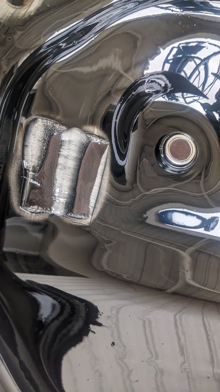

my fluid looked like black water and this was the magnet plug on mine, probably 140k never changed thou.
