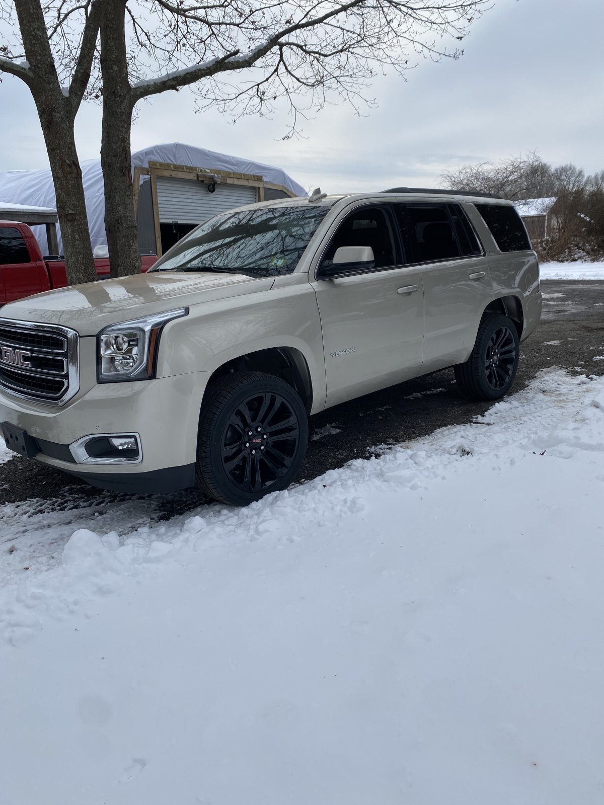

Hey guys, long story short I’m at end of road here with this 6l80. I’m very mechanically inclined and have my own shop but do not dabble in transmissions much. I bought a 2016 Yukon with a bad 6l80. Thing was smoked, I decided to rebuild it my self. This is a family hauler for kids and wife, isn’t for performance or anything. Any how I rebuilt it, new bellhousing and stator assembly, all new bushings, all new pistons, new gm clutches, zip kit installed, new 35r drum, new 456 drum, new sealing rings, new teflon rings, new pressure switches… reverse, 1st, 2nd, 5th all slip under load. Normal light throttle everything seems perfect, give it more the 20% throttle in those gears and she just revs. Also has a binding when it attempts to downshift from 5th to 4th, but only under load. If just cruising (no throttle input) and manually downshift from 5th to 4th is smooth. What am I doing wrong here? Had it apart twice now. Clutch clearances all came back in spec, 456 was a little on tight side .058, that was with thinnest snap ring and oem clutches. No codes, I feel like I have a faulty techm! @NickTransmissions please help lol thanks guys

Pics of the truck, please.

I appreciate your welcoming and I do plan on visiting this forum and trying to help others out when needed! Where should I post photos of my family hauler? Very new to the whole forum thing in general. Thanks again!
