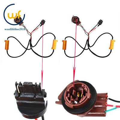

s-l400.jpg Would these work? I'll have look at my wire harness tomorrow and see if they will

Did you ever get this figured out? I was planning to add the Philips LEDs to my 2003.
