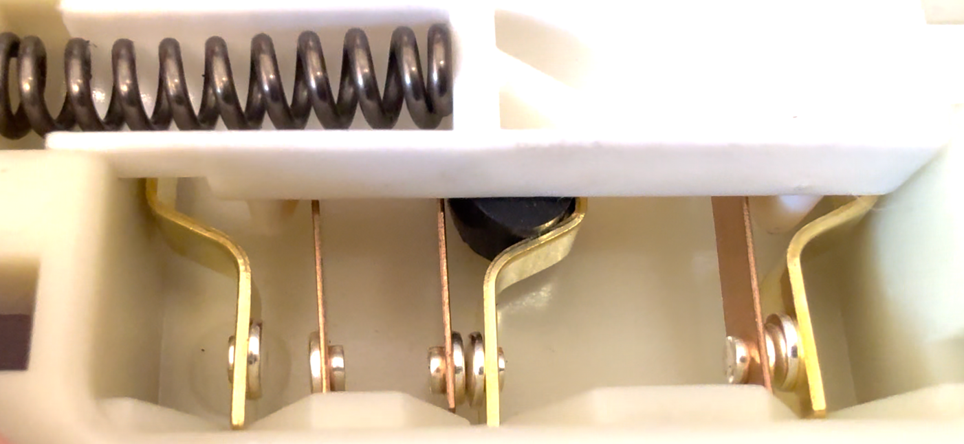

Shimming the end of the pushrod runs the risk of bottoming out the switch or engaging the brakes, neither of which I wanted to do. Instead, I took apart the switch (just four clips, pretty easy) and discovered the center circuit (the one that carries the cruise release signal) was not opening unless the switch travel was nearly maxed out.
I ended up being able to put a piece of rubber tubing (windshield washer to be exact) around the middle post on the lever to fill the gap between the post and contact blade so that it opens immediately. This simple fix resolved my issues, and the cruise control works again!
Now with the rubber in there, the cruise release circuit opens while the PCM circuit does and just prior to the physical brake lights come on which is the behavior that I would expect.

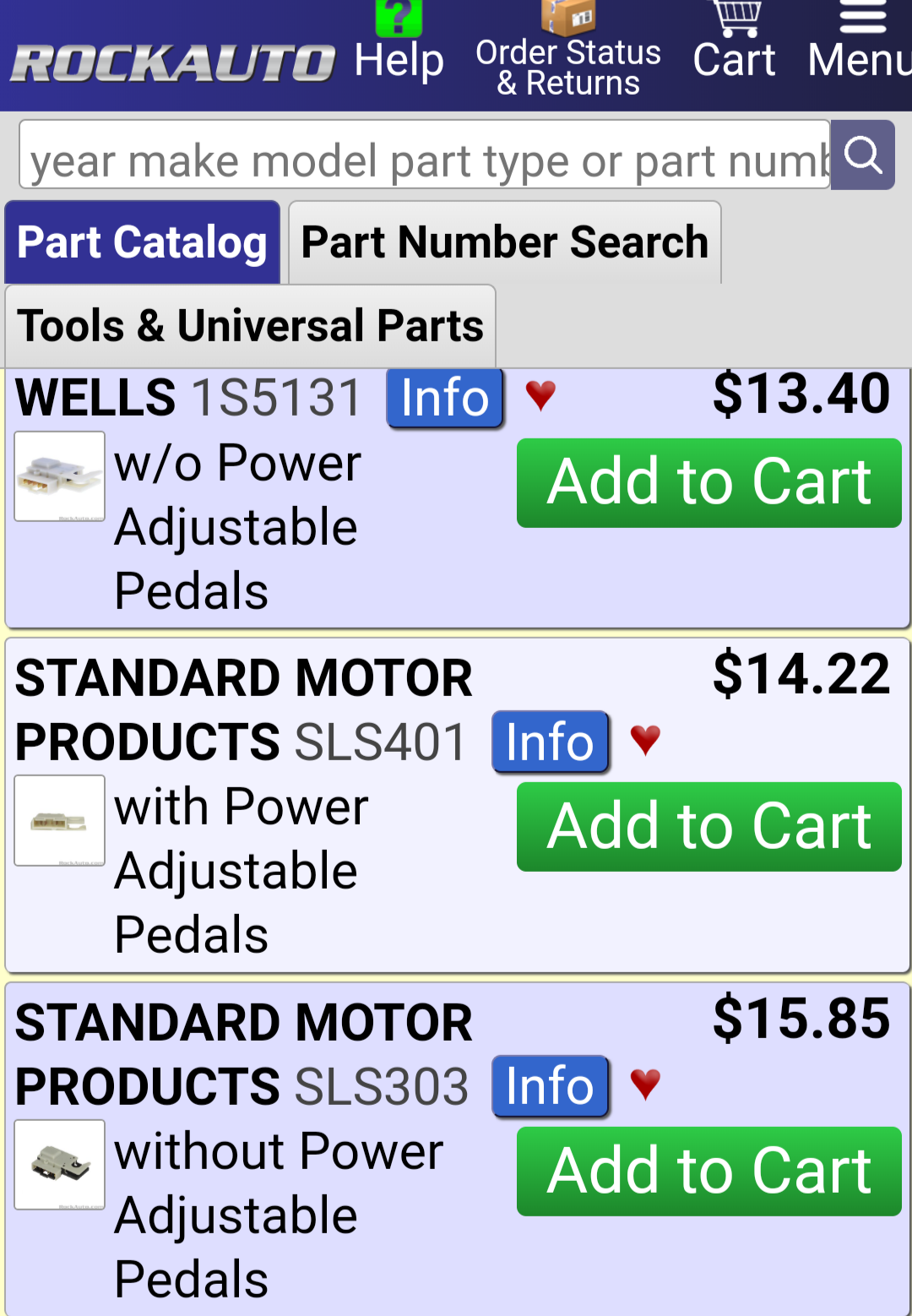

I think after going through the trouble of laying with my back on the floor to remove it, I would just spend the $15 and get a brand new one :)
