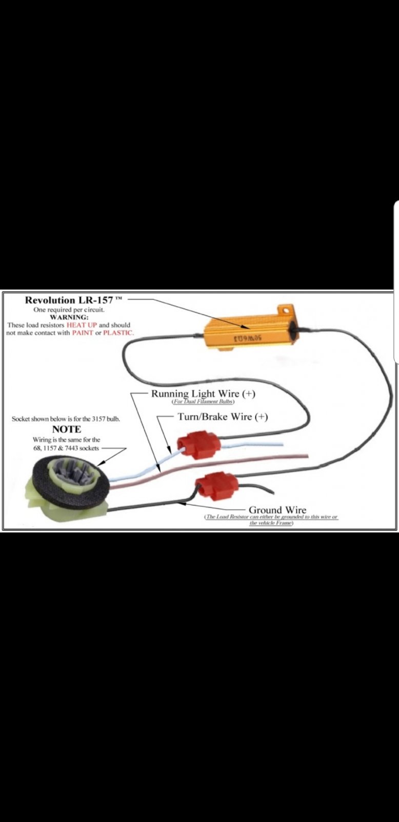

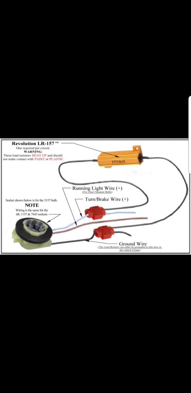

I installed LED bulbs in the taillights of my '04 LT. Now my cruise control doesn't function at all. Reinstalled the incandescent bulbs, everything works again.
Is there a certain kind/brand of led I should install? The ones I installed are Phillips.

you need to add a load canceler you don't have canbus only the hybrid GMT800s* & 900 have CANBUS

I should have specified that it was the brake lamps. Do the brake lamps need a resistor?
I will be installing a led compliant flasher for the turn signals
BG1988
Nov 14, 2018
3,007
1,371
yeah probably.. a normal light bulb is a resistor that is what the controller is looking for

Yes the rear brake lights also need resistors

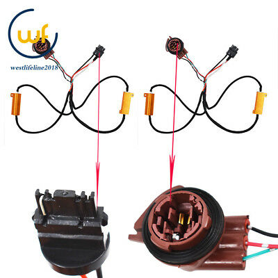

s-l400.jpg Would these work? I'll have look at my wire harness tomorrow and see if they will

"No point of swapping to LED if I need to waste 50w of electricity each time I brake."
This is some strange logic. You're not 'wasting' electricity. The same amount of electricity is being used every time you push the brakes. Doesn't matter if you have a resistor in place or not. Think of it more like you need to slow the electricity down now that its not being in hampered by those needy incandescent bulbs. Its too quick back to the relay so the relay can't figure out whats going on. Slow it down the CC relay will know whats going on again and you'll be happy. Its less than $10 and super easy to do.
