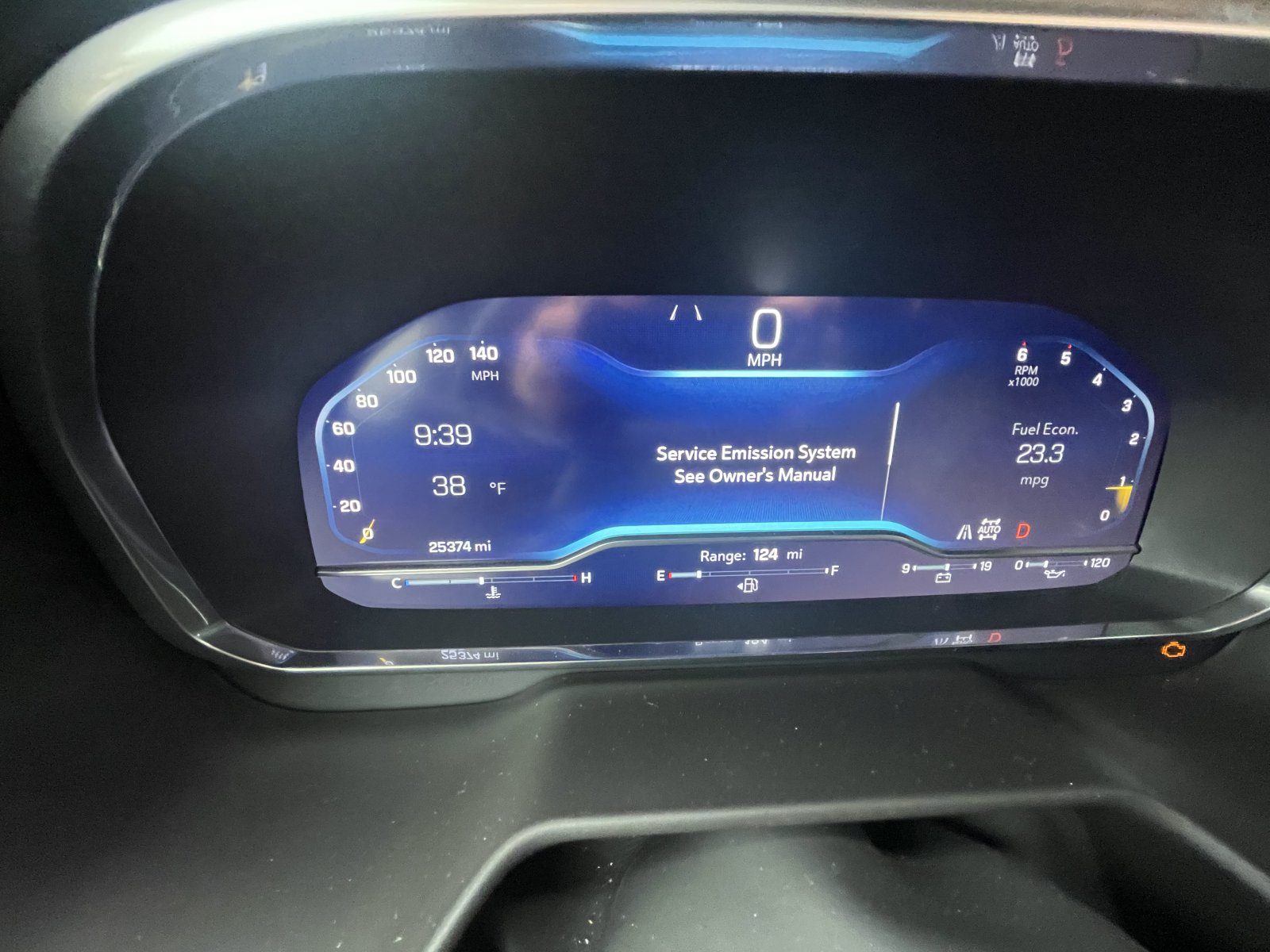

My 22 Tahoe (26k miles) just got back from the shop after a 1.5 month wait for a new crankshaft sensor. I’ve had it less than a week and I get the same problem I had before the new sensor was installed. The car periodically knocks, the check engine light is on, I received a diagnostic alert to check the engine, transmission and emission system and I have a warning that I will not be able to go over 65 mph in 175 miles. So frustrating. Any body else have this issue and have it successfully resolved? Many thanks,
