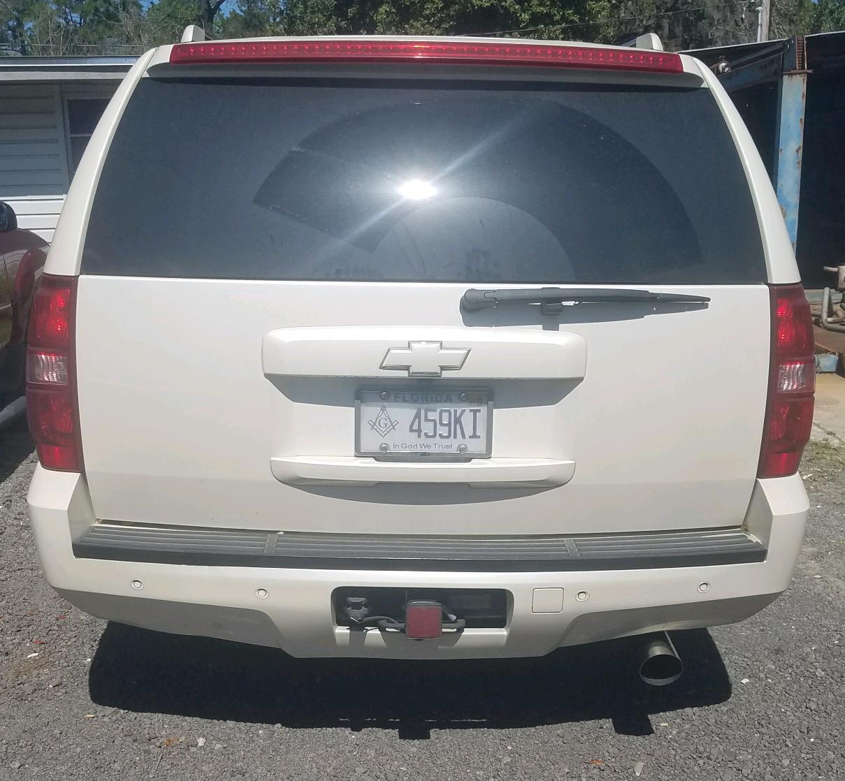

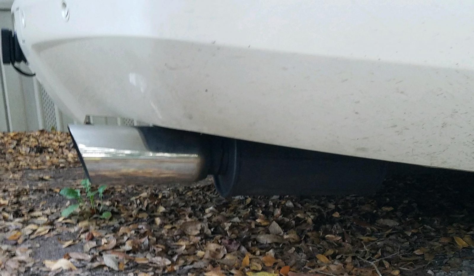

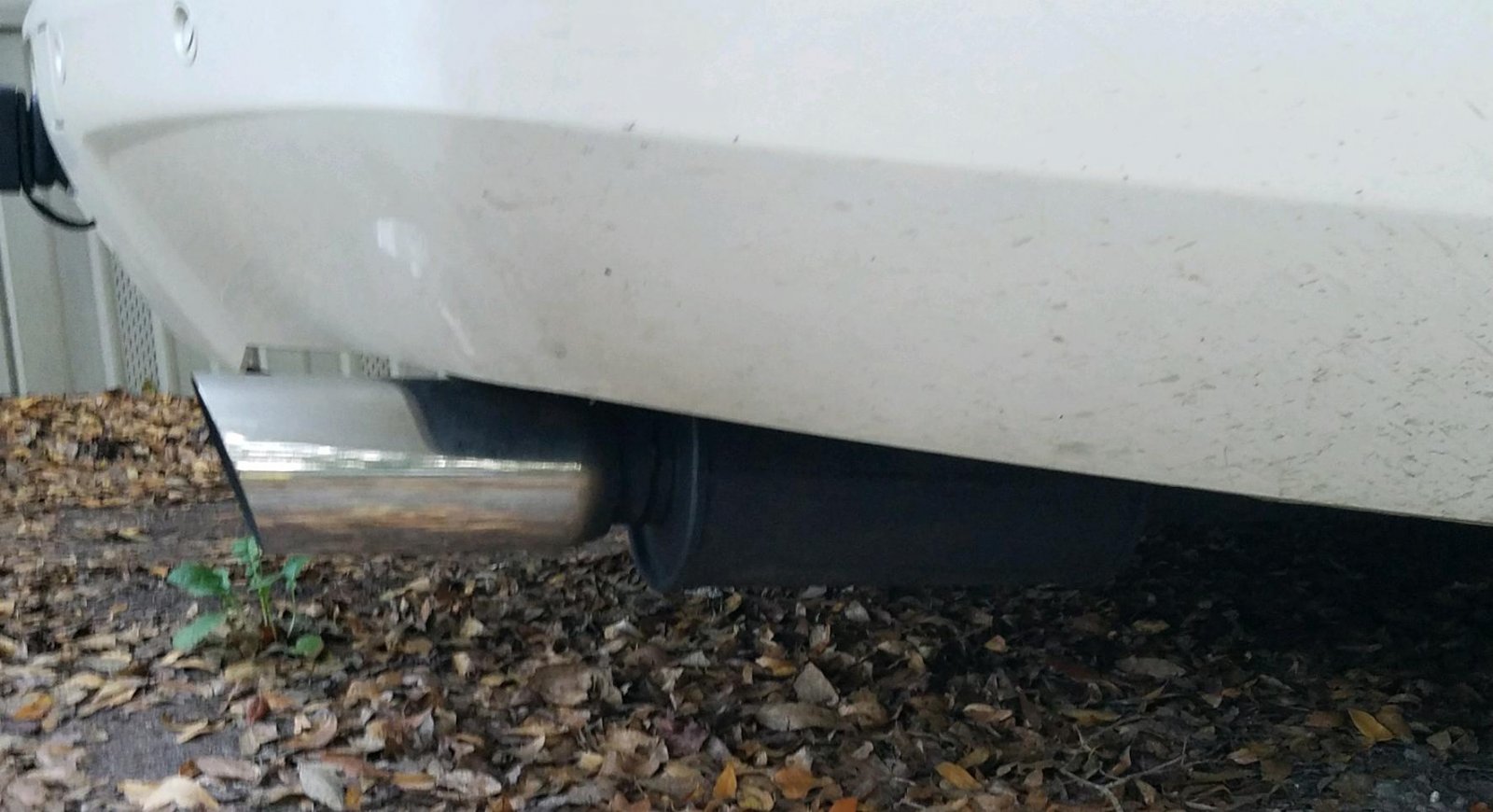

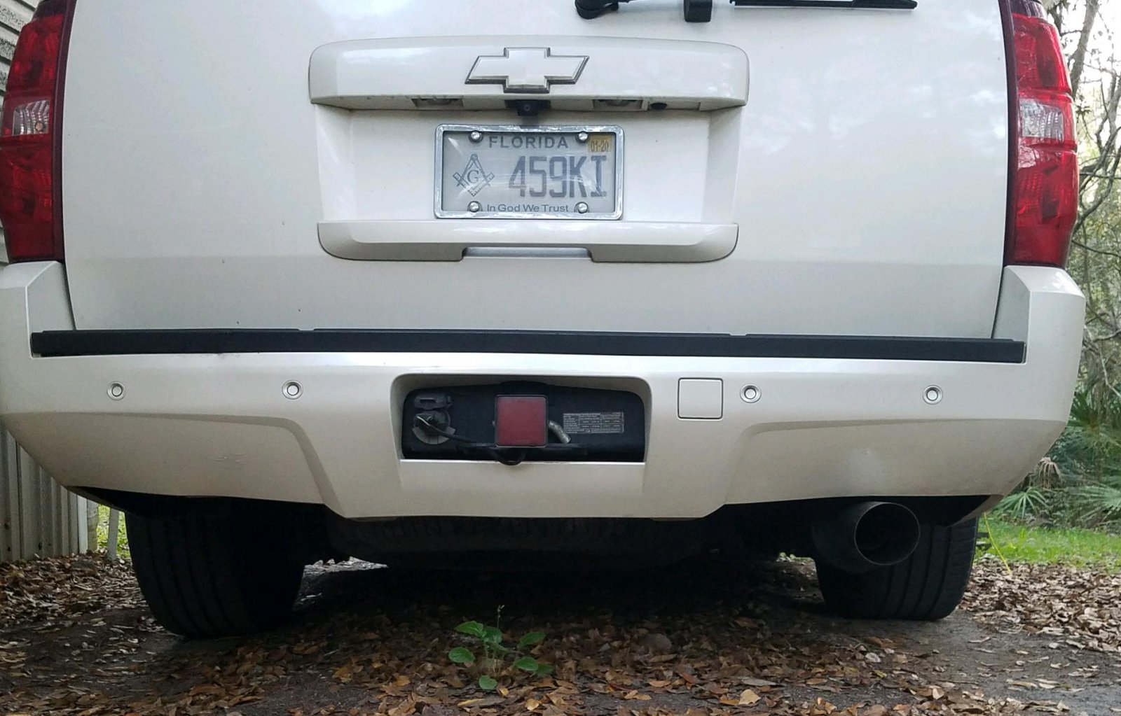

Alright... this is the final rendition of the exhaust on the Burb.... I swear.... at least this week... lol
I ended up having them add the factory resonator back in at the tail to get rid of the awful drone it had at 60 MPH. This did the trick... no drone at 60, 70, or 80 mph on the interstate. It also toned it down a bit inside through out the RPM band although it doesn't seem that much different outside.
The best part about it was they didn't charge me for cutting and welding the resonator back in... so win, win for me.

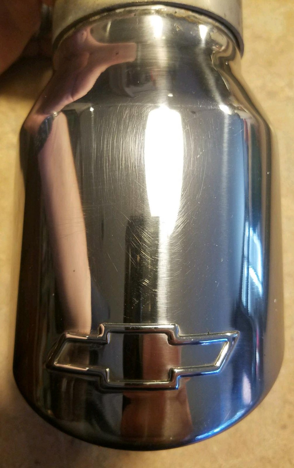

I also have the dealer accessories optional chrome BOWTIE tip if anyone is interested check the classified section...
rps20190312_172341_396-jpg.218529
rps20190312_172410_255-jpg.218530

the thing i hate most about the resonator is looks so ugly hanging down in back like a dingleberry. Did they position it better when they re-welded it back in?

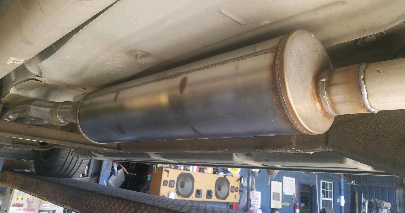

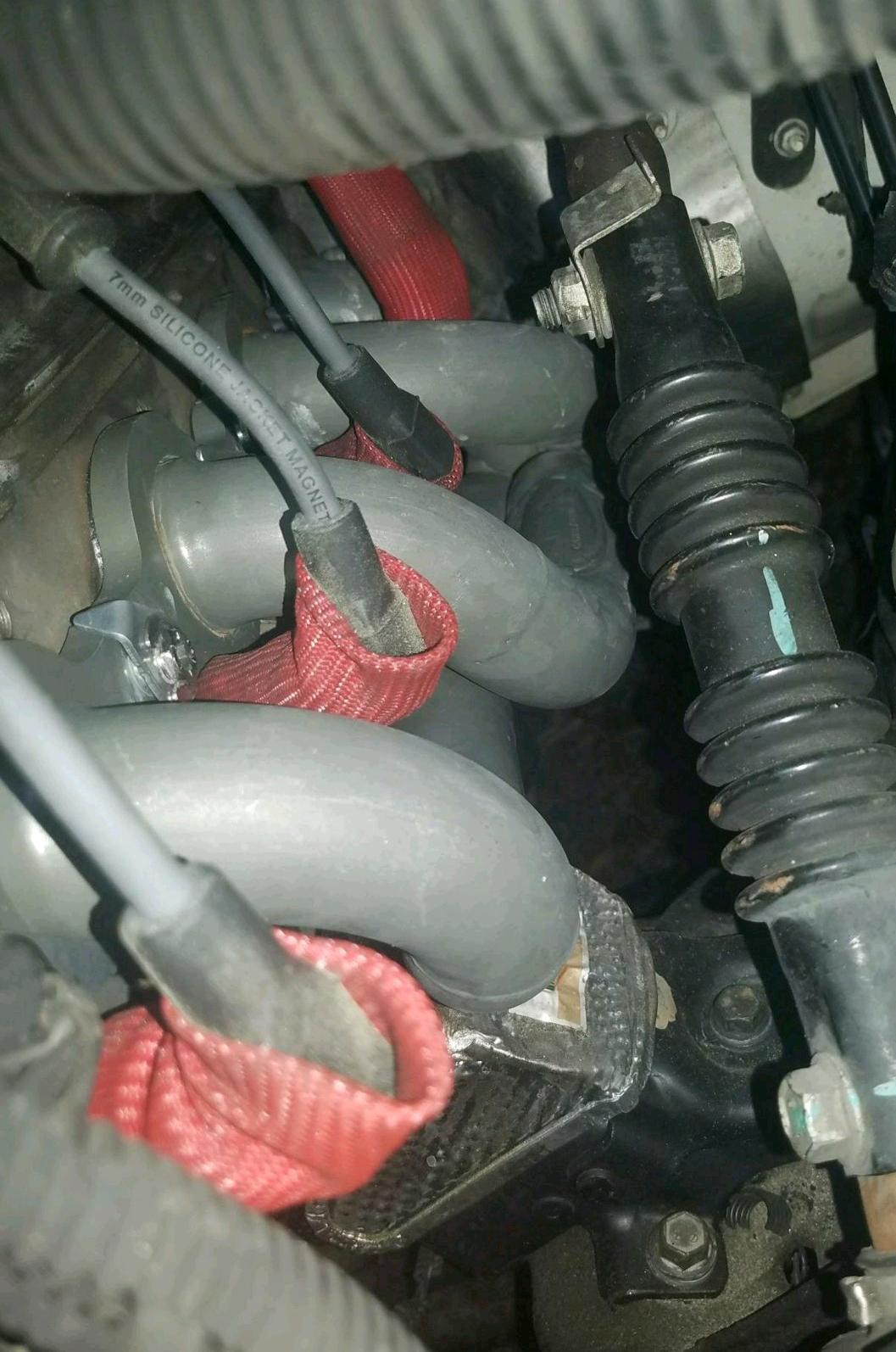

JBA shorty (cat4ward) headers with titanium ceramic coating.
Custom 2.25" Catless Y-pipe which comes back about 1.5' - 2' further than stock before it Ys together.
Magnaflow XL 3 chamber stainless steel muffler part #13749. Case length 30". Overall length 36".
Factory tail pipe with factory resonator reconfigured to exit out the rear through a 4" stainless tip.

I was going to post pics of each section of the exhaust but then I remembered that my SD card got corrupted and I lost all those pics. So I just posted some shots of the tip and resonator I took today.
Coming out the back kinda makes it look like it has the 6.2L... only someone from this forum would recognize that though... lol
I wouldn't say it's positioned any better but, with the exhaust tip where it is, I think it's less noticeable.... plus I blacked it out with flat black paint so it is less conspicuous.
It's kinda hard to hide it unless you want the tip to come down at an angle.

Looks good. Sounds great!
Though, I have to admit.. I liked the sound better before you added the resonator back. :Big Laugh:
Buuut... since I'm not the one driving with a drone.. I can't blame you for adding it back.

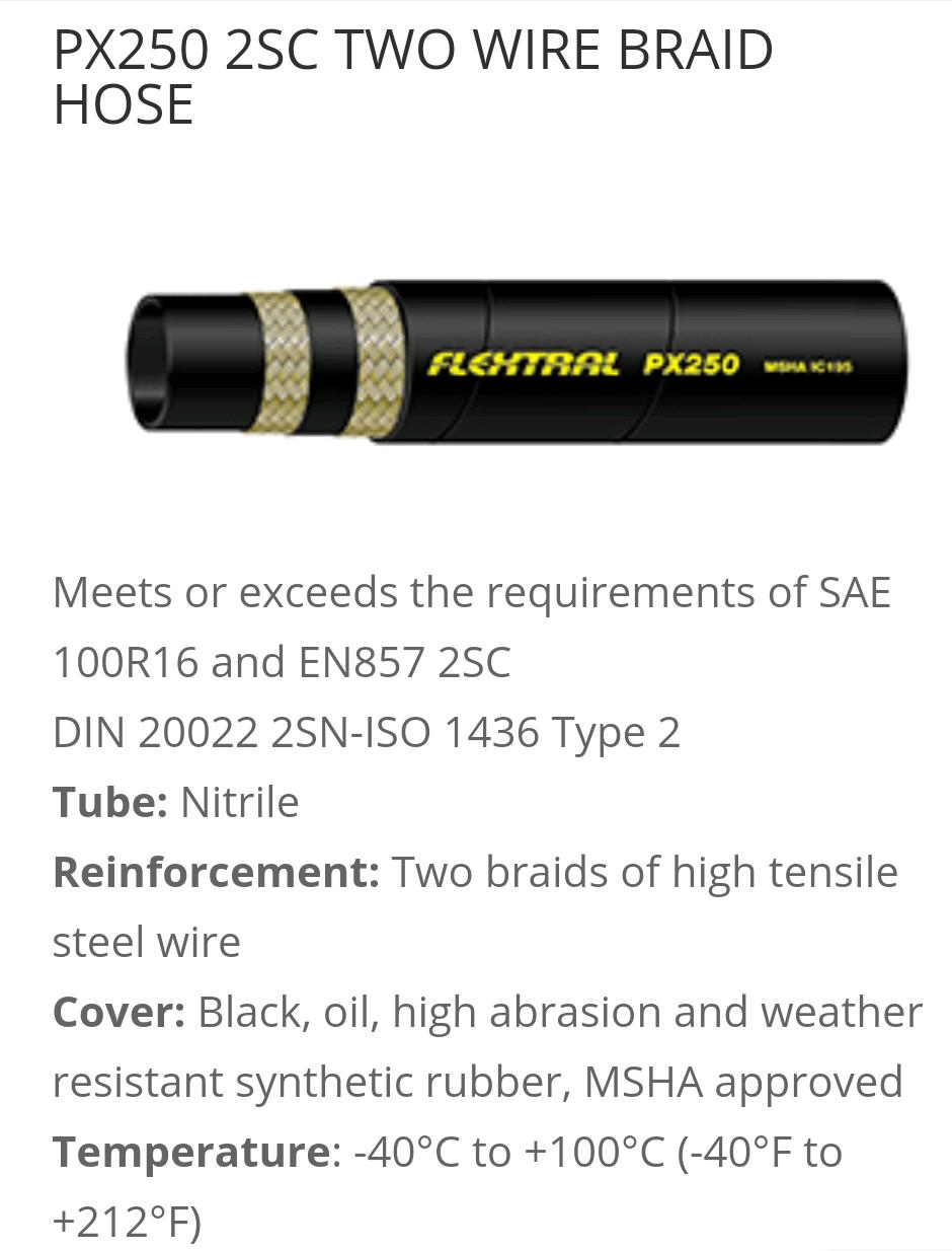

Also forgot to mention I got my new hoses made up today for my dual remote mount oil filter setup and oil cooler....
rps20190312_203611_716-jpg.218549
rps20190312_203646_234-jpg.218550
rps20190312_204055_981-jpg.218551
They are hydraulic lines with swivel threaded ends.
My only concern is the 212° max operating temperature but I have never seen my oil temp over 210° (after some WOT pulls) and it usually sits about 205° when idling. Probably cooler when cruising due to more airflow over the oil cooler.
I figure that the maker probably tested it to higher temps and chose a safe number to list as spec. I seriously doubt that at 213° it fails.
The guy making the hose for me told me he makes them as oil lines for tractors and stuff all the time with no issues.
Hopefully this will alleviate the very minor leak I have. It's so minor that it doesn't even leave any drips on the ground but it's enough to annoy me just knowing it's there.
rps20190312_212507_749-jpg.218556
