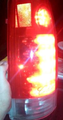

These started life as clear LED tails. I opened them and installed the extra 2" round light at the top where the round reflector normally resides and wired it up to the brake lights. I also added the CADILLAC script to the inside of the lens right above the reverse light. Keep in mind this was after I sprayed them ruby red but before clear coat.

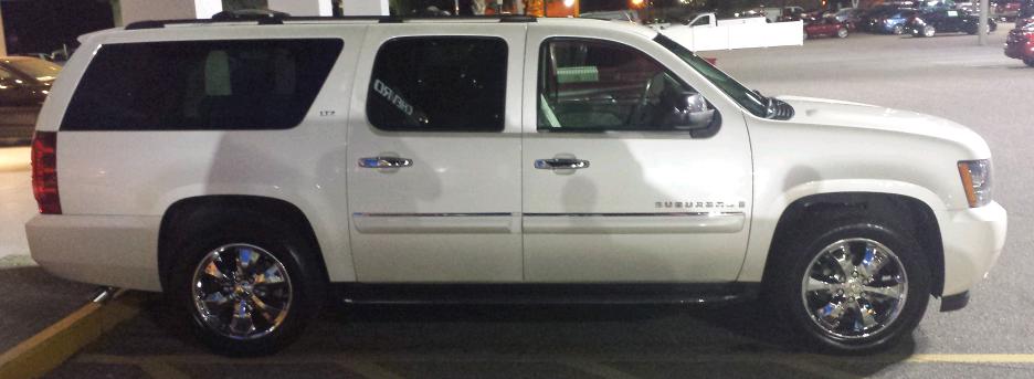

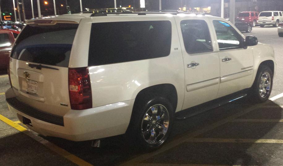

Here is a couple pics of our 2008 Chevy Suburban LTZ in White Diamond Tricoat as she sat at the dealership the night we picked her up.
Nothing terribly special or anything we all haven't seen before BUT we've got to start somewhere right?
