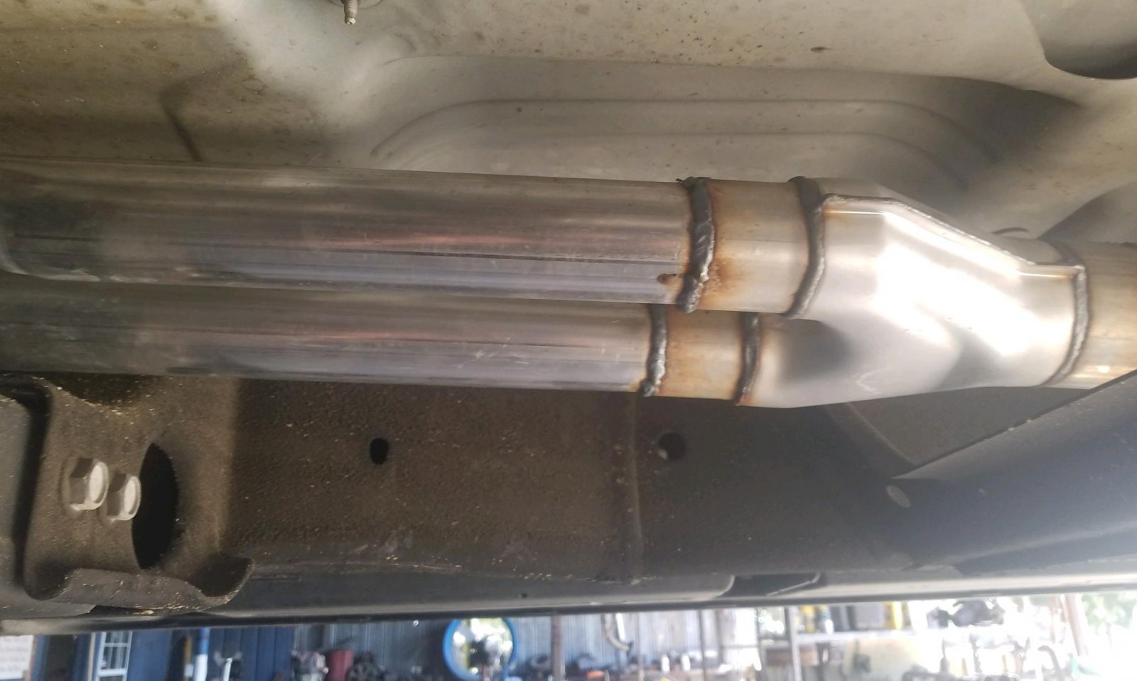

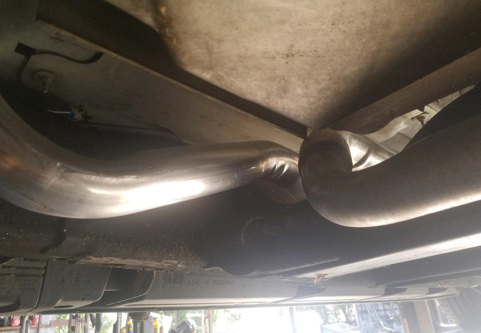

Here is a better pic of the Y-pipe I had built as well...
rps20190308_153423_456-jpg.218252
This is where the original Y-pipe joined together right before the transmission crossmember by the transmission pan.
rps20190308_153551_529-jpg.218253
And here is where the new longer Y-pipes come together in front of the next crossmember which is about 1.5'- 2' further back.
