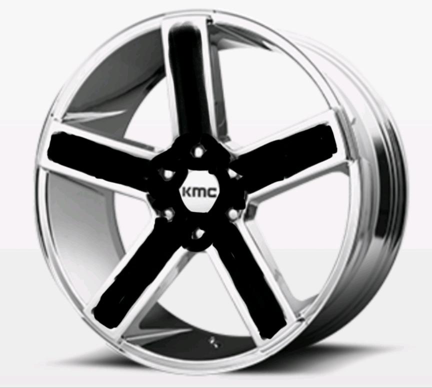

I found these KMC Deuce wheels in chrome.
I was thinking about using black vinyl (maybe black reflective) to black out the centers of the spokes and around the lugs to give them a little more definition like the Iroc looking wheels I posted earlier and to tone down some of the chrome.
What do you guys think?

Quick and dirty little photo shop...

Separate not really digging it but on the burb looks pretty good. Reminds me of old American eagle 077’s.

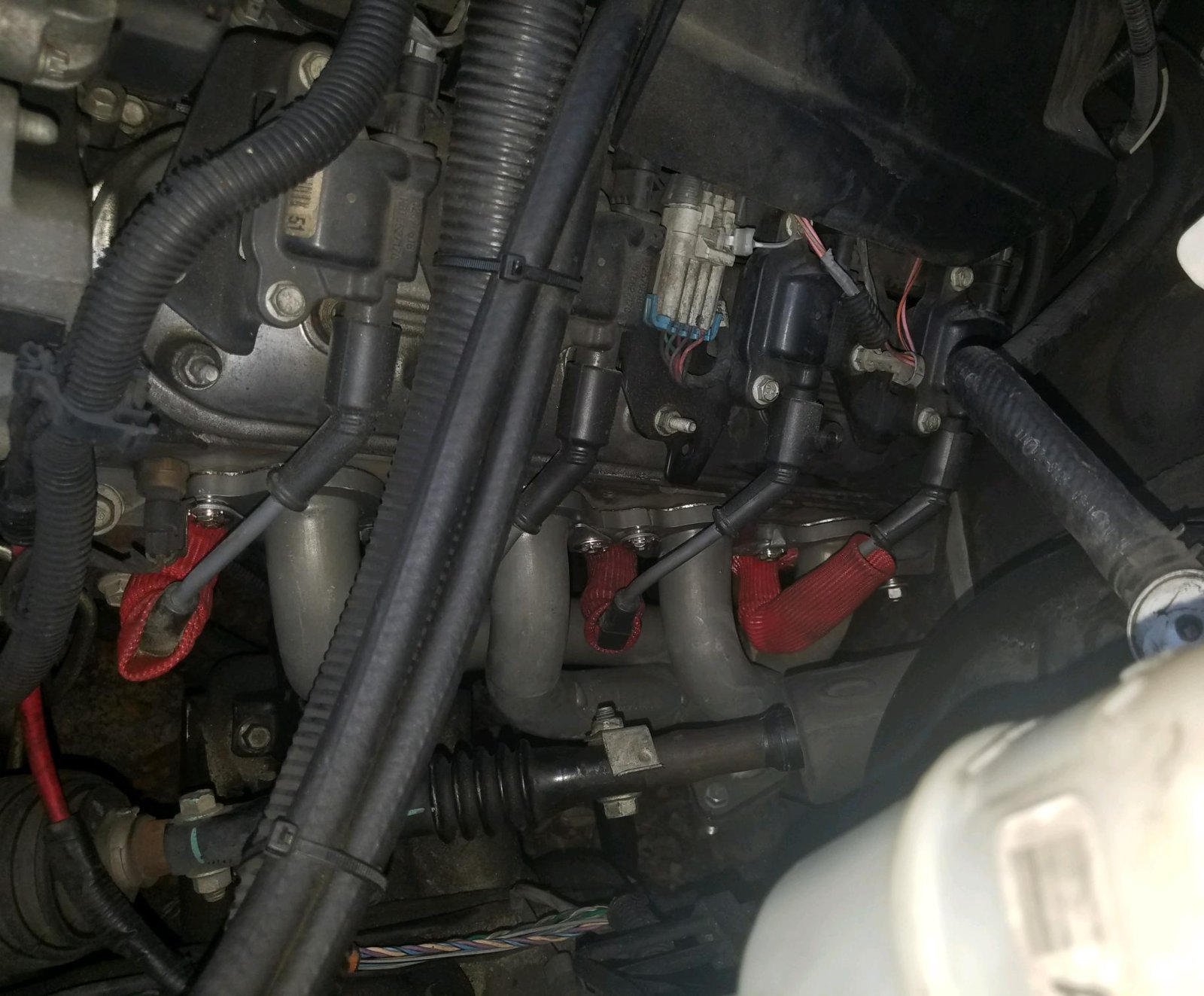

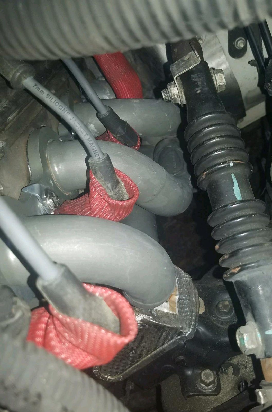

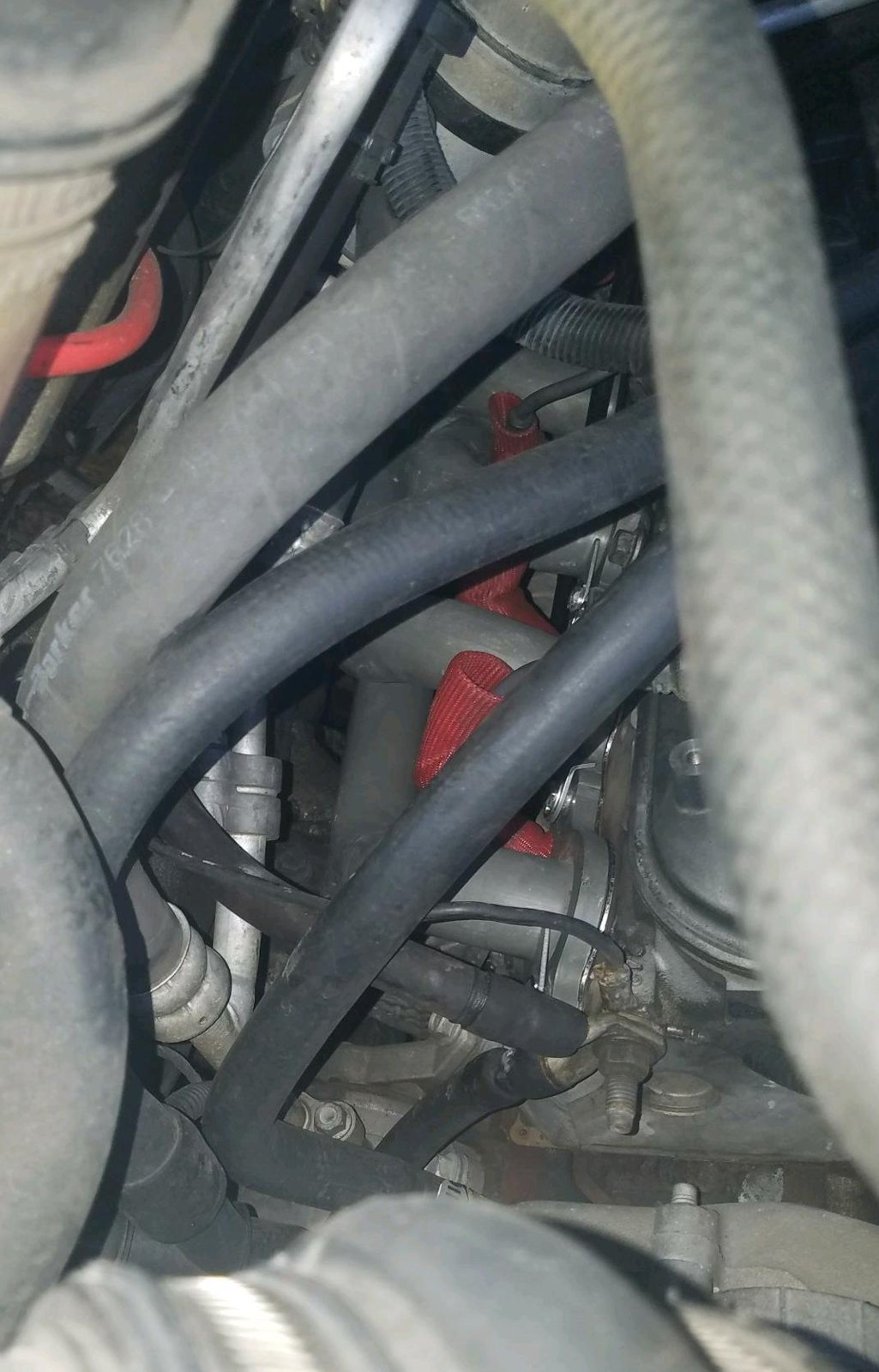

I posted this in the "What did you do to your... today" thread the other day but never posted any pics.... so here is the proof as they say...
Titanium ceramic coated JBA shorty headers installed with Stage 8 locking bolts...
It's kinda hard to get a decent pic with all the stuff in the way...
Especially the passenger side...

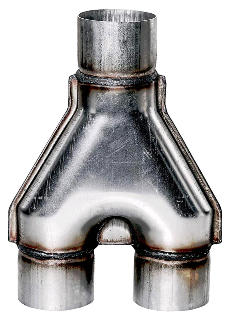

So after much research I decided to have a new Y-pipe built out of 2.25" pipe and that has definitely solved the issue of lost torque. She gets up and moves now.
The factory Y-pipe is about 2.5" diameter pipe, although it is bigger in some spots. You wouldn't think that a 1/4" would make that big of a difference but it most definitely did.
Here is some interesting info...
As you can see the 2.25" pipes will support up to 371 HP so I don't feel like I'm leaving anything on the table.
The idea is that the smaller pipes DO NOT create "back pressure" but do increase, or rather help to maintain, the velocity of the hot gasses which improves the scavenging effect on the cylinders.
From the factory the 2 sides of the Y-pipe meet just in front of the transmission crossmember.
My new Y-pipe stays seperate until about a foot behind the transmission crossmember and then goes into a stamped Y-connector...
and into the 3" pipe going towards the mufflers. I wish I would have thought to take a pic while it was on their lift. Guess I will get one next time.
I didn't bother having them weld the rear O2 sensor bungs into the new pipe since they are turned off in the new tune.
