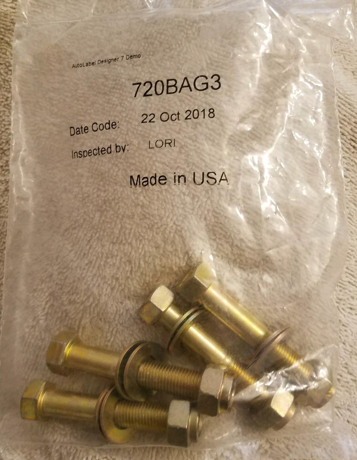

So, without further ado...
Rancho 9 way adjustable struts for the front of the Burb...
And the Grade 9 hardware to install them under the control arm instead of on top...
Note the Rough Country part number on the bag (720BAG3) in case anyone is looking for the hardware.

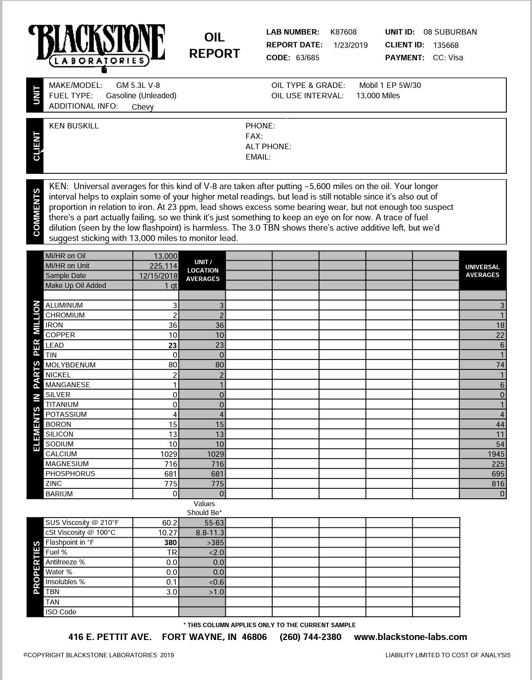

First engine oil analysis complete.
Here is Blackstone labs report...
Keep in mind I am running a dual remote mount oil filter setup and each of those dual filters is more than twice the size of the stock oil filter so, in theory, I have about 4.5 times the filtering capabilities of the stock filter.
I also have an external oil cooler and run Mobil 1 5w30 extended performance 15k mile full synthetic oil.
