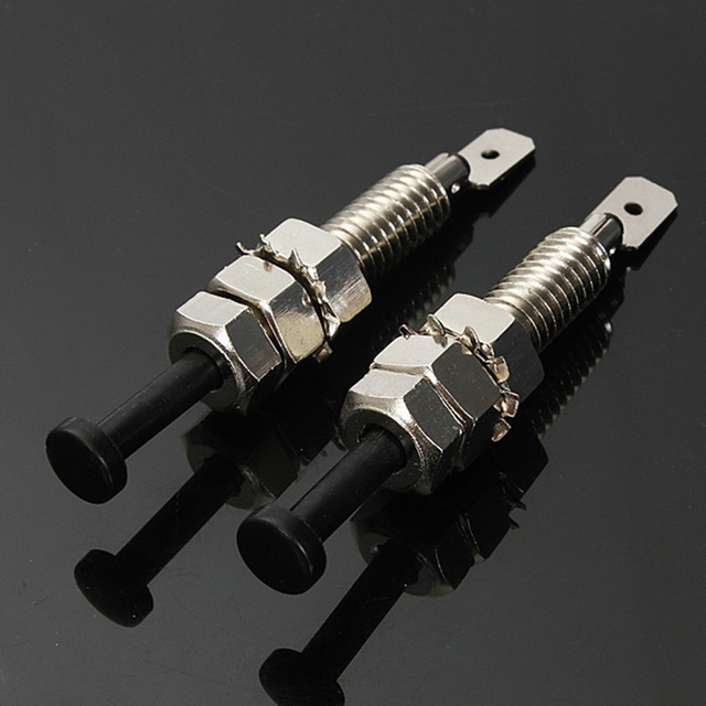

You need a tilt switch... something like this...
https://www.amazon.com/NORMALLY-OPEN-CLOSE-TILT-SWITCH/dp/B073HNMCMN
Attach switch to hold securely so that it doesn't bounce around and cause your light to come on with the hood down.
One side of the switch goes to the positive lead of your new underhood light. The other side goes to the power coming out of the fuse tap/fuse box.
Get a fuse tap like this...
Tap into the underhood fuse box here...
Fuse number 37 front wipers 25A.
Ground to just about any bolt under the hood.

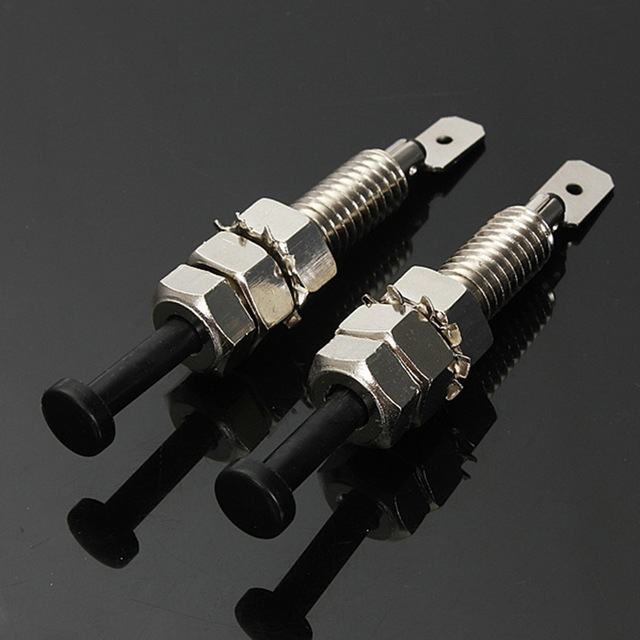

Hood light is such a nice upgrade for our trucks, even tho gm and all other manufactures cheap out on that part. For my hood light it's the simplest install but nobody uses it for some reason lol. I just grounded to a security/alarm adjustable hood pin. Then straight power to battery with inline 20a fuse. Led cob strip about 6" long.

Hood light is such a nice upgrade for our trucks, even tho gm and all other manufactures cheap out on that part. For my hood light it's the simplest install but nobody uses it for some reason lol. I just grounded to a security/alarm adjustable hood pin. Then straight power to battery with inline 20a fuse. Led cob strip about 6" long.View attachment 204153

I thought about the pin switch but already had a tilt switch from my old box body S-10 blazer so that's what I used.

I also had my hood pin left over from previous remote start so I used that lol.

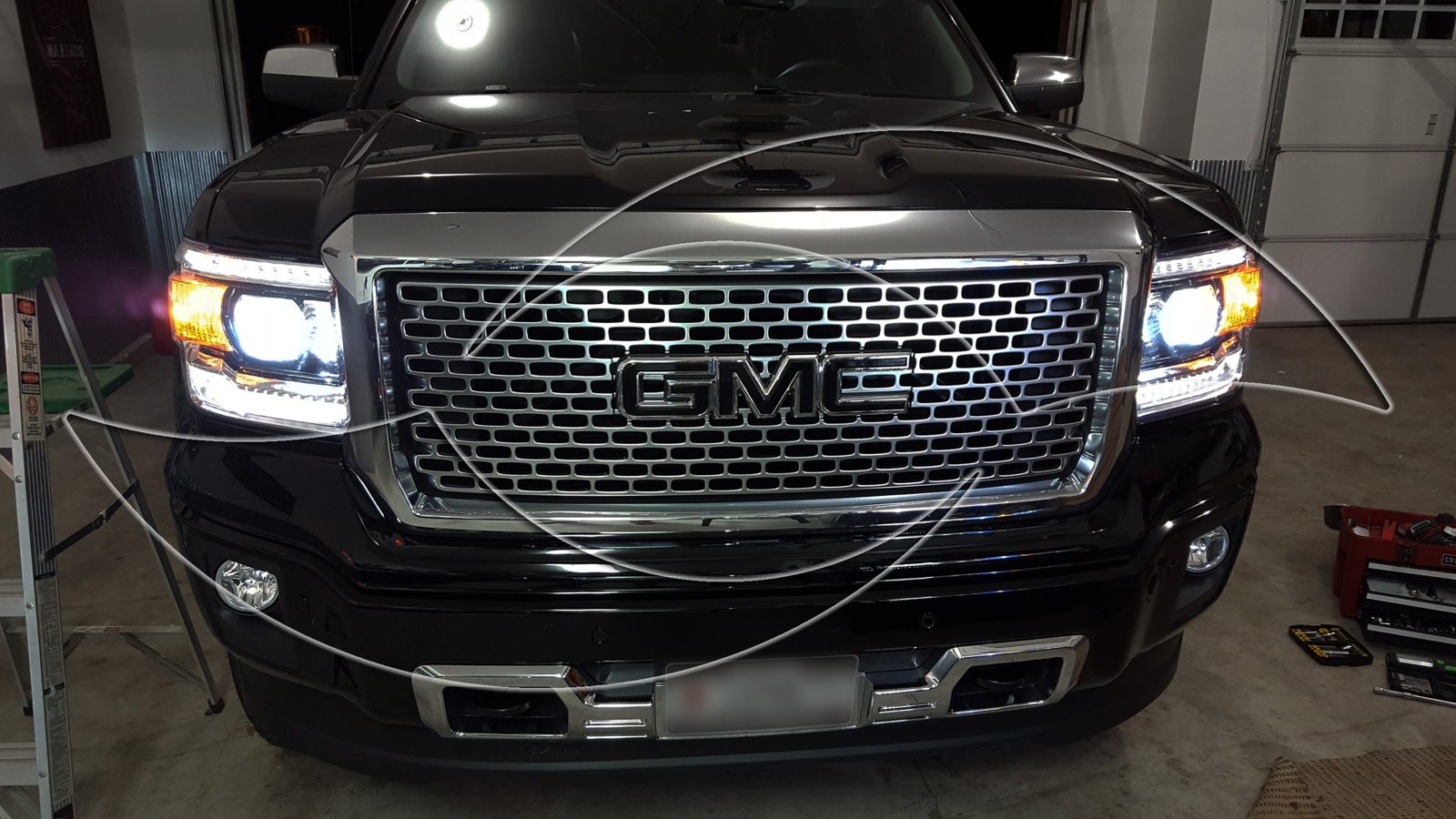

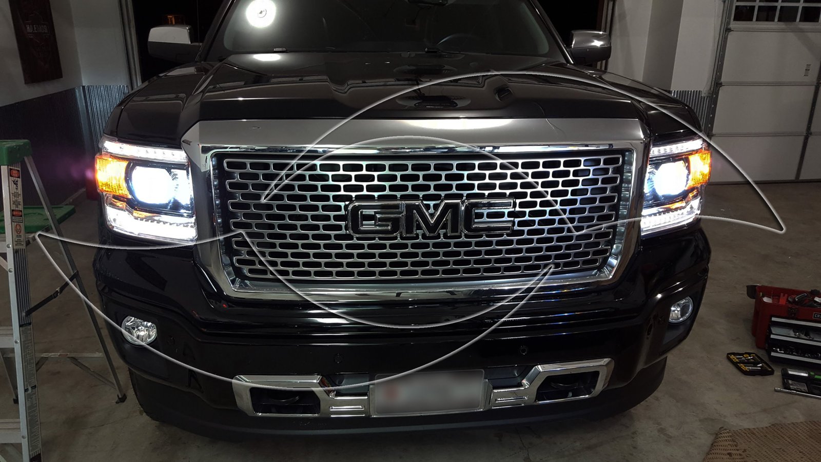

Jdmastars are super super pure 5000k white not a tiny bit or hint of blue, same color as new 2017+ Sierra/Silverado drl strips or new Durango drl strips. if you're wanting to matching in the front. Here's an example of the color.

Jdmastars are super super pure 5000k white not a tiny bit or hint of blue, same color as new 2017+ Sierra/Silverado drl strips or new Durango drl strips. if you're wanting to matching in the front. Here's an example of the color. View attachment 204220

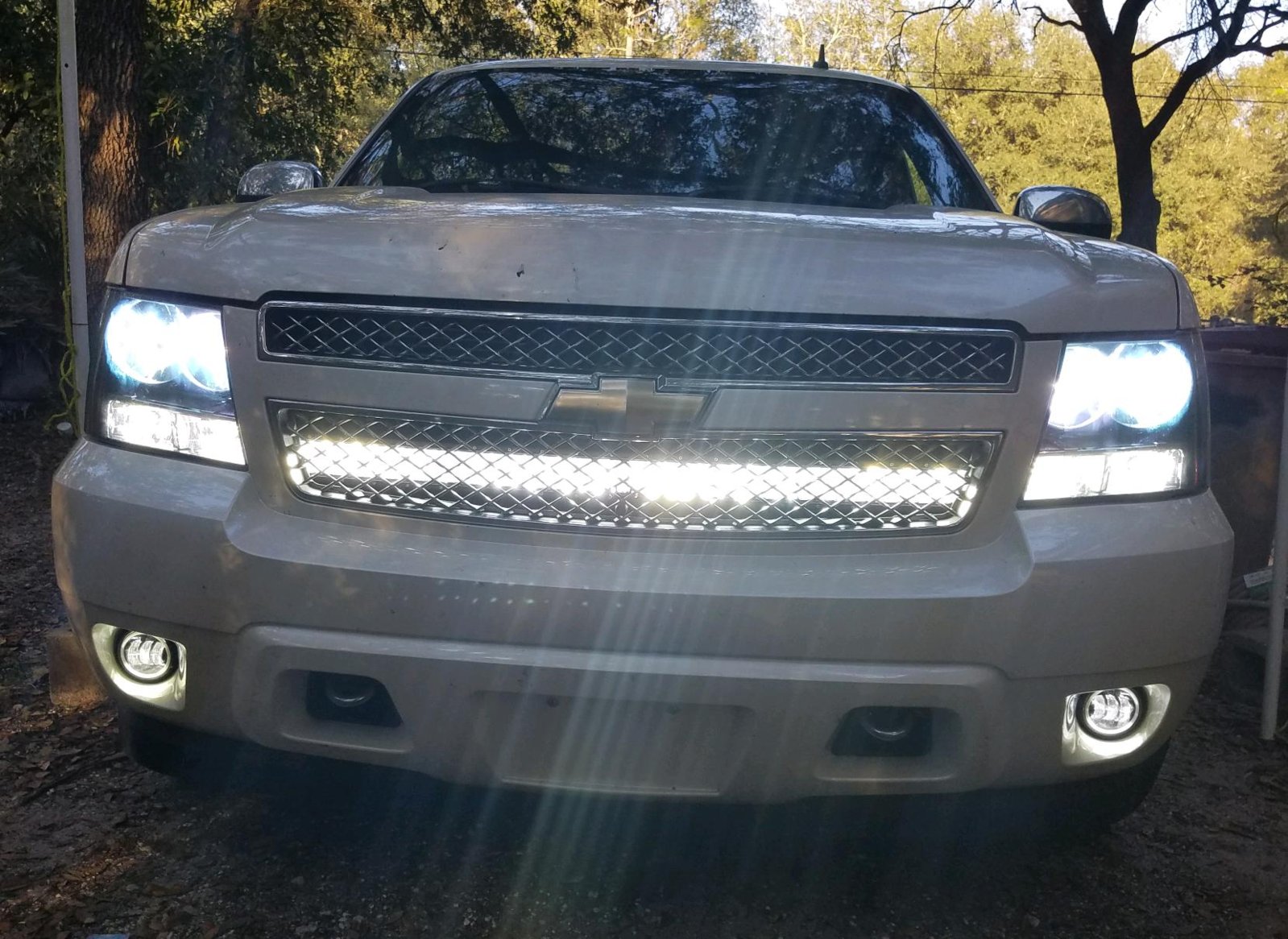

The ones I have in there now are basically identical to the JDMastars the just are a type 1 LED. But as far as the color match goes it is spot on.
This pic was when I still had my 8K HIDs in the low beams...
I have since swapped the low beams for the Supernova V3 LED headlights so they all match except for the high beam... haven't figured out what I want there yet.
Low beam, parking lights, projector fogs all LED.

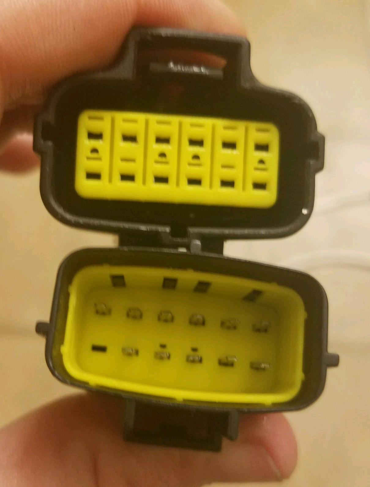

I did get some things in... I went ahead and made up these weatherproof connectors so they will be ready when the rest of the stuff finally arrives.
Pretty boring I know... but at least its something.
