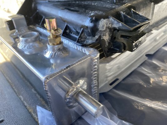

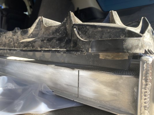

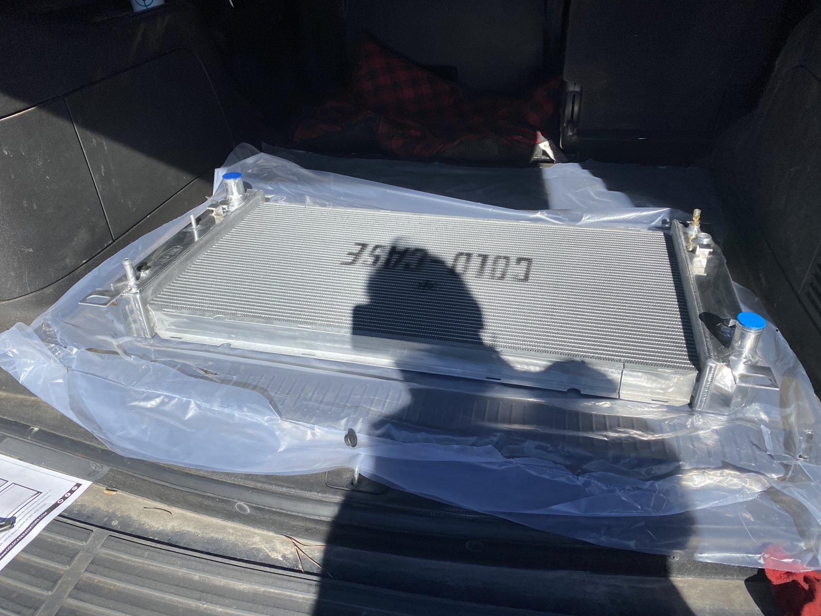

The Cold Case is not a direct Plug & Play radiator for our trucks.
It is very close but did require some slight modifications to make everything fit properly.
We had to trim the top and bottom of the fan shroud a little bit to get the fans to sit close enough to the core to fit into the brackets on the radiator.
The upper radiator mounts also required some slight trimming where they over hang the end tanks to clear the core support. I suppose that the lower rubber bushings could have been trimmed down to lower the radiator slightly but I didn't want to take the chance of it sitting too low and possibly rubbing on the bottom.
We also had to bend the condenser brackets forward just a bit to give a little extra clearance so it doesn't touch the radiator tanks.
Other than those small tweaks everything fits and works nicely.
Here are some more pics for reference...
I’m glad you posted these pics. It appears Cold Case has made some running changes to this model. The core is the same depth but the tanks are larger, and set the core more forward. The only trimming I had to do was at the top strap to clear two mounting bolts for the AC condenser coil. Nothing with the fan shroud.
I ended up getting a warranty replacement for the original and it indeed has been updated and the new one bolted right in without any modifications.
I did notice that the core on the newer version is not quite as thick as the original version as seen in this pic...
Original design on top, newer version on the bottom.
Still about twice as thick as the stock one though...
This is comparing stock to original design which was almost three times as thick.
