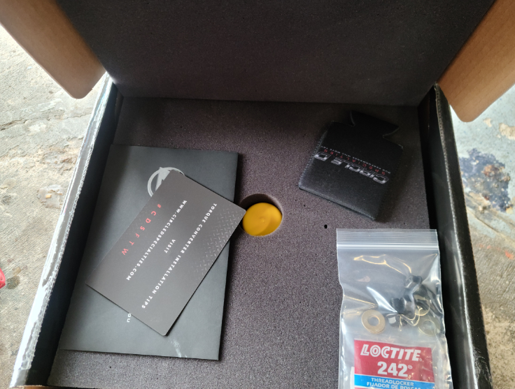

Welp, i got my converter.
Circle D sure does well with the packaging!
UPS smashed the fk out of the box.
I already took out the t-shirt and the pen before this picture... :)
New converter bolts, locktite, and some shims included.
nice!
I ordered a new input shaft o-ring.
Once that arrives i'll yank the old converter and install the new one.

I'm rocking my CircleD shirt as I type this. I took the stock converter off as soon as I pulled the engine and installed the new one right before the engine went back in cuz I didn't want the unsupported weight sitting on the input shaft. Supposedly, you can warp the seal if it sits for a long time.
Good thought.
I was thinking keeping the converter on there would prevent dirt from getting into the pump.
