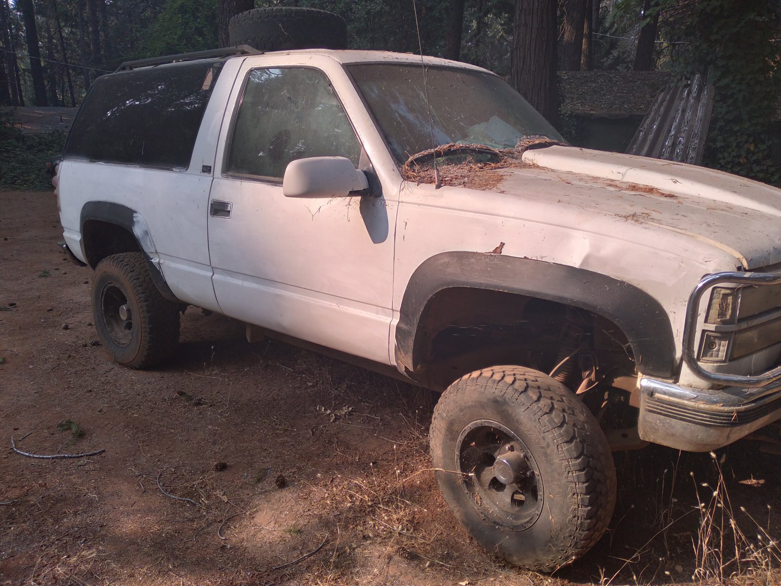

Another member asked me to post some pics of a transmission replacement I'm doing. I looked at his posts, thread and figured I'd follow his example. Here is what's going on.
This is my 1995 2 door Yukon. She's looking a little sad but that is all about to change. I've owned it about 7 years now. In that time it has received a couple of used transmissions and for a while it had a 2000 rpm stall torque converter.
Thanks Tonyrodz for the suggestion!

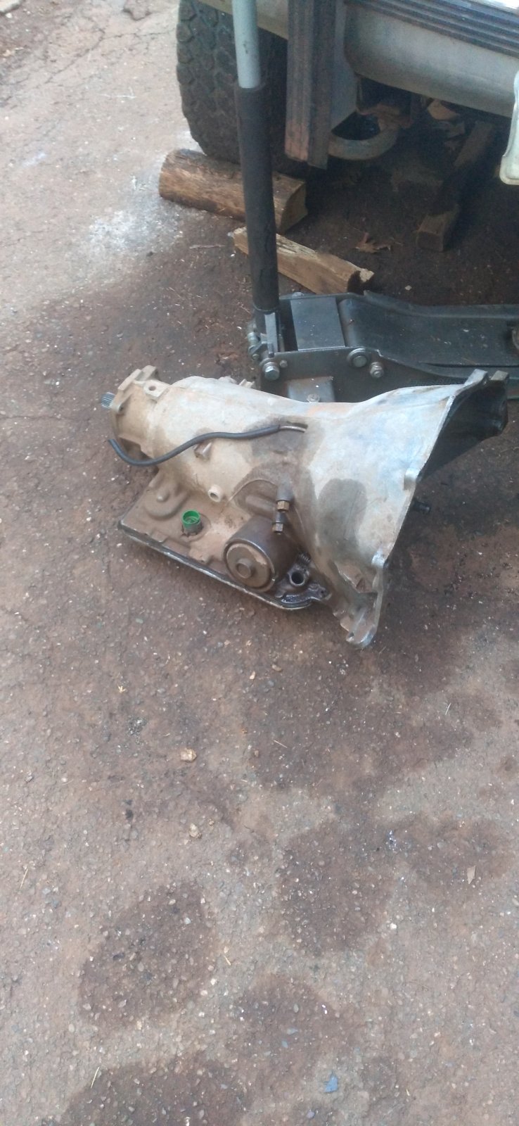

Last night the old gearbox finally came out.

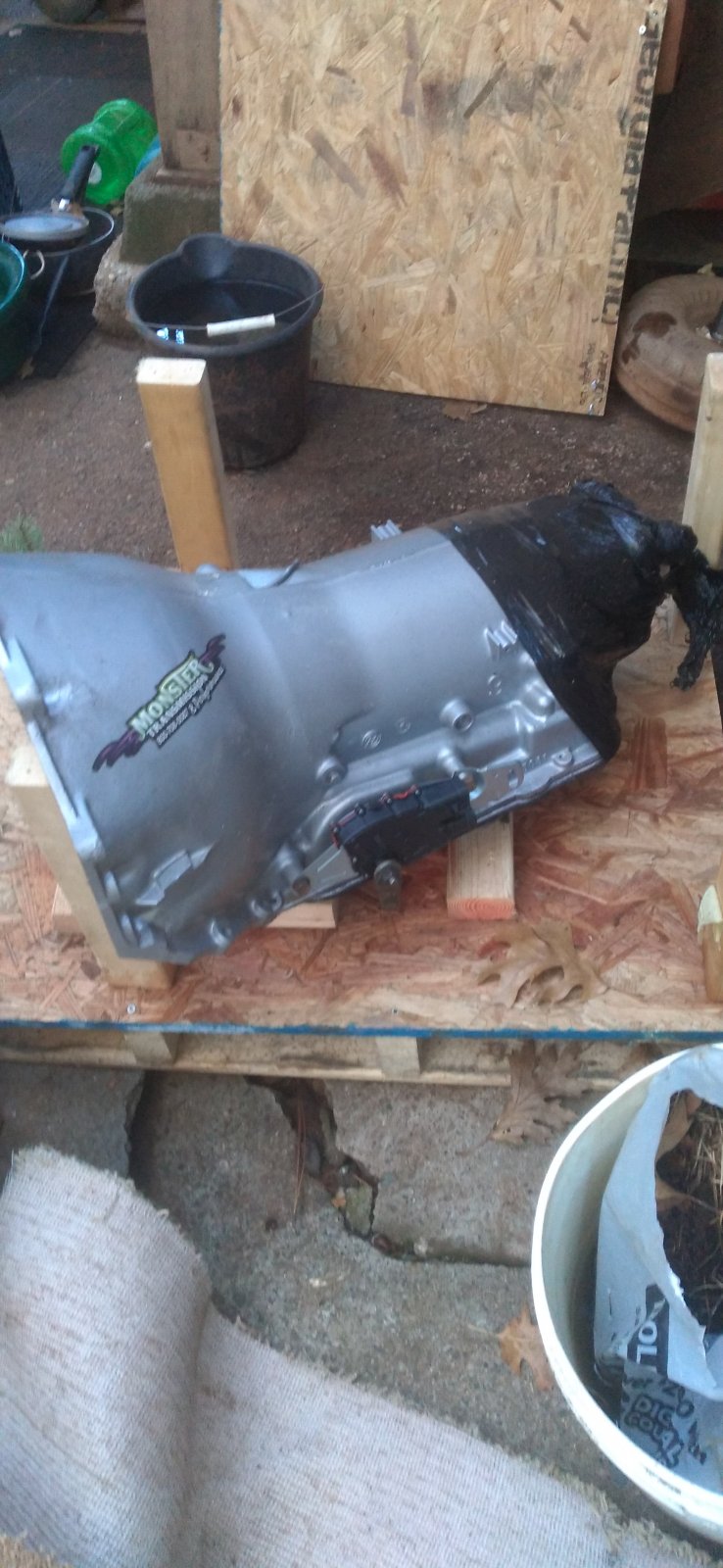

Today is about getting the new gearbox ready go in

Last night the old gearbox finally came out.View attachment 269926
Today is about getting the new gearbox ready go inView attachment 269927

The trans is ready to install. Filled the torque converter with 2qt. atf, installed new gear range indicator/neutral safety switch, verified the harness plug has 13 pins like the old one, fluid fittings in & out are sealed & tight, output flange & shaft match the removed unit. Here is a trick I like to use. Put a wrench against the torque converter do it stays put until you are ready to mate the bell housing to the engine. Use a hole on the t/c cover flange and it doesn't interfere with getting the gearbox in place!
