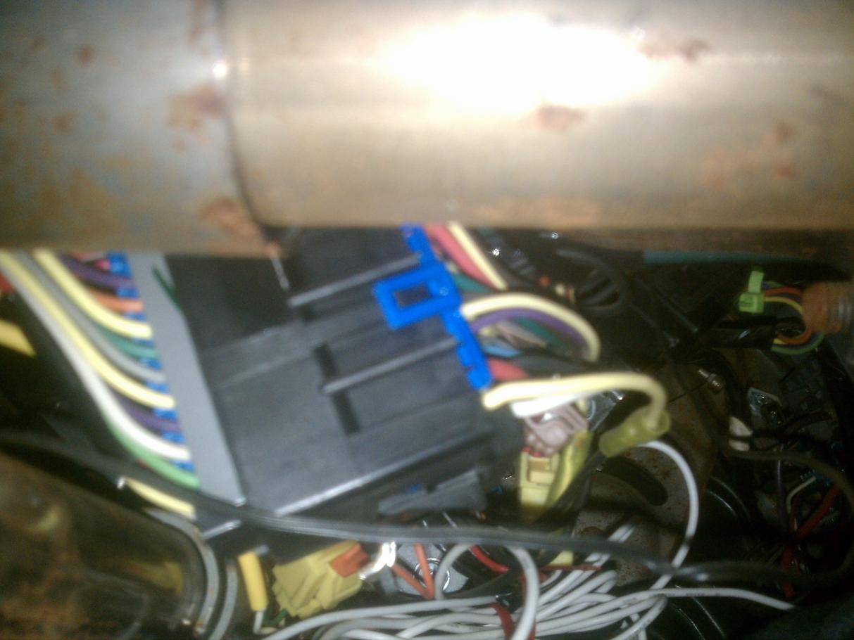

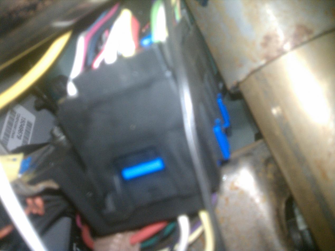

I took some pictures up under there, I think I might have a BCM but not sure. Here they are:

That is the interconnect on the steering column for all the switch assemblies on the column. What is the big bundle of wire tied up in pic #2?
