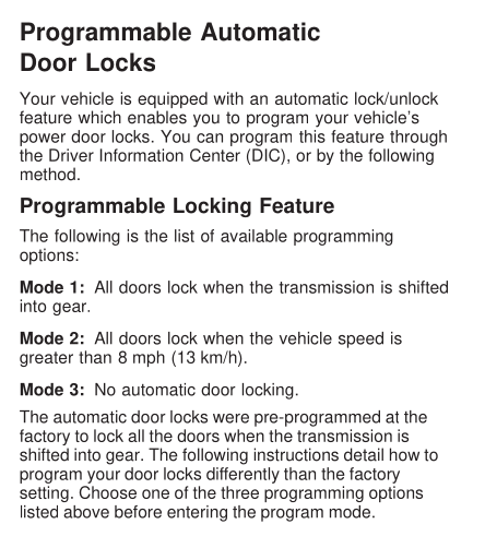

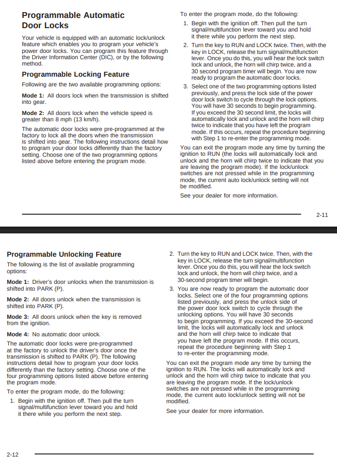

My 2006 denali has all the door lock settings in the settings menu in the DIC within the cluster. I have them set to lock in gear and unlock when the truck goes in park. I know they can also be set not to unlock until the key comes out of the ignition and a few other ways. Yours doesn’t have those settings?

I don't want them to lock by themselves at all. No option for that in '05, but I heard earlier models did have it.
I'm not sure if there was an updated calibration or if ewalts is doing something custom.. But not having to buy a programmer and subscribe to gm sps is probably close in $$$ but more time to get it done. (assuming there is an updated calibration)

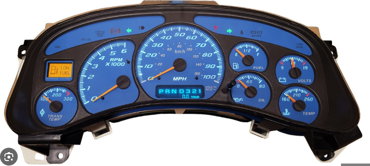

99-02 trucks (00-02 SUVs) don't have that cluster type, so no. Well, at least not my 99 Silverado doesn't have that option, not sure if it was added on the 00-02 SUVs? 99-02 clusters have that message center and the odometer only shows gear selections and mileage:

Possible some early ones have a key/button press schedule to make it work..
But I was under the impression '03 and '04 have a DIC option..
I have this selection in the DIC, too, and have a couple of modes to turn off and on. I'd be surprised if the '05 doesn't have it. Maybe the cluster was changed?

I can set WHEN they lock/unlock, but cannot disable the auto-lock completely.
Same with my '12 tahoe...
(until I purchased Autosync w/BCM programming..)
