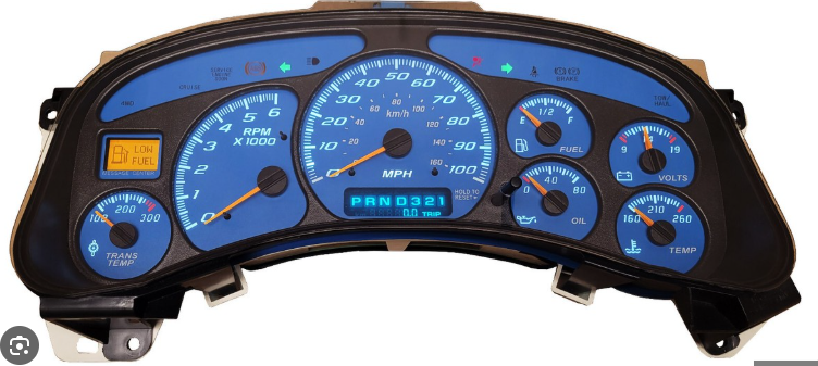

99-02 trucks (00-02 SUVs) don't have that cluster type, so no. Well, at least not my 99 Silverado doesn't have that option, not sure if it was added on the 00-02 SUVs? 99-02 clusters have that message center and the odometer only shows gear selections and mileage:
