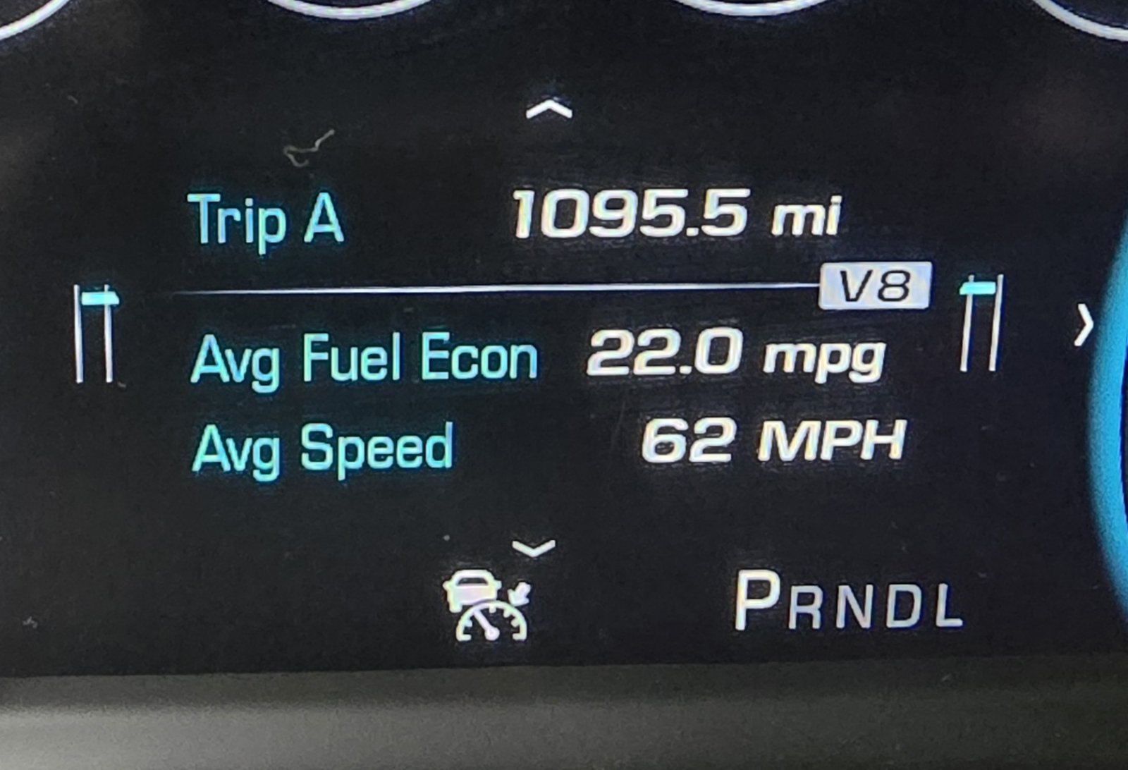

Just got back from a 7 day roadtrip and the big brakes didn't hurt the mpg too bad. Lot of mountain driving so +4,000ft elevation changes, rain, snow & high winds with over 1,000 miles of driving and got 22mpg. Also had a few remote warm up starts, many drive thru stops & 80mph speed limits
