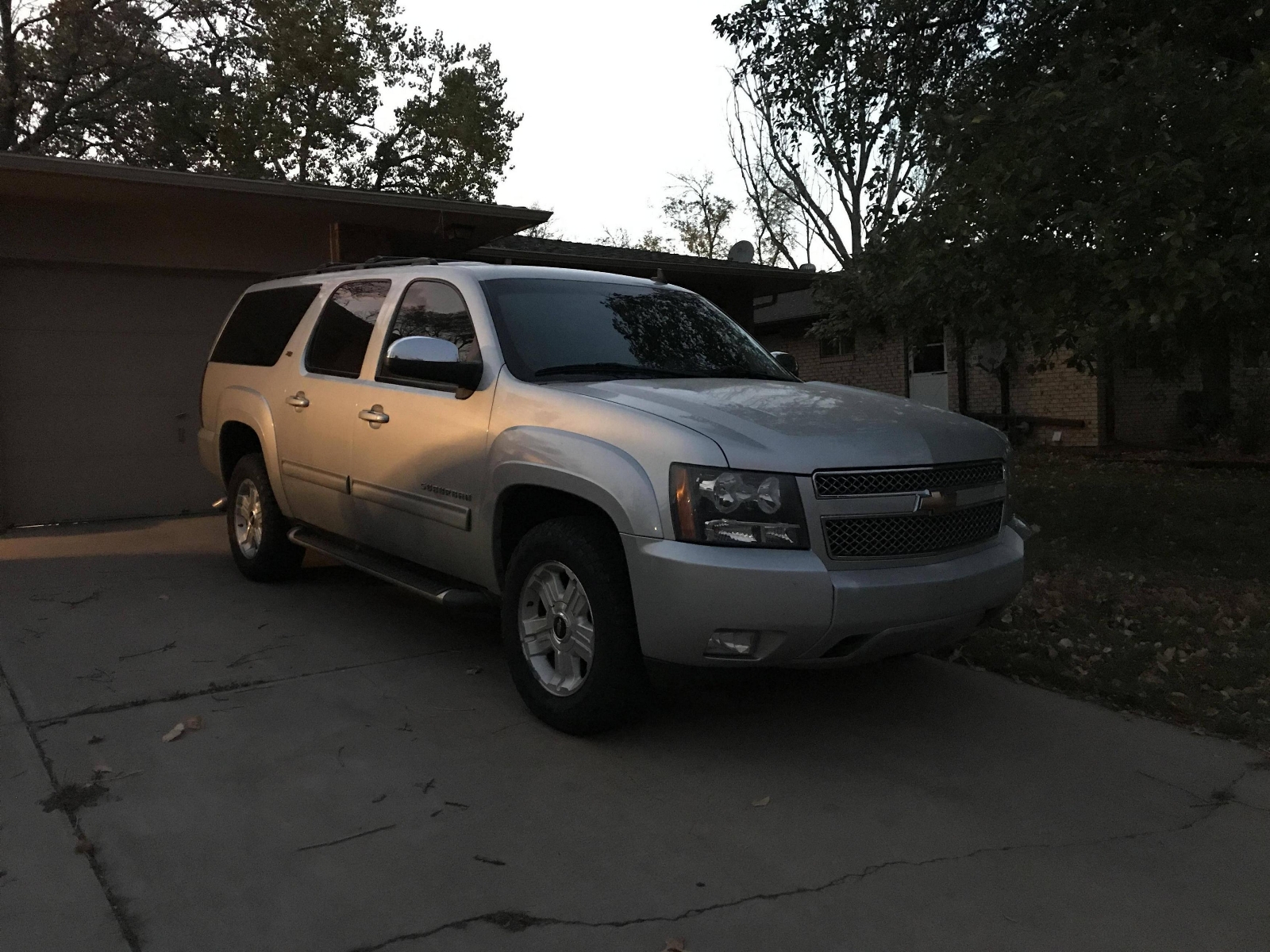

Walked away earlier today with a 1 owner 2011 Z71 4x4 for $11.5k. Tires are a nearly new set of Wranglers. Was a North Carolina car for the first few years, and then spent the rest of the time in CO. CO doesn't use salt so there's very little rust. Engine and transmission were very smooth, and the 4WD worked properly.
Service records were nonexistent so I'm assuming that a lot of maintenance is well overdue.

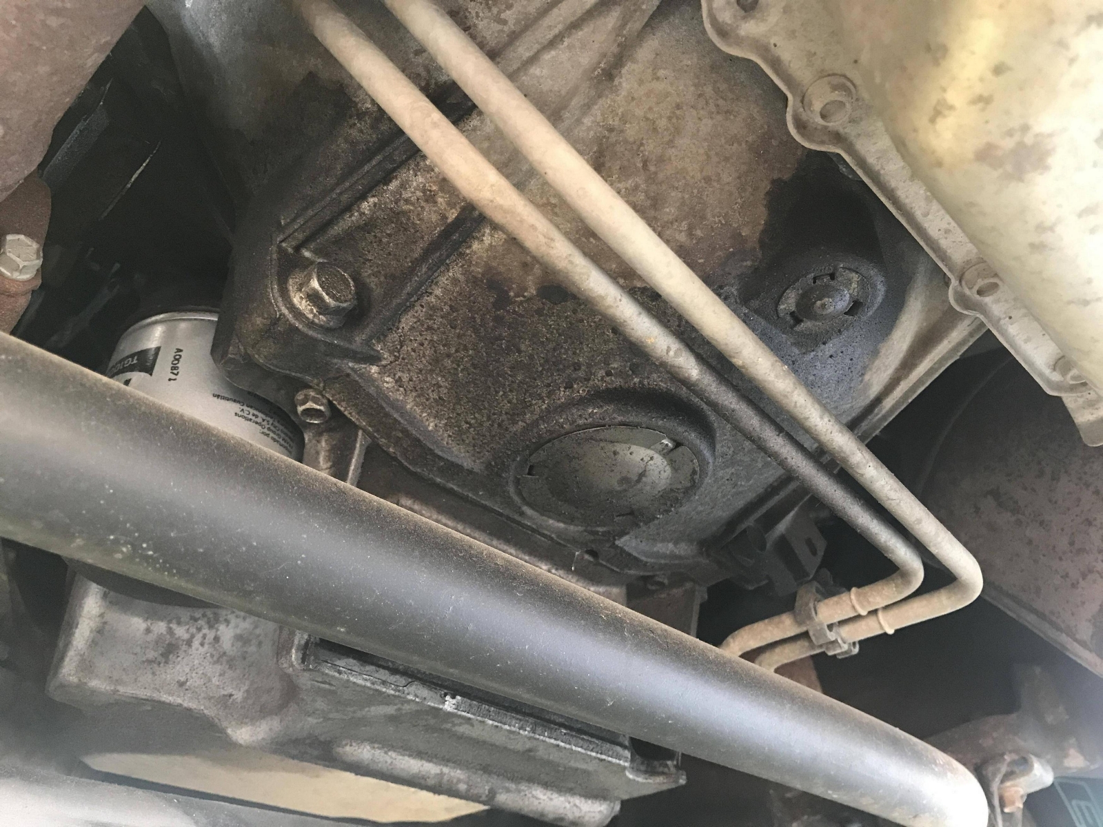

There seems to be a [minor] rear main seal leak. P.O. said it never leaked on the driveway and I believe that. However the frame seems coated with some greasy substance. Most of it did not seem particularly fresh (except pic 2 ). The closest I've seen on personal cars is when a CV boot tore, flung grease everywhere, which then attracted dust.

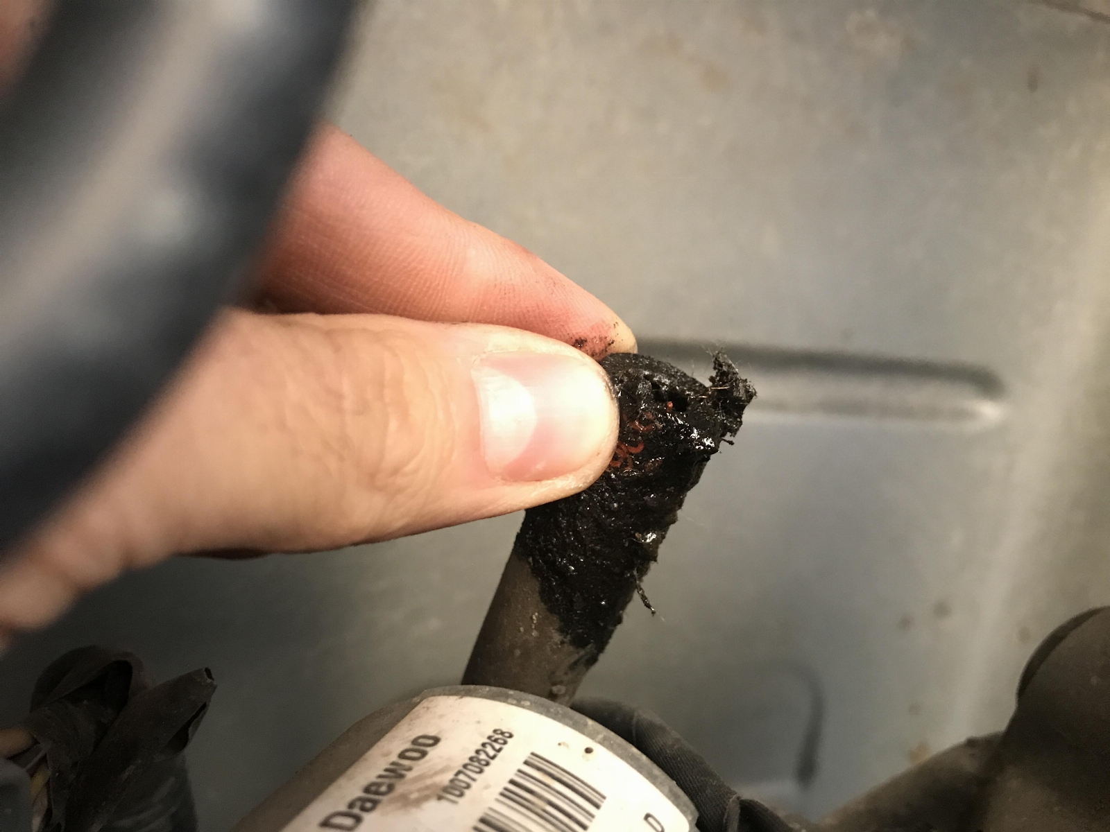

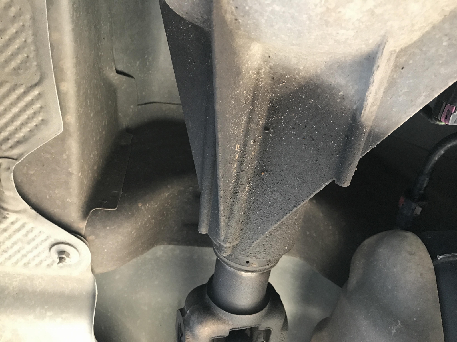

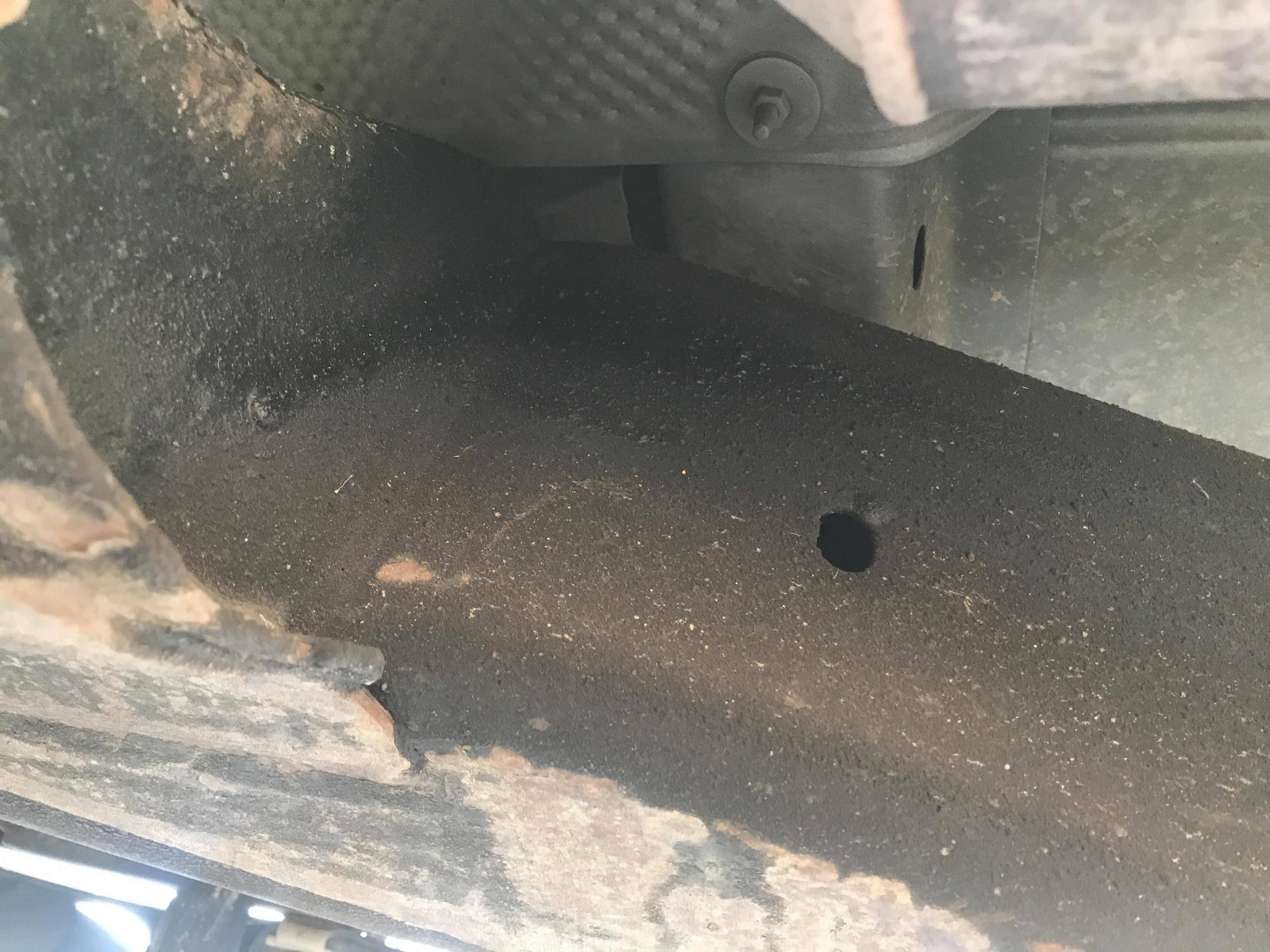

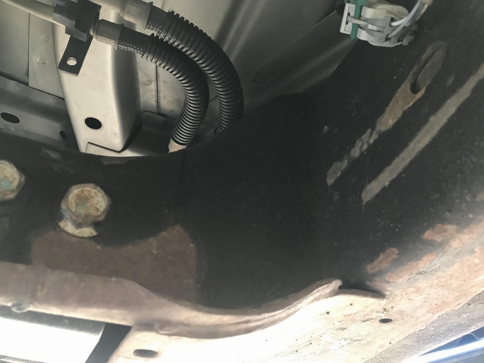

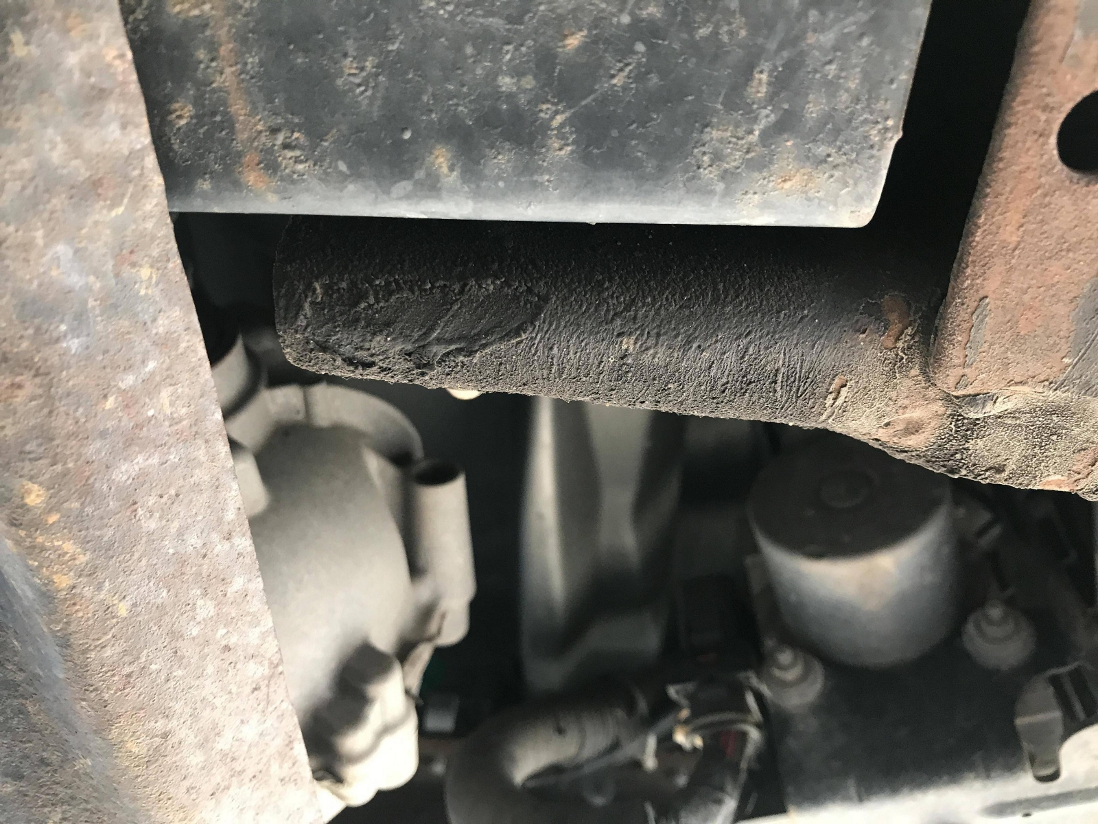

Based on these pics below, is this normal buildup for a near 10yr old truck with 145k miles? And any idea what the tube in pic 2 is?
SCORE Derek! Those bring an easy $5K more where I live. Looks great and perfectly normal. That's probably one of the differential or transfer case vent tubes.
Keep clean fluid in that truck and it will last a long time, change it all, from diff to diff. These trucks are much more capable off-road than folks give them credit for.
Get a Tech-2 so you can work on it properly. BlackBear tune will greatly improve driveability and the operation of the transmission, my favorite part.
Run the transfer case through its paces often to keep it ready when you need it. We see posts all the time of some guy who is stuck in 4LO because he never put it in 4LO before.

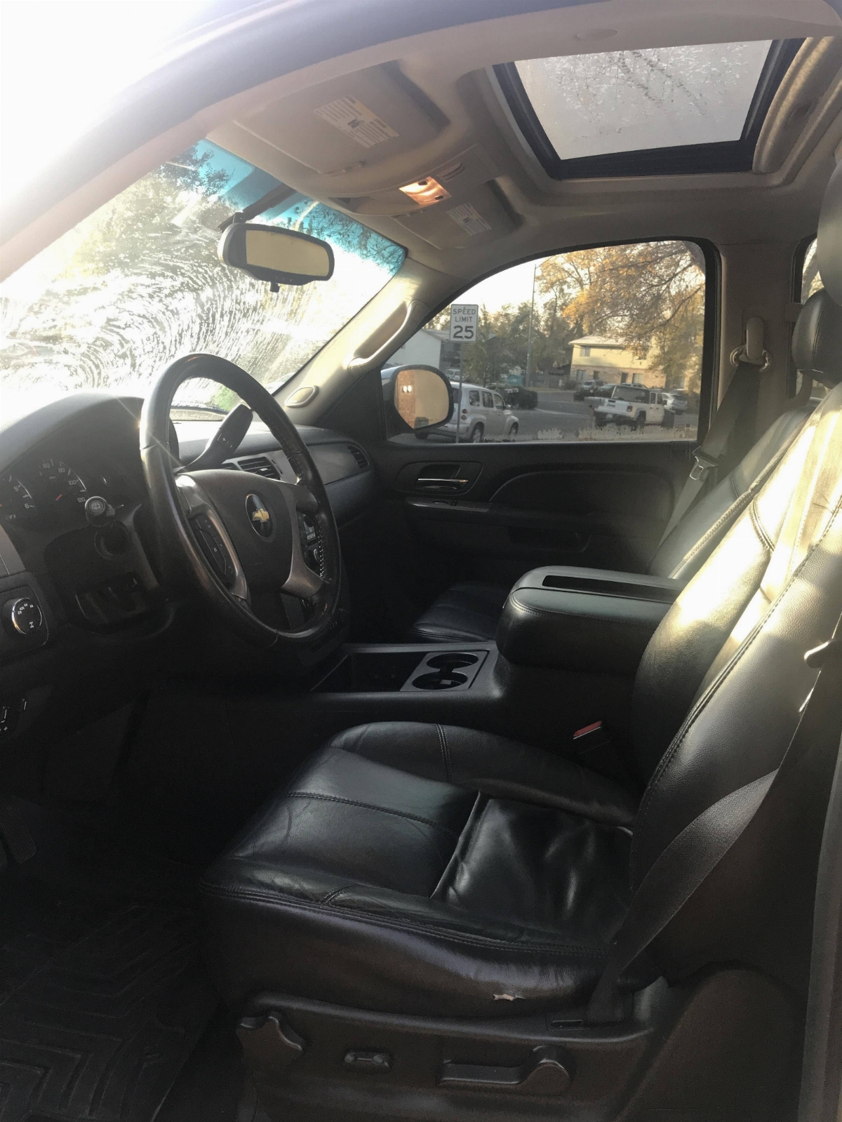

See our posts on fluid part numbers and capacities using the search function. How's the interior? 2-Tone?

The factory coating on the frame is the black stuff you mentioned.
You definitely have a rear main seal leak. Keep an eye on oil level and it will tell you how bad it is.

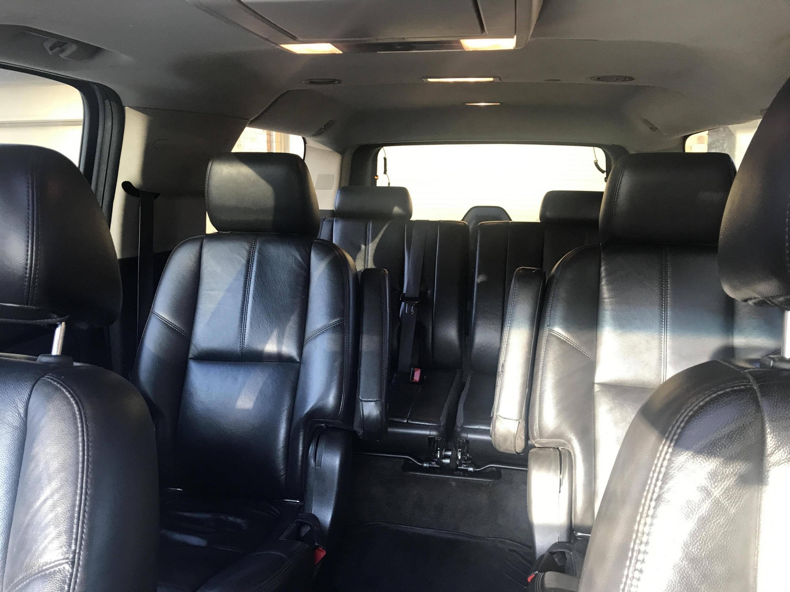

As far as I could tell the seller only listed it on OfferUp, which is not the best platform for selling a vehicle. He said he got a few calls per week but apparently I was the only to show up with cash. And yeah I agree, he underpriced it (or under marketed it). Similar year and mileage were going for $13-16k+ (even without the Z71 pack) and many of those had multiple owners.
Aside from the headliner, the interior is all black (I believe vinyl seats) with 2nd row captains and a full set of Weathertech mats.
Welcome and Congrats.
Good to know about the factory coating. There seemed too much of it to be from a leak but I also haven't encountered undercoating that scrapes off so easily.
The frames are dipped in wax, that is the black stuff. Seats look good and are leather except for the 3rd row if memory serves, tear in the driver's seat is typical. Nice having JL1, the Integrated Trailer Brake Controller!

Congratulations on a beautiful vehicle! Nice score!
Thanks! Haven't driven it much since it just got registered today, but it does look nice in the driveway (which is fortunately clear of oil drips).
1st order of business is getting the fluids swapped out. Diffs and transfer case look like an easy DIY. Power steering looks like an easy DIY as well. I got a dealer quote of $200 to flush the transmission (which I believe includes a filter), so that's a no brainer. Debating on having the dealer flush the coolant as well. However if I change the heater hoses as was suggested, then that's a waste of money.
