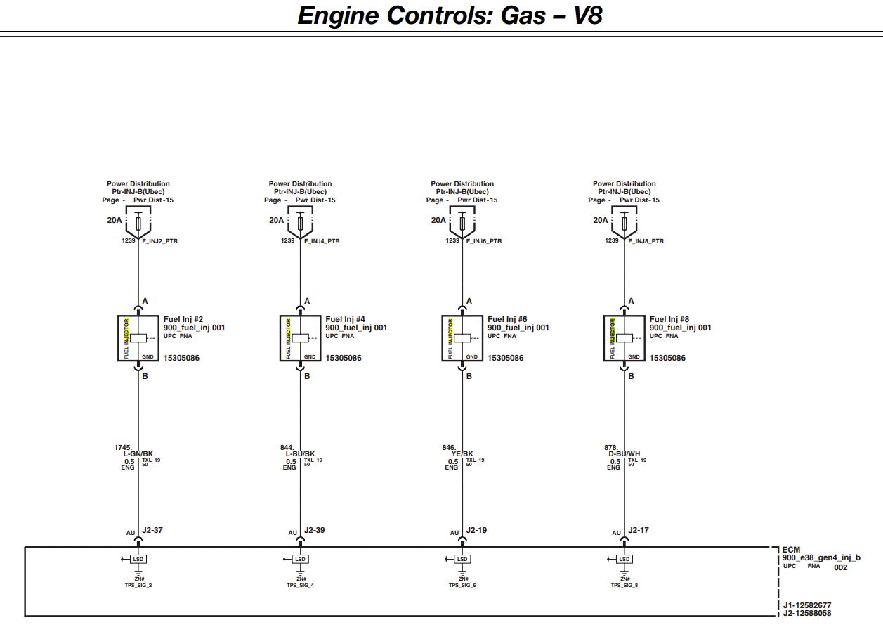

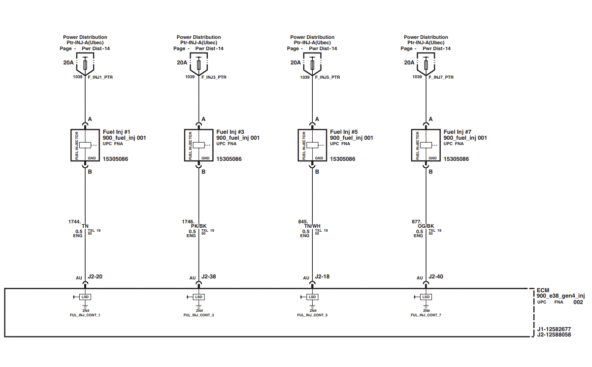

Ok, thank you for the diagram. Do you have the drivers side too by chance? I want to double check to be sure. It’s running like crap
