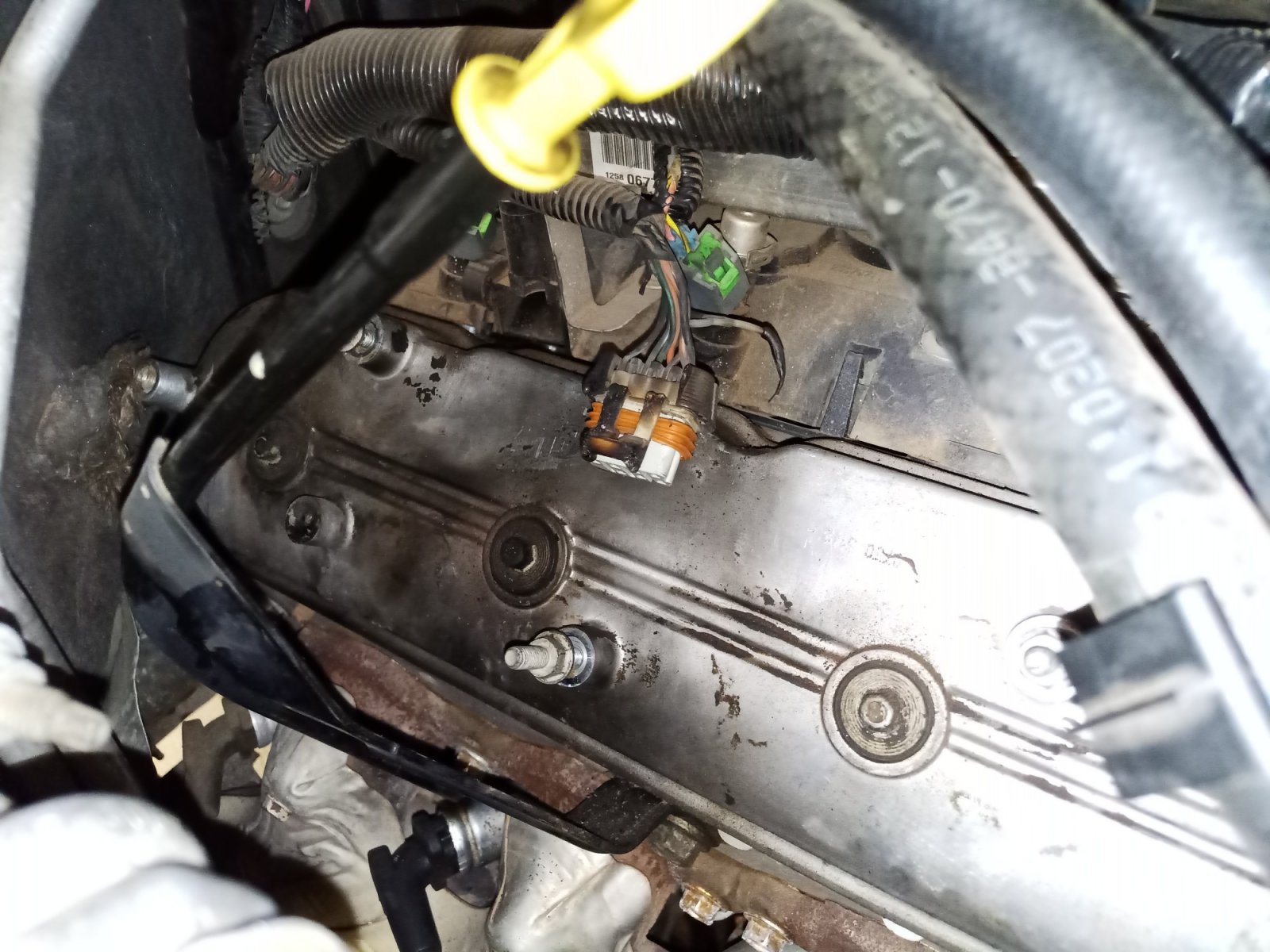

I'm posting from mobile this time so I apologize for any weird spelling and formatting. I got the old coils out. I don't see anything blatantly wrong. I did notice something that looks like tape or something on the coil that burned.. But it looks like it had been there for a very long time and wraps around the whole bracket.
Also the burn marks appear to be from coil to plug based on color.. Still super weird.
