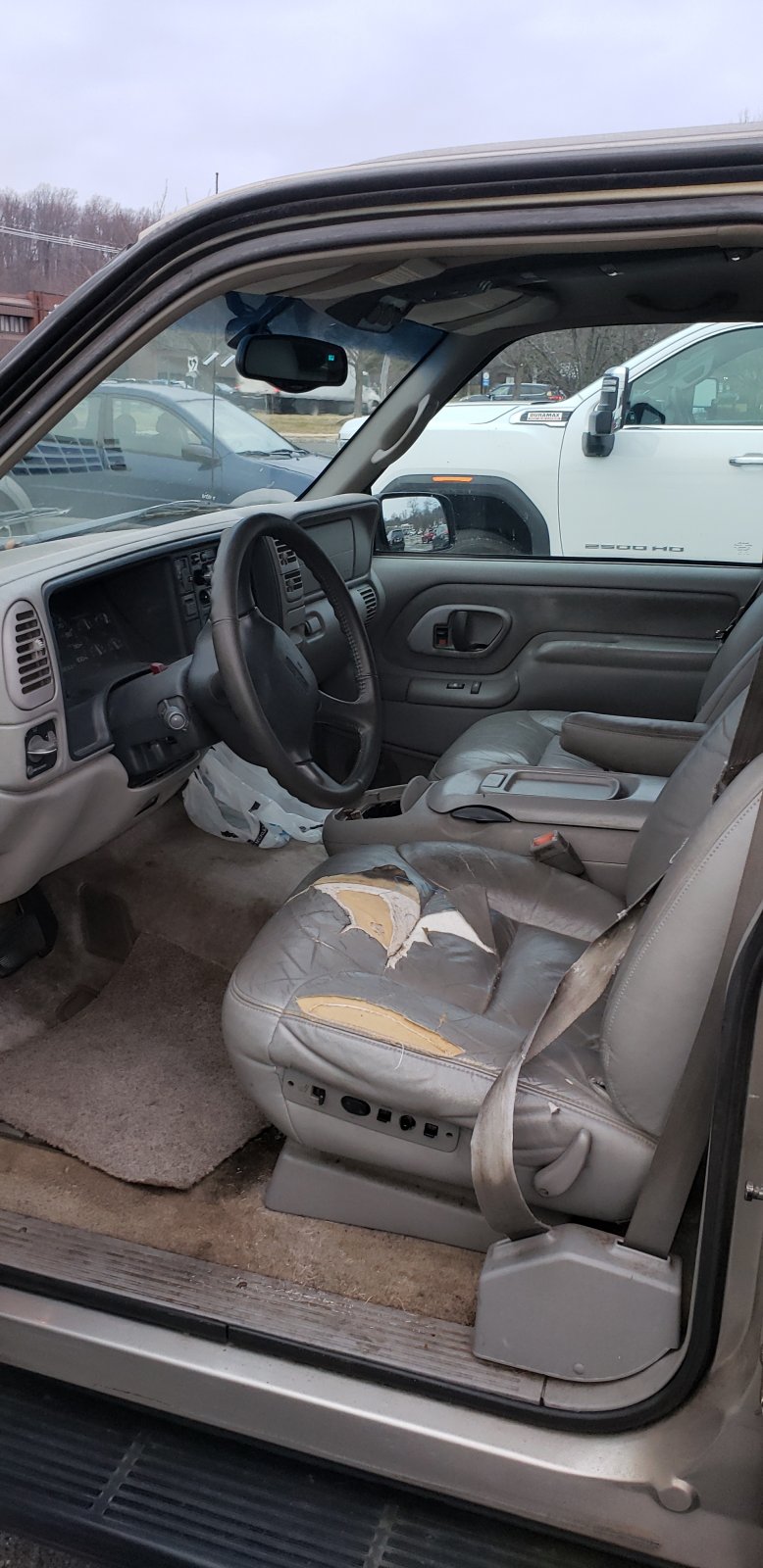

I am going to recover the front seat bottom I see leather covers are available from at least 2 different companies. The heated seat does not work. I think the lower element is bad. Is 12475772 the correct part for the bottom element? I know its disconnected. Is there an aftermarket option?

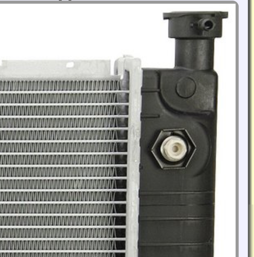

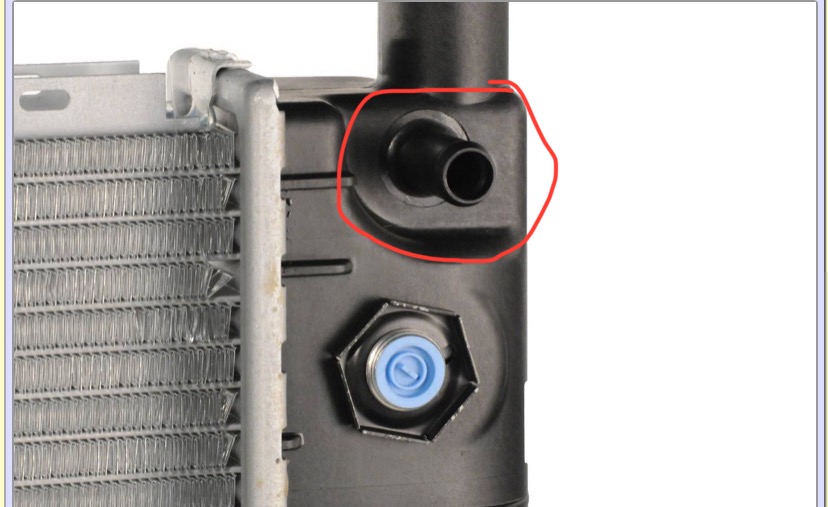

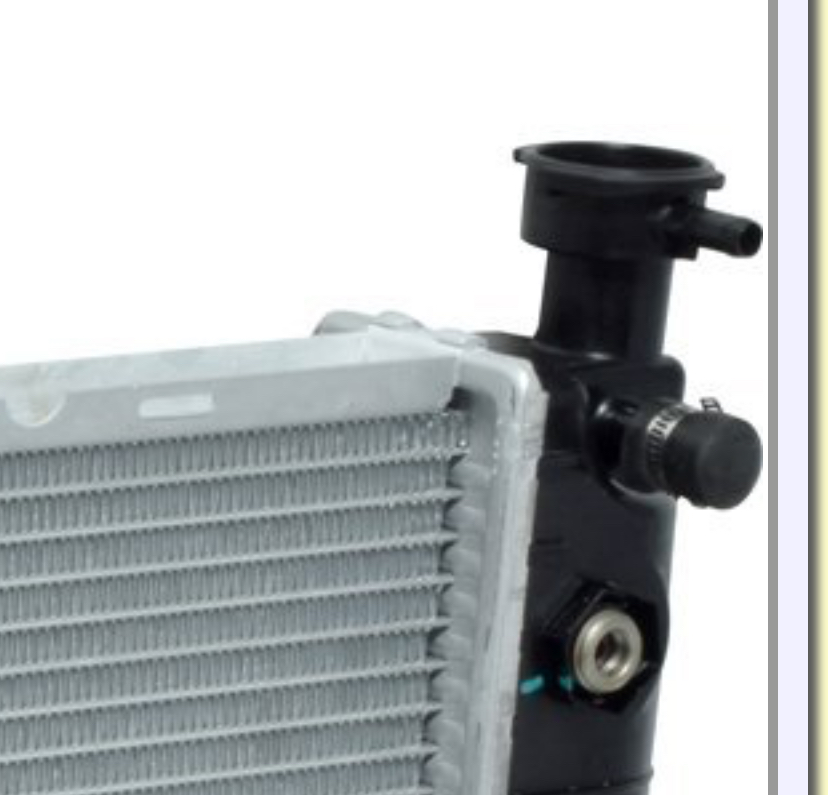

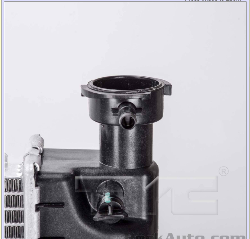

Heads up on radiators. Some aftermarket radiators include an unused port under the cap that GM did not use on 96-99 trucks:
I think the port was used on some of the earlier (88-94?) trucks. As the radiator is meant to be “universal” and fit those trucks, many companies put a rubber cap and hose clamp over it. Often, these are low quality vacuum style caps that degrade in a few months and leak or fall apart.
Here’s one:
While you can replace the caps with a silicone cap that is more resistant to heat, the better option is to find one that either doesn’t have the port at all (GM still sells them)…
…or has a threaded plug instead
