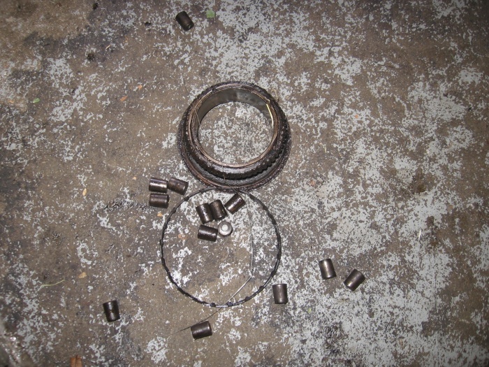

Wow this happen to me years ago while driving an Army Hwmvvv. I stopped at a stoplight, then when the light turned green the truck wouldn't move. I put it in reverse and it just made a grinding noise. I was like WTF. I called my unit and told them to send the wrecker, when it came it lifted the truck from the rear end to tow it, and the rear right just fell off. That really freaked me out

yea i just replaced both of mine, on my driver side i was getting a bad grinding noise and it would even jerk the truck it got so bad so i immediately pulled it off and the back cover had fell off the hub so thats what made all the bearings dry up, it was a easy fix but im surprised my wheel didnt fall of either

I changed one at 175k, the other side wsa changed around 85k so that one will be swapped out this spring to prevent mine from separating again. I had a crunching sound when ever I would pull into a driveway and a clunk when I would step on the gas from a standstill. Coincidentally my 4wd switch would also flash even after getting replaced and didnt stop until I fixed my hub. Mine fell apart the moment the hub nut was released too.

The wheel bearing is a one piece unit. You take the old one out and you put the new one in. There are no user serviceable parts. If you beat it with a hammer or you run it till it falls apart, it will fall apart. But again, that is only if you are too stupid and ignore the warning signs. It isn't like as if you could be driving down the road and the wheel would just fall off or something.

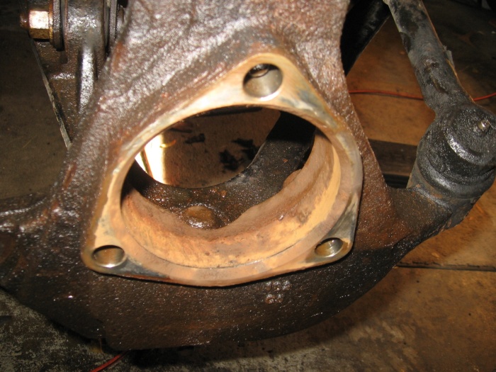

When I replace the wheel bearing, I put a coating of RVT on the back side of the bearing all around the flange on the front side of the stub axle and I put a coating of RVT in the bore of the spindle. I believe that it keeps the spindle from rusting and lets the bearing come out easier when it goes bad the next time.
Because I worked in a machine shop and I understand how bearings works, and because anything that puts unequal pressure on the bearings - including the rust in the bore of the spindle. I believe that they just knock themselves out because as the bore rusts it gets smaller and the bearings have more pressure put against it. The cones and rollers wears themselves out as particles of chrome falls of them - due to a lack of lubrication, caused by the deterioration of the seal on the back side of the bearings.
