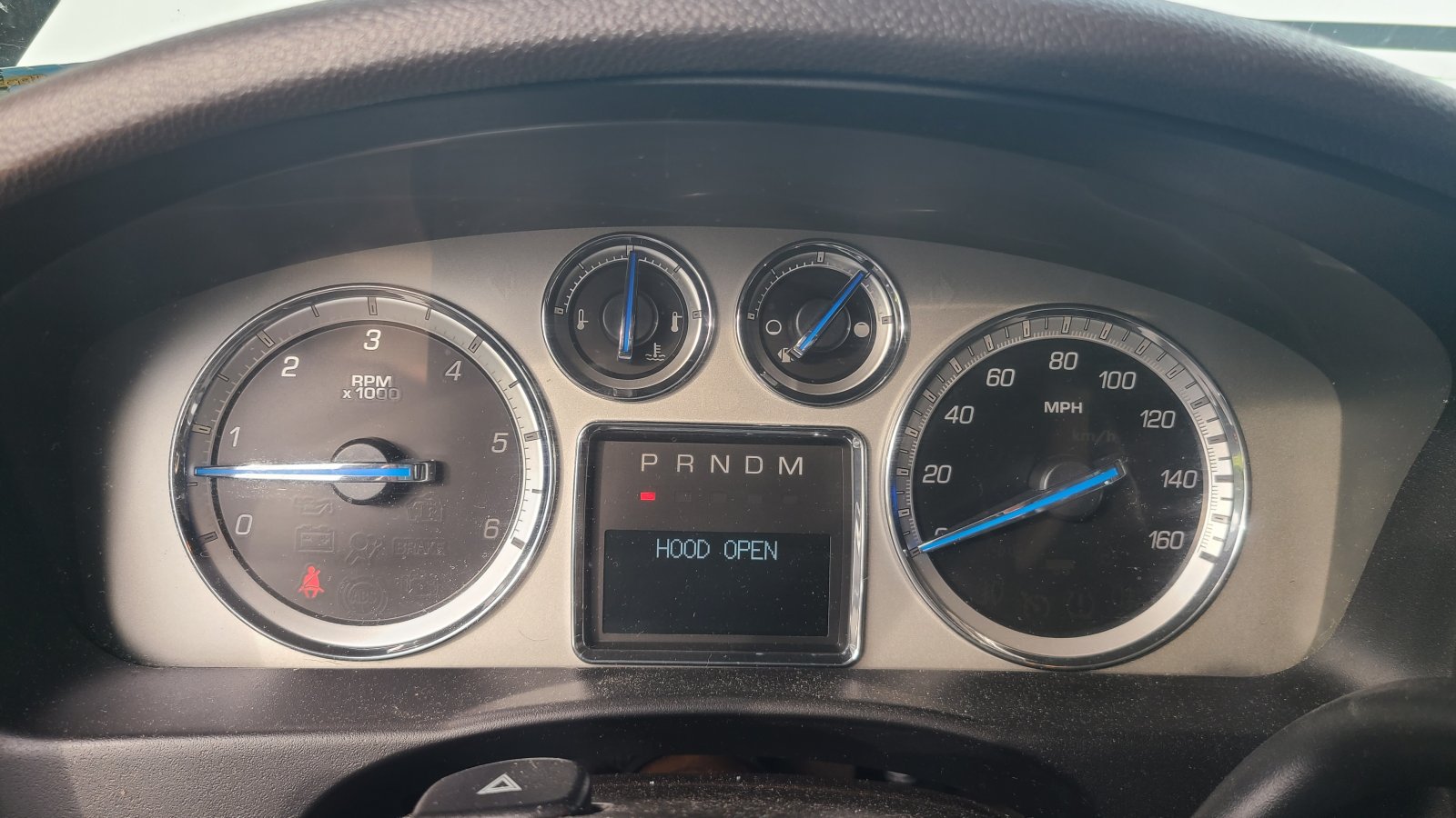

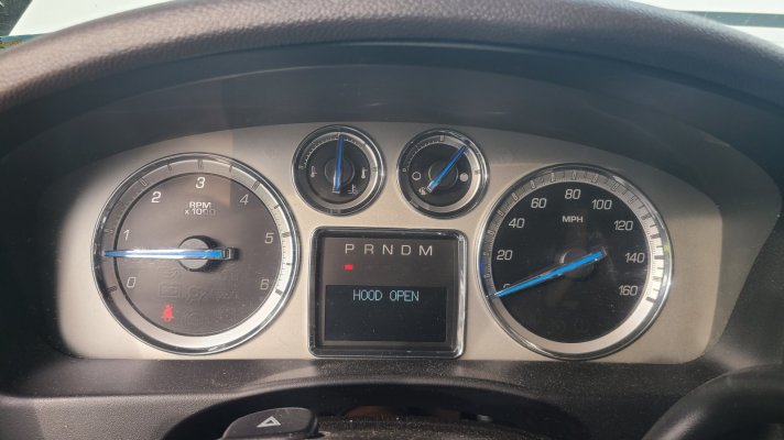

How do the temperature hands normally behave on these? I'm pretty sure I can see the thermostat open and close, and if I drive it for my 45 min commute, I have a few times witnessed the temp hand rise one of the little notches, sometimes as much as two little nothces past the middle, but only for a moment, never staying there long. I've topped off the coolant a few times, and it spits out any excess... It's the sort of thing my eyes have been burning up with attention, so it's not like I'm ignoring it, and it only does it on a very rare occasion. Could this have been related to the ECM not working right due to the AFM? Or is this a normal behavior, or a sign of something else? I let it idle for a long time in the driveway and took this picture.
Also, the Temp Hand is higher when the engine is off (after getting up to running temp, not cold, of course) but then comes back down to normal after a few seconds of being started back up.

Regarding the coolant/ temp question:
Obviously there could be head gasket issues or what not, but I came across a conversation online where people had a problem with the temp hand in their trucks going up a little while on inclines for a while, and it is worth noting that my 2011 Escalde is...well...squatted at the moment. Yes, it has the embarassing "squat" going on, which I will probably take off, but for the time being I wanted to sort out the engine problems first.
Reading about inclines made me wonder if its a little pocket of air trapped in there that won't come out easily because of the...well...because of the squat. lol. It sounds so ridiculous I'm ashamed to even post this thought online.

Temperature creeping up a little right after turning off.... Actually that's normal.

Alright, so I drove the truck quite a lot today, and it seems to behave pretty well with the AFM disabled plugged in.
We popped a new thermostat in it, and I drove it over an hour and not a single blip happened on the needle (plus the rubber gasket on the old thermostat didn't look great).
