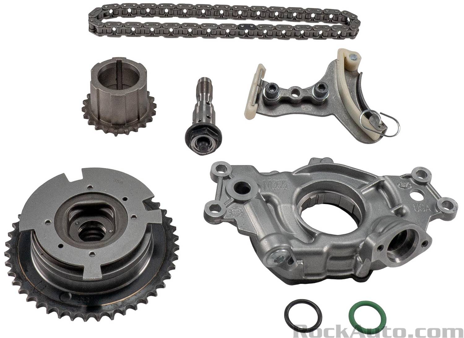

VVT is held on by one bolt, which is the actuator, in the center of the gear. A non-VVT camshaft is held on by three bolts to the camshaft gear.

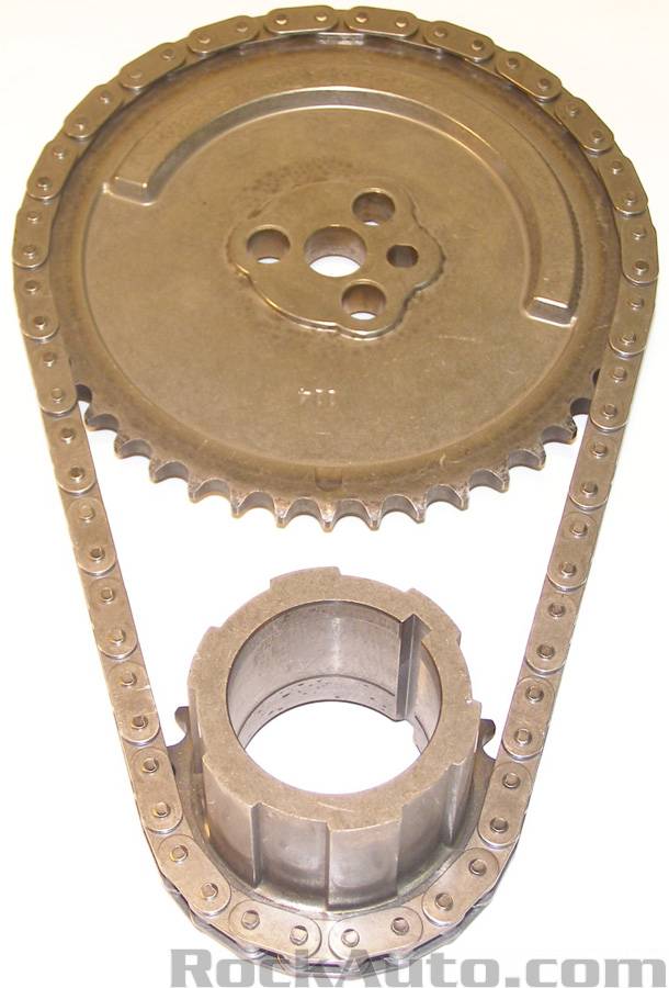

Here is a non-VVT gear in a Cloye's timing chain set. (The larger gear. Smaller one is the crankshaft gear.)
A VVT gear is unmistakable with its single bolt in the middle

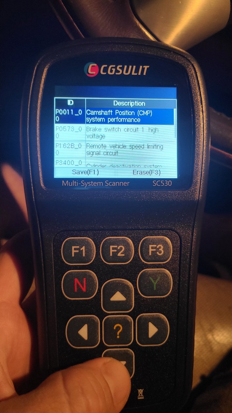

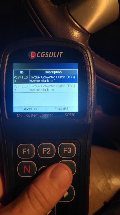

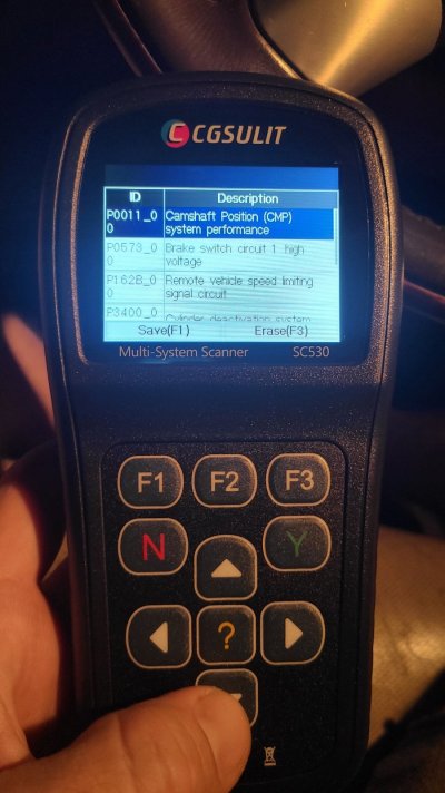

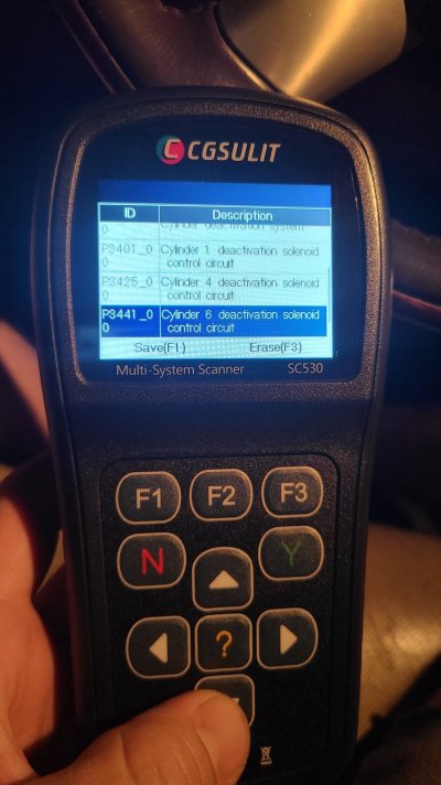

Also, the scanner came in and found a few codes that didn't show up at all on my other OBDII reader. I more or less expected the cylinder deactivation circuits, but was surprised to see the torque converter lockup codes. It presented the P0011 code as anticipated.
Is there something else I should be learning from this scan tool? I look forward to opening the engine and seeing the condition of the timing chain and everything.

Well that sure looks like they did not deactivate the AFM system in the ECM. That alone is going to cause all sorts of drivability issues.

I'm pondering your codes. Assuming you purchased this at a dealer?
It's quite possible the AFM delete was completed and the prior owner had a disabler plugged into the OBD2 port. Would not be unusual for someone at the dealer not knowing why it's there, and unplugging it..... Which reactivates the AFM in your computer. This would give you all sorts of drivability issues as well as codes.

I had to go back and reread your original post. Realized you did mention it has a smooth valley cover.
There's no question it needs the AFM turned off in the ECM, and most likely whoever traded it in either removed the disabler from the OBD2 port, or the selling dealer did. (Or somebody else car shopping)
It should run just fine with oil pressure at a hot idle on the low 20s, but I definitely would want to pull the pan and verify the pressure relief valve is plugged, and I would pull the front cover to put a visual on everything, making sure it has a new oil pump.... And a correct one.
Realistically you can't count on the trouble codes as being definitive to anything, until the AFM is actually disabled. Never tried to run one without disabling it after an AFM delete, but what you described sure sounds like what one would expect. Including the driveability issues at light throttle below 2000 RPM when the ECM would be attempting to engage the AFM.
