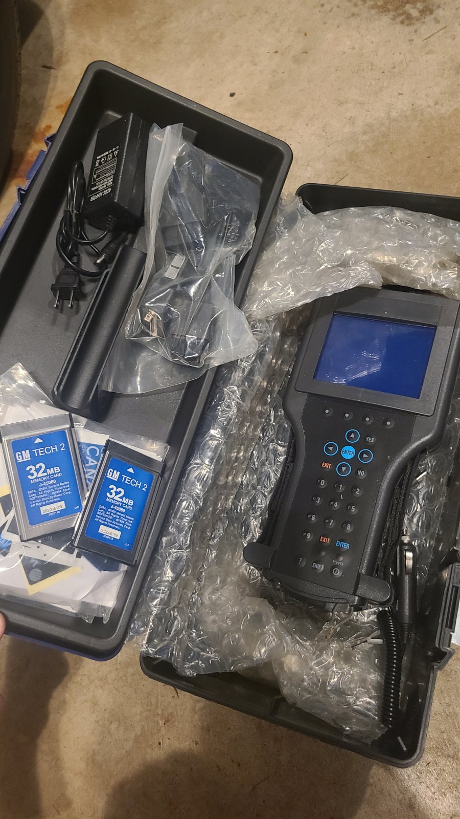

ok, so I had a bit of an unexpected development this evening...
I called my brother and told him what all was happening, and he informed that he had left a GM Tech II at my house a few years ago from when we used to race his c5 at the track.
I'm a neat freak, but had no idea this thing was literally under my bed! What a crazy thing!
Anyways, is there anything more I can do with this to communicate with the ECM about the AFM?

Unfortunately, you can't use it to disable AFM.
However, it's as good as you can get for dealer level live data monitoring, scanning for codes, programming modules, etc. It will do the crank relearn faster than the aftermarket by directional scanners. And a whole lot more. Lol, move it out from under the bed and give it a place of respect :)

And in all cases, a Tech 2 is so useful for factory level diagnostics.
