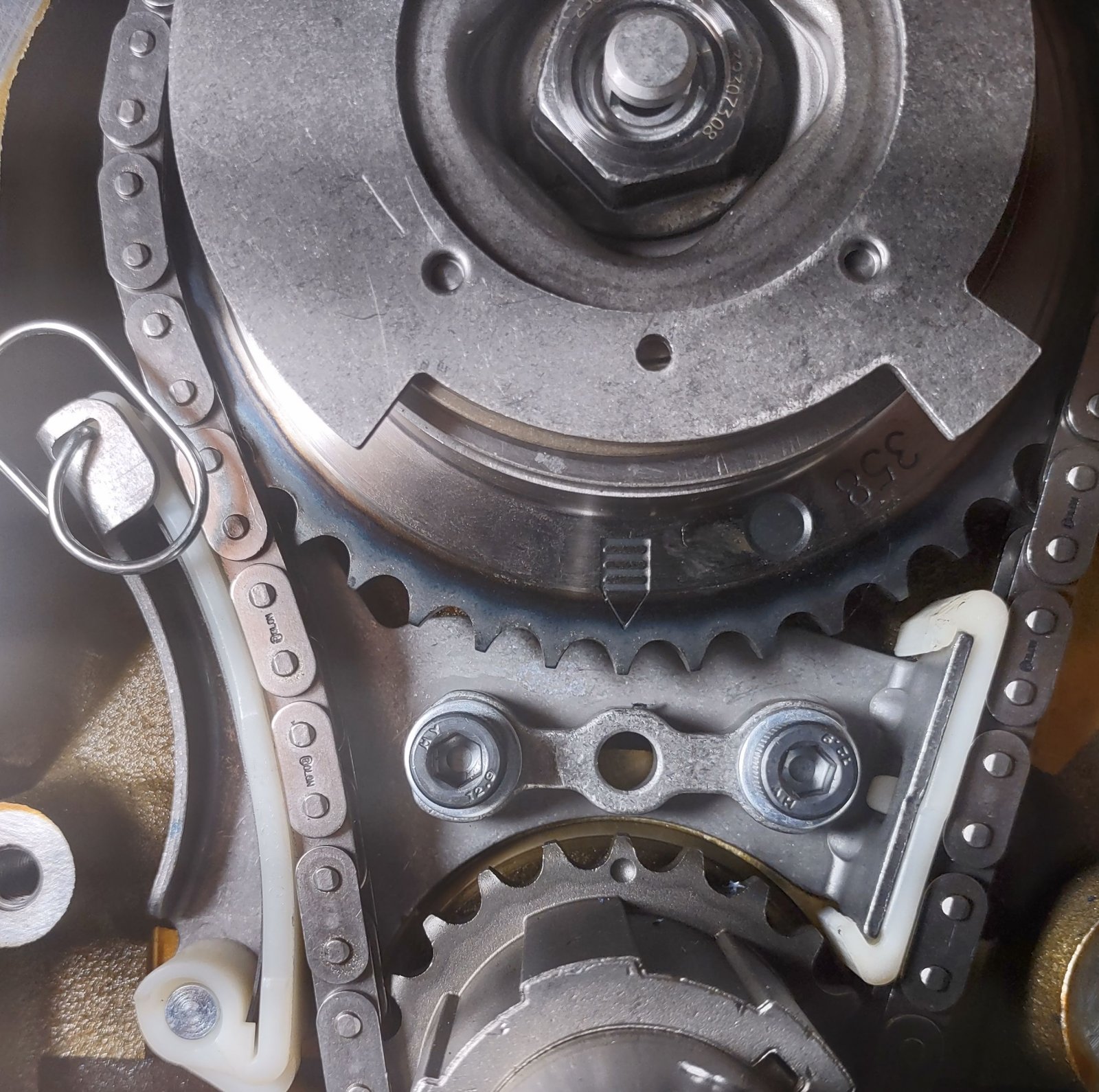

Hopefully.... Your oil pump is new, clean, and your timing components look like this after removing the oil pump. Minus that tensioner pin on the left that's still installed of course.
rdezs
Nov 6, 2023
1,385
2,578
A couple more notes.
1. I like to soak a new timing chain overnight in oil. Then I towel dry it with a lint-free cloth. Right before putting the front cover on, I put some assembly lube on the chain while turning the engine over by hand slowly.
Permatex Engine Assembly Lube https://a.co/d/8W8GwB4https://a.co/d/8W8GwB4
2. Prime the oil pump after everything's together. If you're in front of the engine staring at the harmonic balancer, on the right side of the engine, towards the front, just behind the power steering pump you'll find an allen head plug. You can use a syringe and put several ounces of oil in there and then reinstall the plug. I personally use an adapter with a 1/8 hose barb on it and a dedicated weed sprayer full of oil.... Allows me to pump a few quarts in, filling the oil filter and beyond, until I'm oil coming up the push rods. In your case unnecessary, unless you end up pulling the heads and replacing lifters.

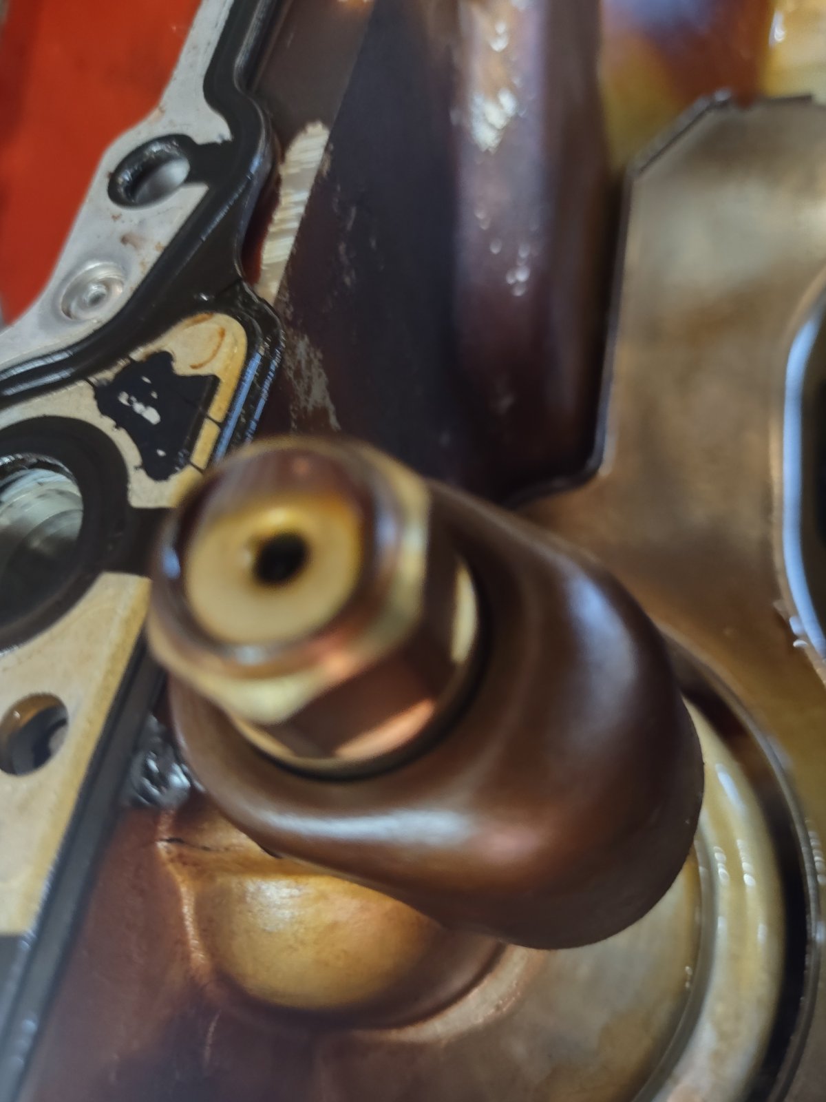

I'm curious if he plugged the oil pressure relief port in the oil pan. Lol, feel like pulling the oil pan also?

But I'm not sure I know what the oil pressure relief port looks like? Is it what's below the oil pump?
rdezs
Nov 6, 2023
1,385
2,578
You can't miss it. It's threaded into the oil pan, and acts as a oil pressure relief valve to protect the AFM solenoids. Should be removed and plugged when AFM is deleted. Overtime the valves get weak and bleed off too much oil pressure. I'll see if I could find you a picture of one
rdezs
Nov 6, 2023
1,385
2,578
Here you go. There's a few people online, even on Amazon that sell the perfect length stainless steel bolt with a copper washer to replace it. That curved hood you see was added on later by GM to keep the oil spray from spraying up in the cylinders, causing oil consumption issues.

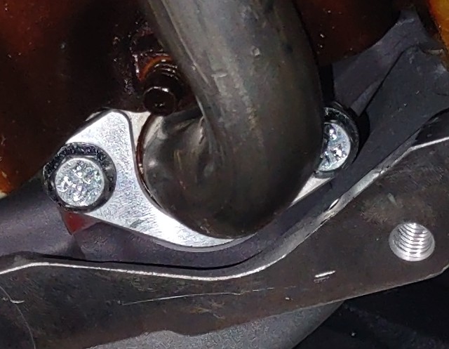

If you drop the pan you'll know that the OEM oil pan gasket is held in place with two rivets. The rivets are very soft, just take a small drill and they will come out. Recommend the felpro oil pan gasket.
If you do drop the pan, it makes removing the pickup tube from the oil pump much easier, and installing a new o-ring.

I guess this is a good time to mention the oil pickup tube girdle, allows you to use both the bolt holes in the oil pump to secure the pickup tube. Factory only uses one of them. Probably saved seven cents per vehicle.
